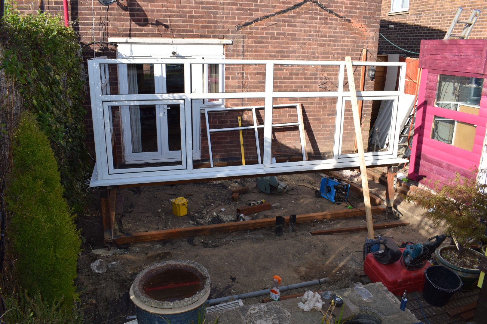

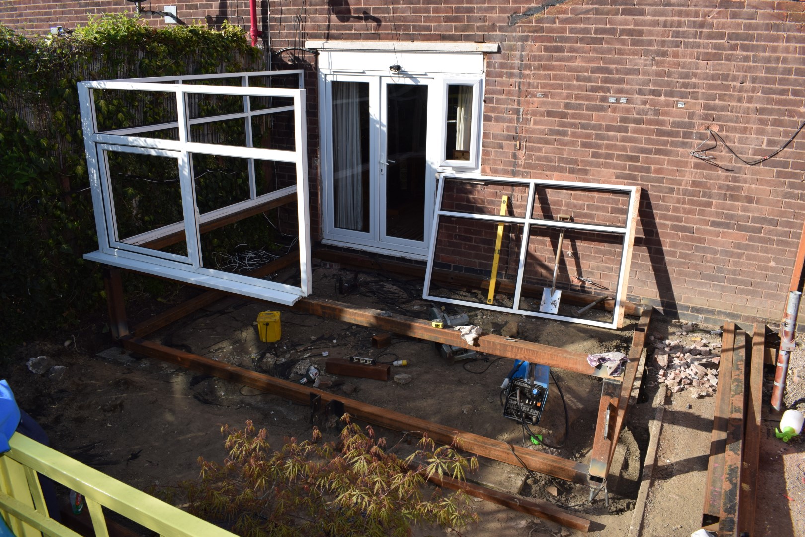

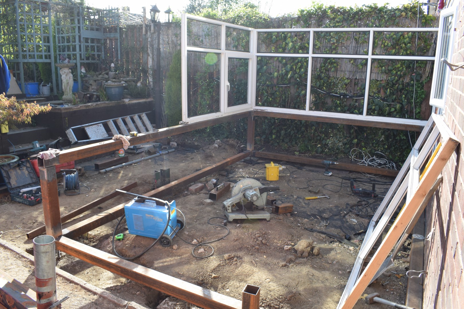

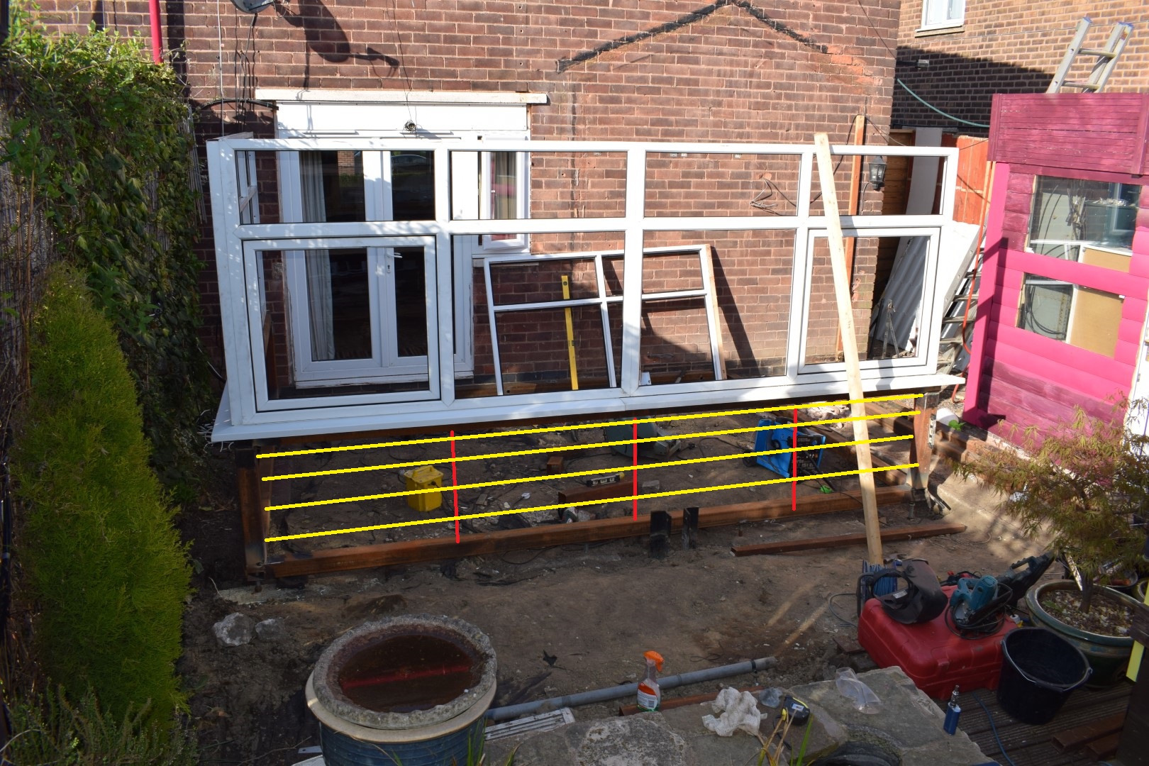

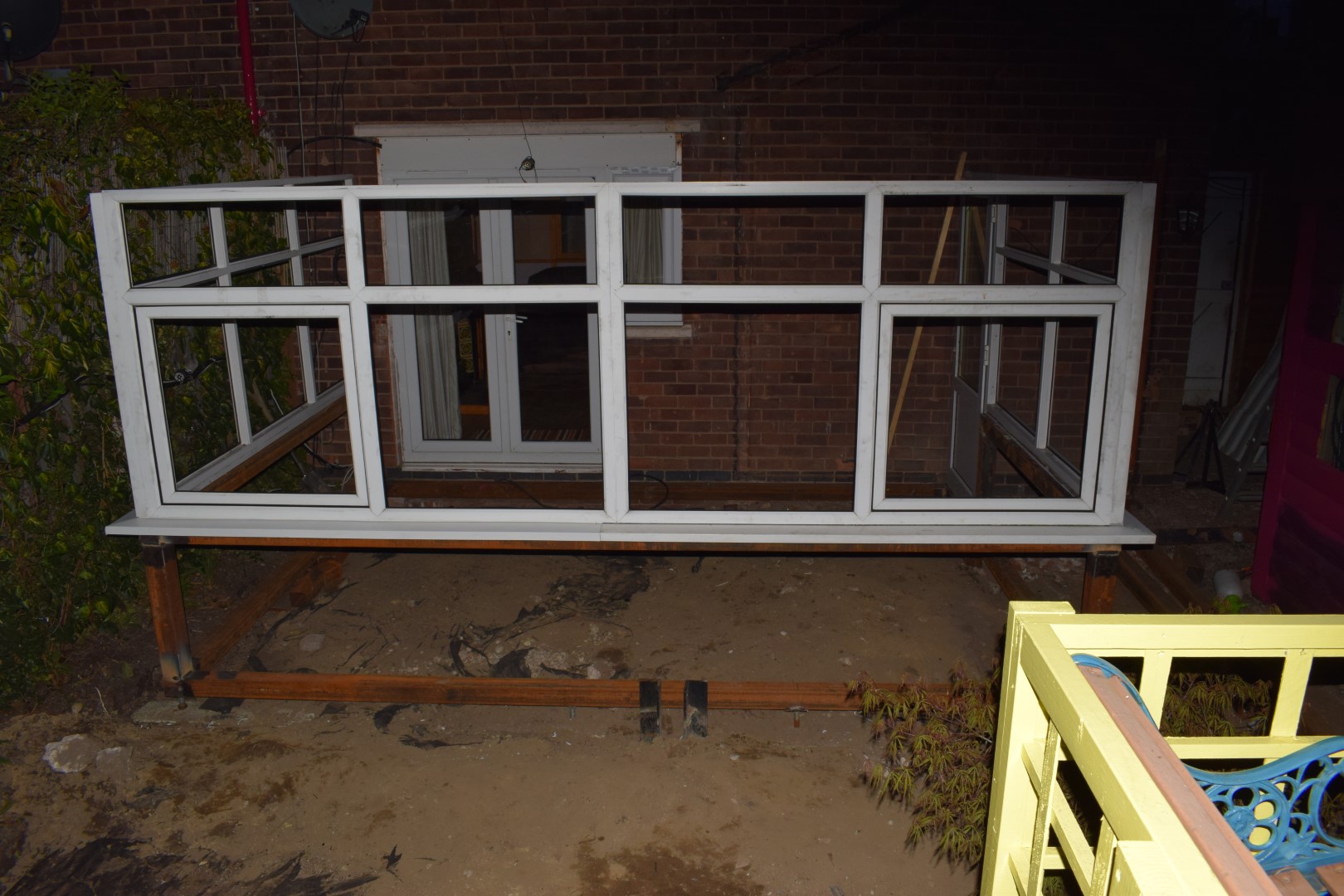

What material/sizes/spacings for your joists? Looks like they are using steel for theirs.

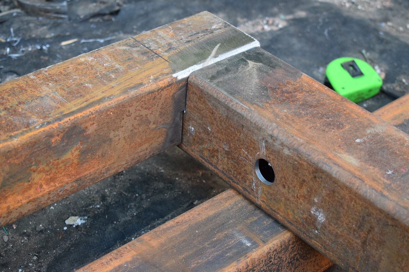

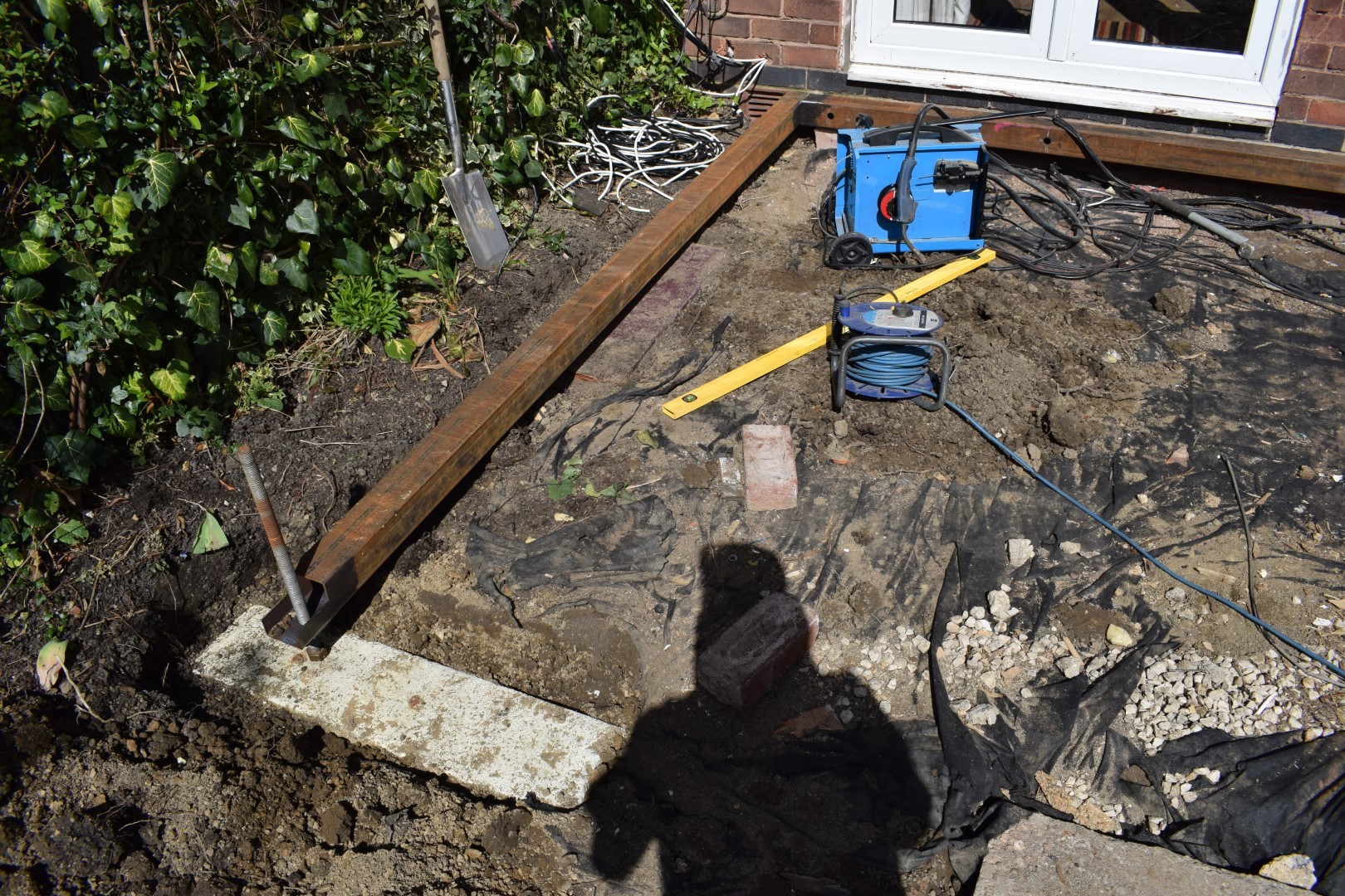

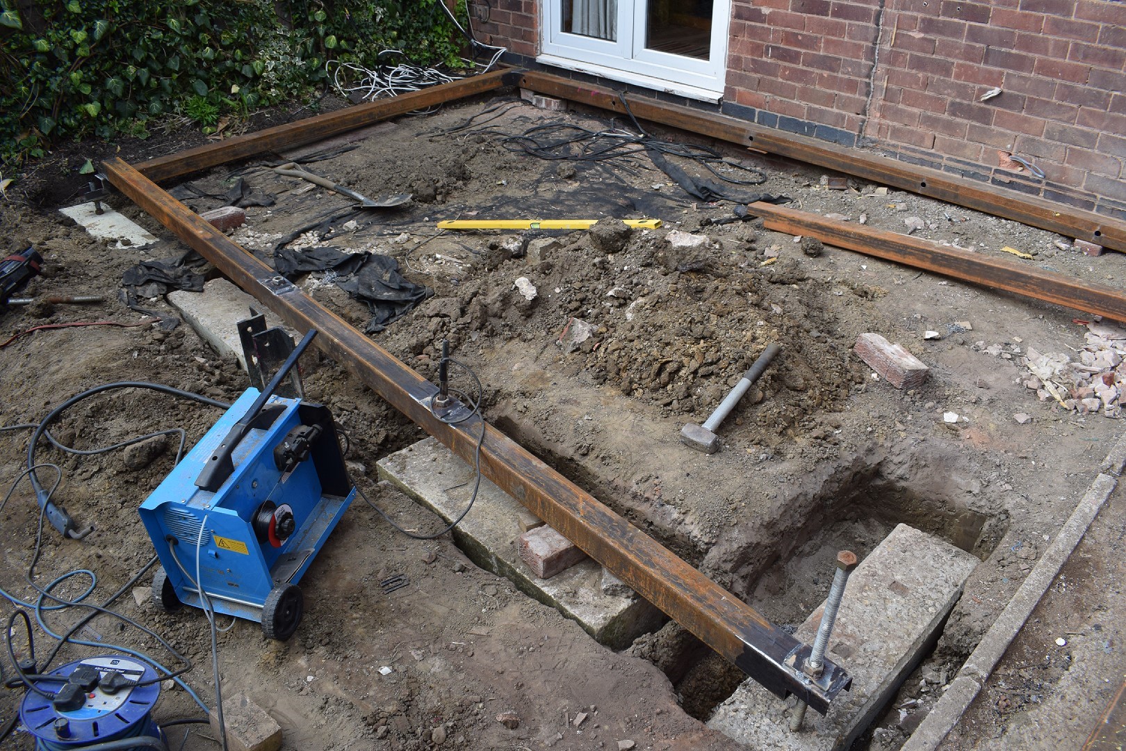

Hi would this be suitable for protecting welds from rust please https://www.screwfix.com/p/no-nonsense-red-oxide-metal-primer-undercoat-750ml/947fg
It's not as good as it used to be, it's quite thin now compared to how it used to be, I've used it with good results but not for anything critical. I'd go for something that hardens a bit more, something like a tractol primer or depending on budget something like a Jotun epoxy primer, probably a bit overkill really but won't do any harm.

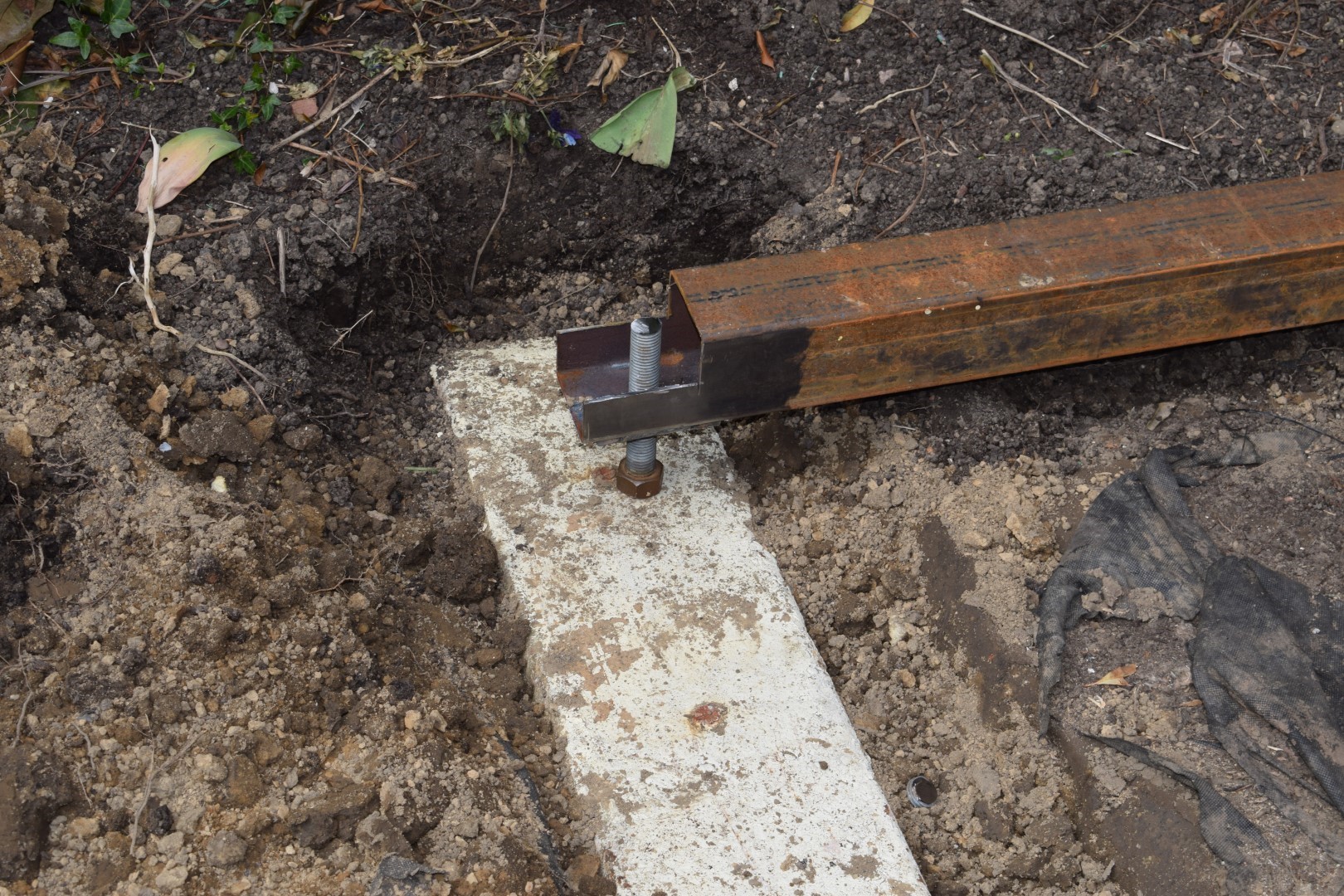

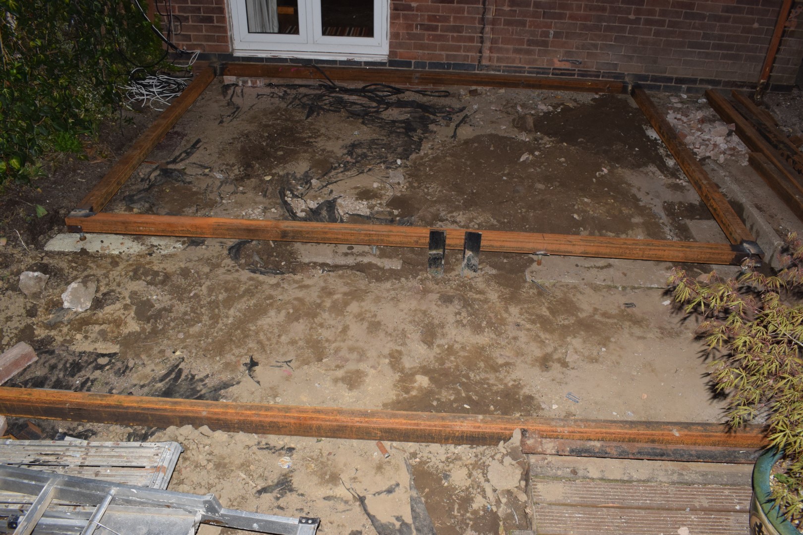

if its on the ground you will have to paint,and put some membrane under it

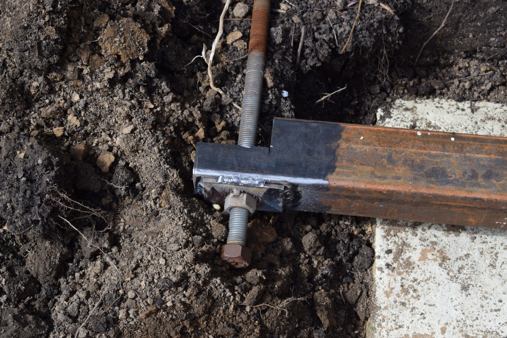

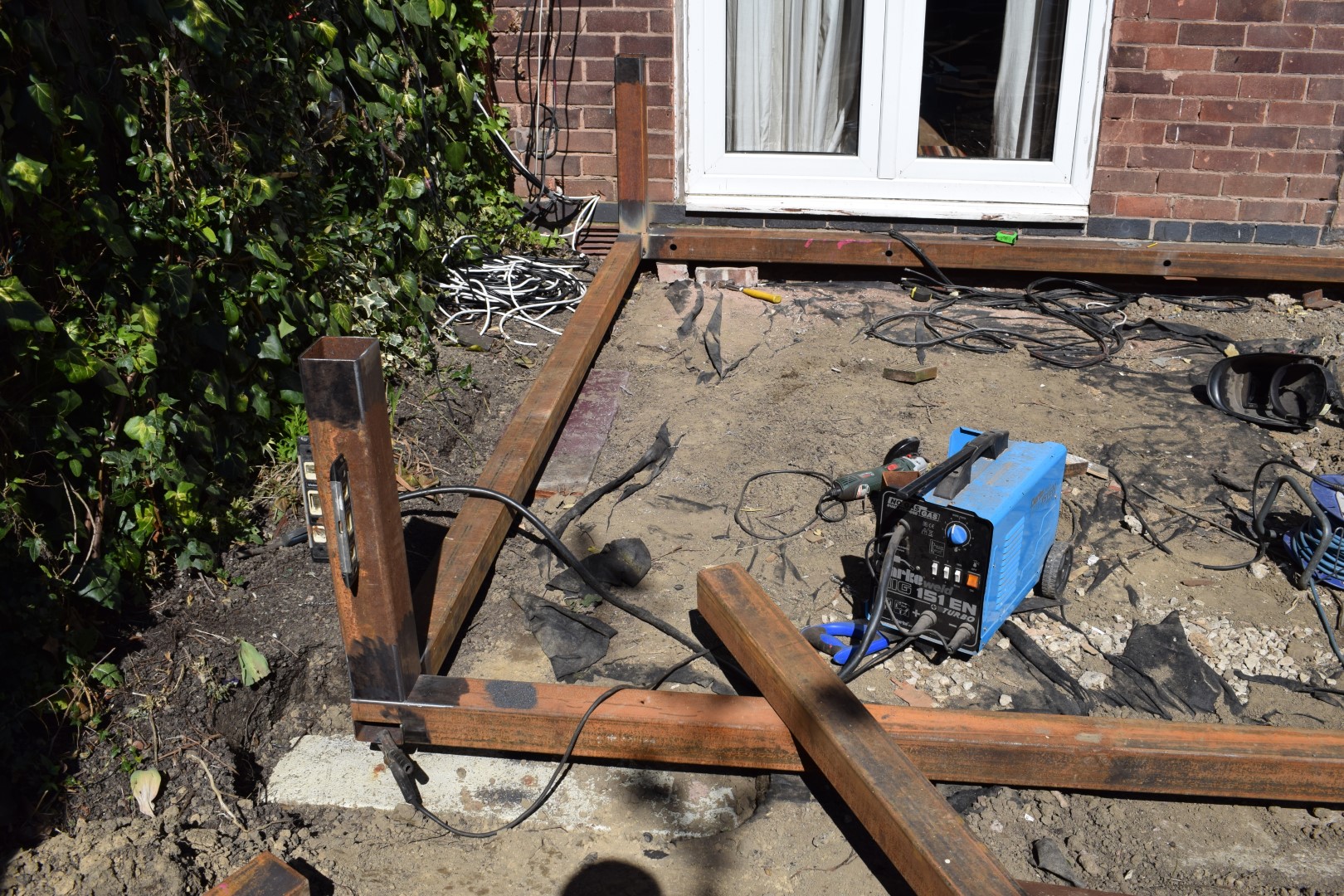

Why didn't you weld the captive nuts on the bottom of the steel leaving the top untouched and flat for sitting the wall on
Paint it even if it's not on the ground. There'll be a lot of condensation forming on it.
And close the open ends with plates and welds to stop it corroding from the inside.
If it's airtight the corrosion will stop when all the oxygen is used up in converting steel to rust.
I also think Jotamastic 87 would be a perfect paint for the outside of the box.
You are doing a really nice job there.
I thought that at first too but he is flipping them over so the nuts are on the bottom. (last pic).

mind the middle ones
centre box sections for strength
