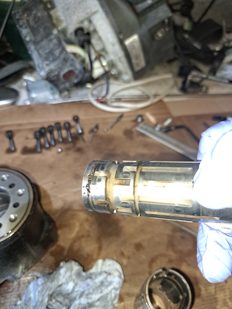

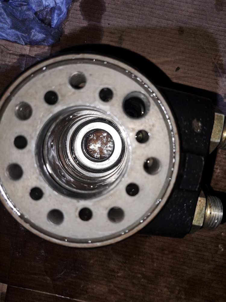

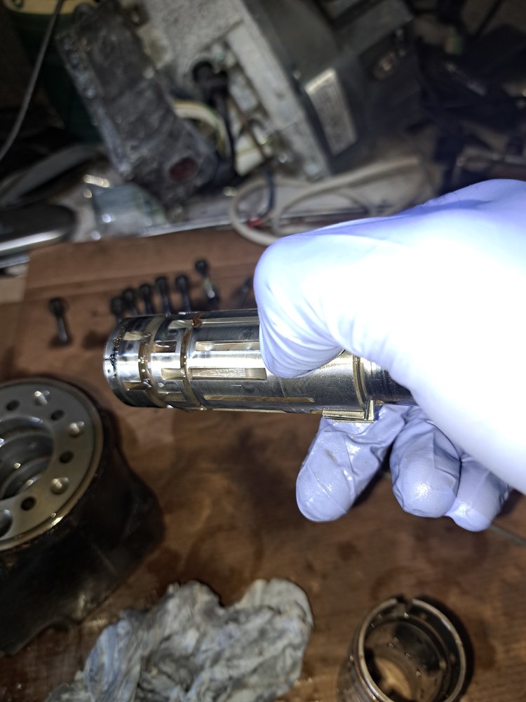

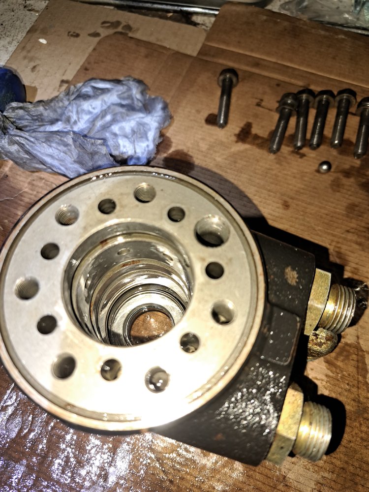

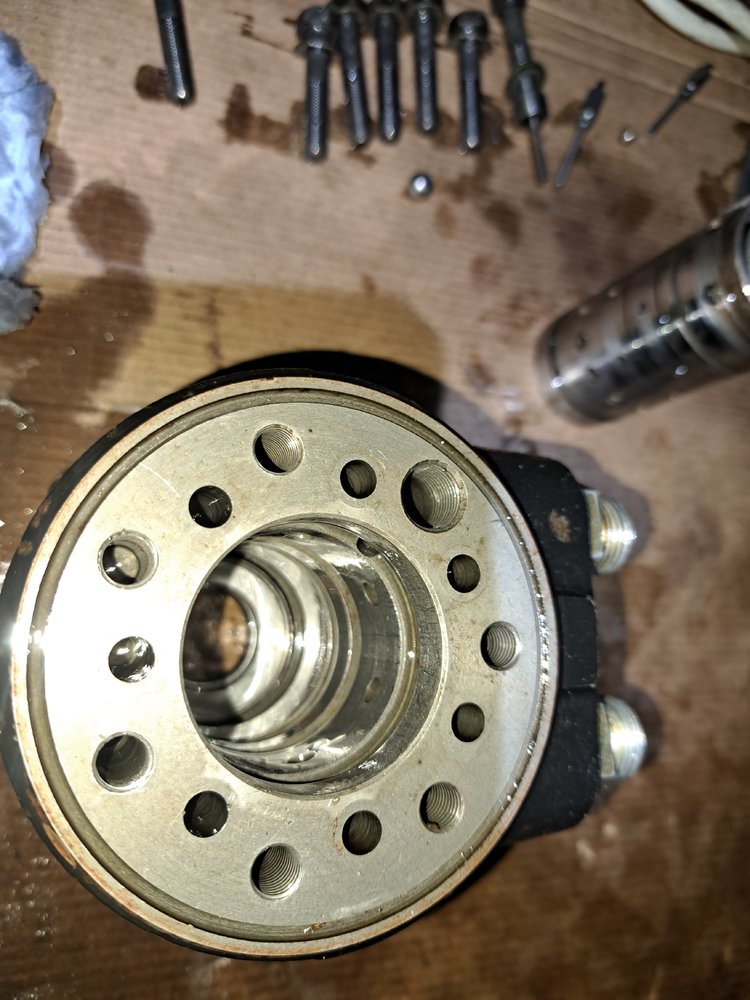

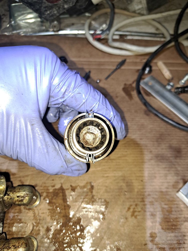

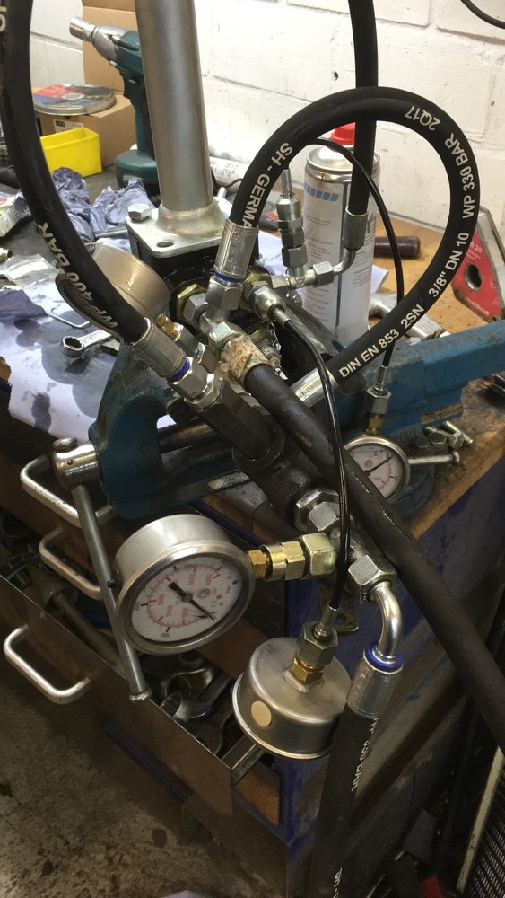

Probably nothing to lose stripping the steering valve, that is a lot of rubbish going through your hydraulics, could just be some crud behind anti cavitation or in cylinder relief valves, the fine tolerances in a steering valve do not cope well with contamination.
