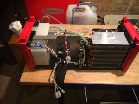

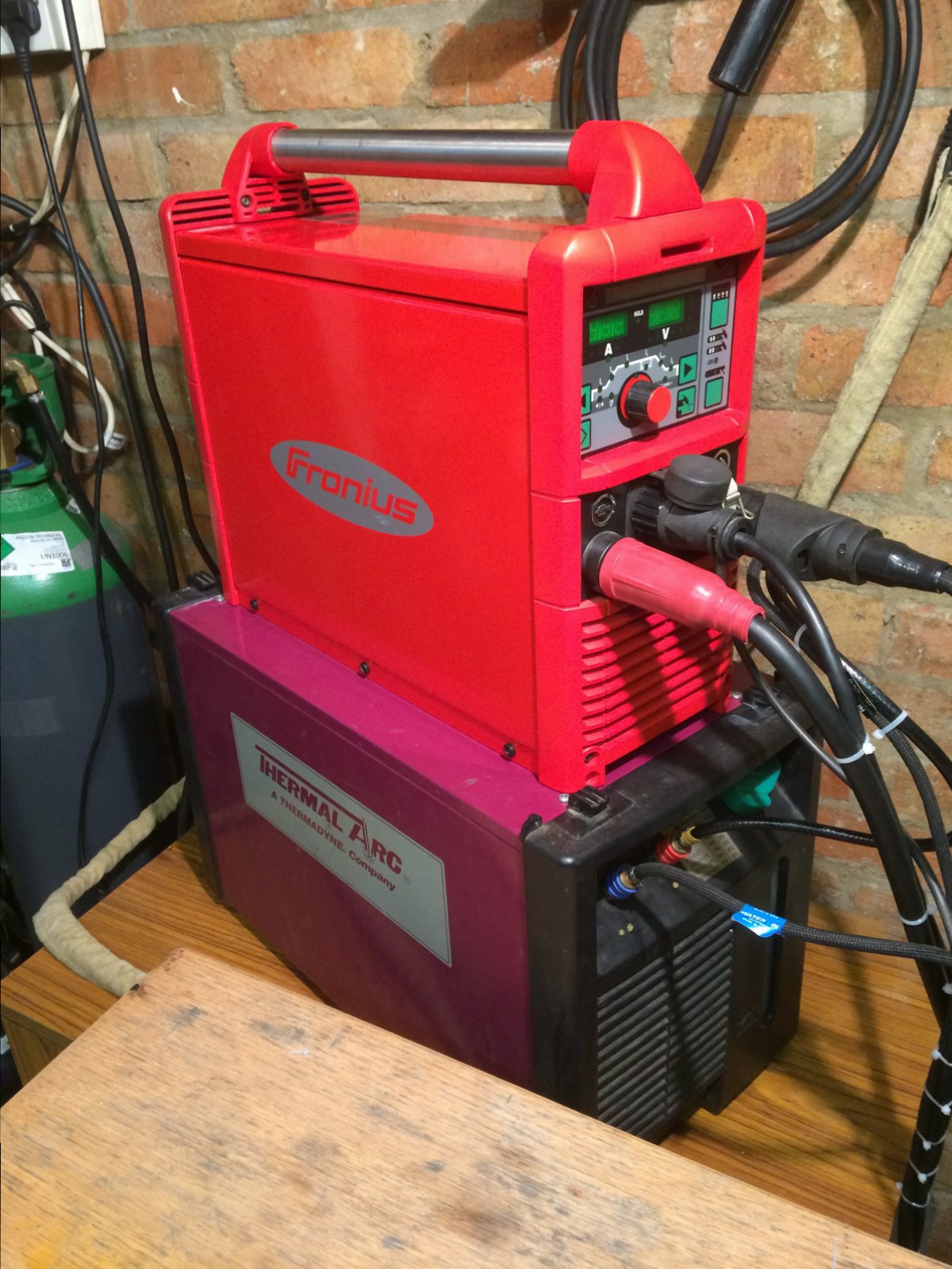

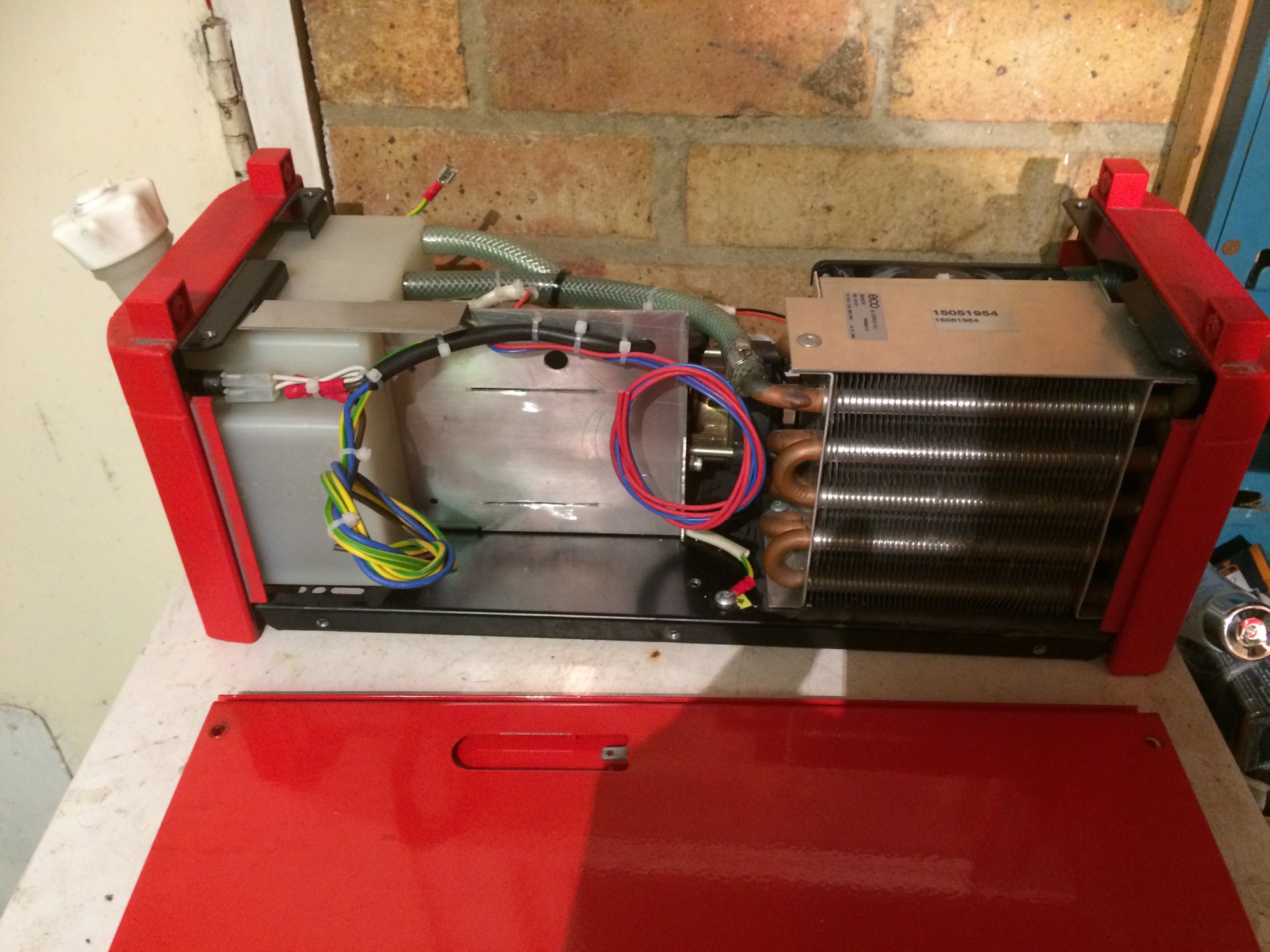

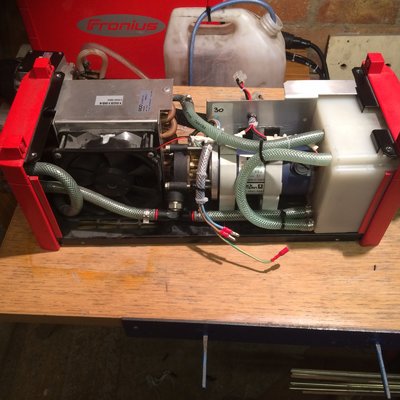

Cheers Hugh. Yeah I'd imagine you are as keen to see this going as I am.Very nice work there mate, roll on the parcel delivery man
We shall see Art. It's only a nice job if it works. At least I have the TA to fall back on. Must get round to finishing that ta cooler properly and offering it to you fine gents for sale. It's had a nice pump upgrade so far.never mind the colours as long as it works eh, nice job on that wiring harness you made up.
Wouldn't of been as straight forward had it not been for Hugh.couldnt agree more, lets hope between you guys its getting sorted.
It would suit the sanrex very well.Mmmmmmmm a thermal arc cooler, coulours would blend quite nicely.....

Why can't Fronius just keep things simple and fit 230v pumps. Would of been way simpler.
No I don't think it does. 230 single phase only afaik.Will that machine run on 415v as well as 230v?
If so keeps if easy for them as no mater what input voltage is used the pump will still get its 24v, but as far as simplicity goes a mains fan and a few links would be better.
