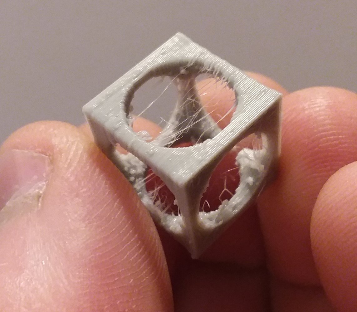

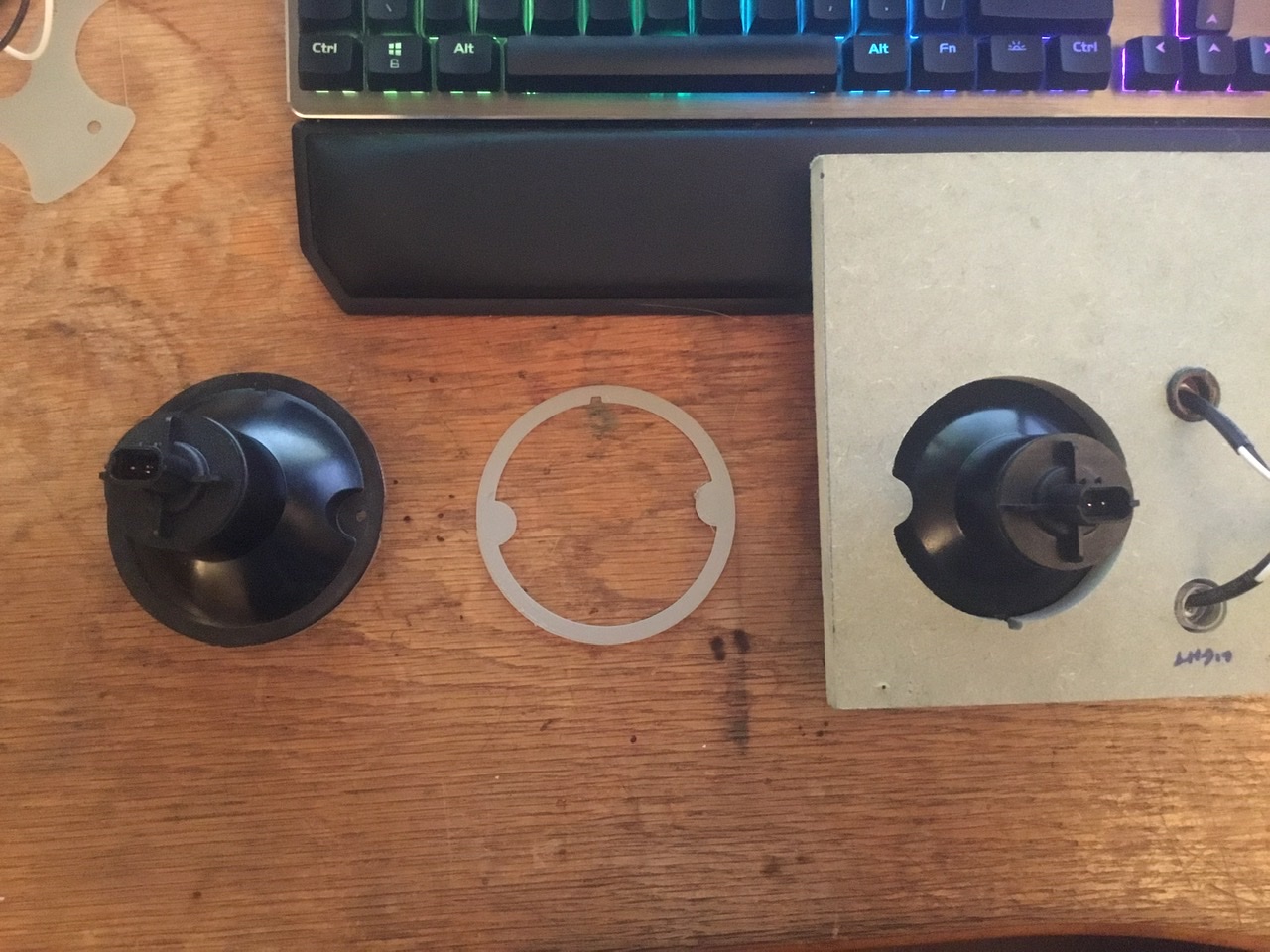

Managed to draw somthing in fusion 360 and get it to the printer
1st bit of 3d cad ever... and after watching a tutorial the day before that made my head explode
Not a good print, as quite small and not a lot of material there.
Only took 40 mjns to print
Now to try something i need
Its pla.. will try a bit lowerI would say that your nozzle temperature may be a bit high unless that is PETg?
Try 5 degrees down.Its pla.. will try a bit lower

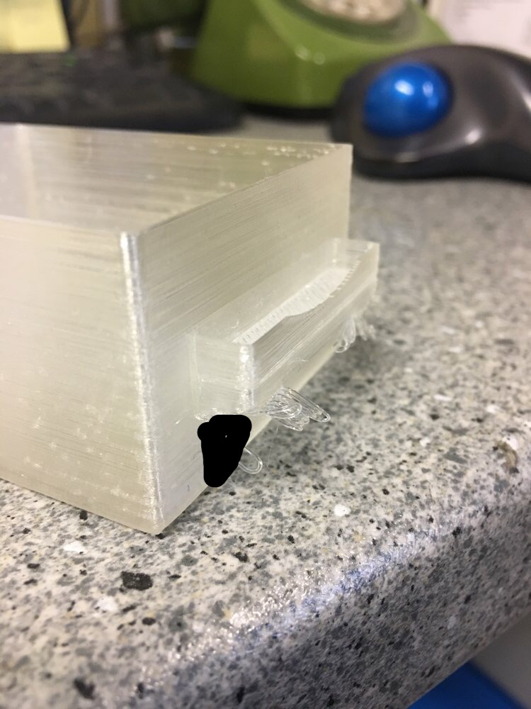

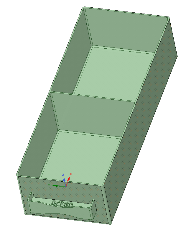

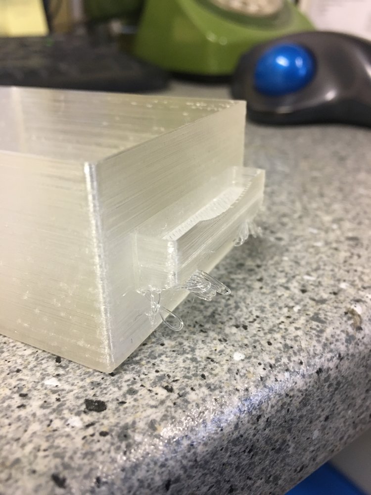

Adding a 45 degree underneath the handle

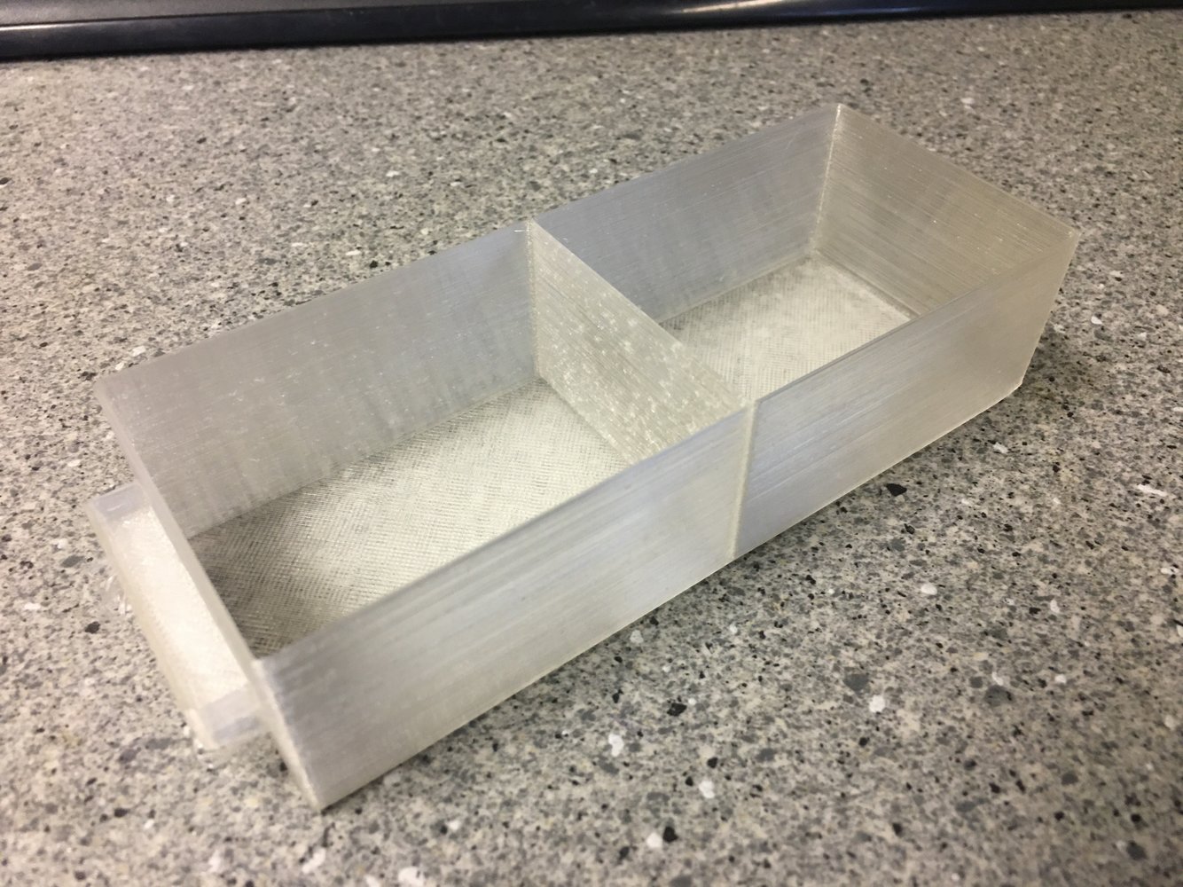

For anyone who wants to print the long drawer, it WILL need support switching on. As I suspected, it couldn't print the handle in mid air, although it did better than I expected.
