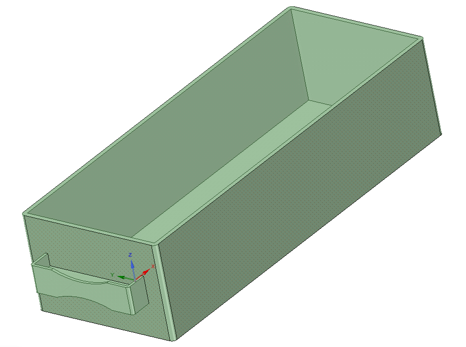

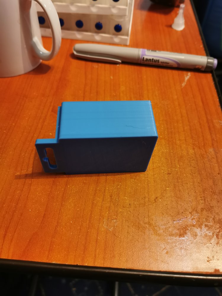

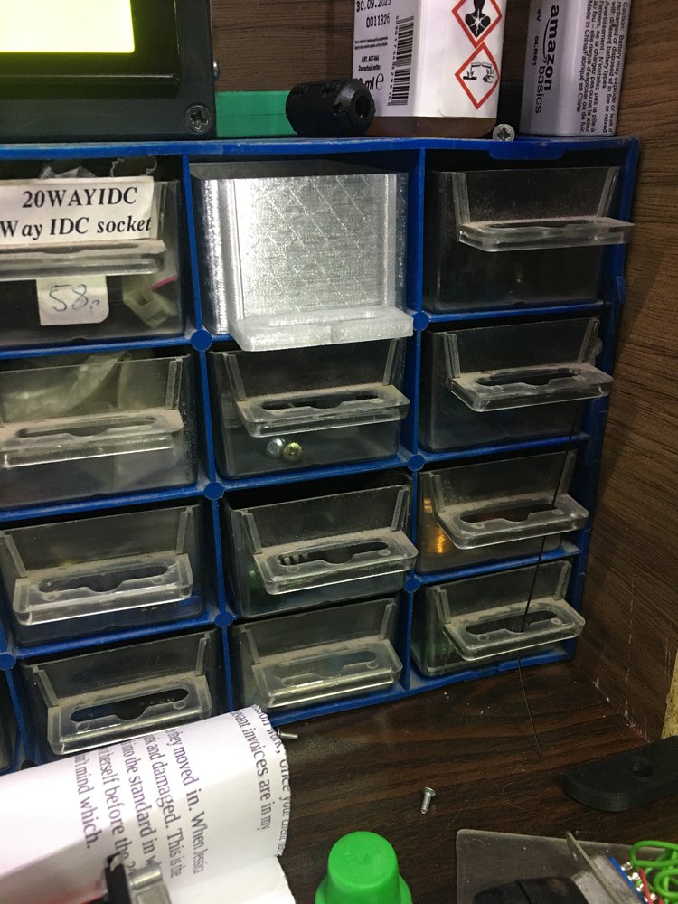

.STL being sent to you now. Must admit I didn't twig.
You are a bit late, I have made the .stl and started printing it an hour ago!
Lol! Cheers.You are a bit late, I have made the .stl and started printing it an hour ago!
PM me your address and I will put it in the post tomorrow.

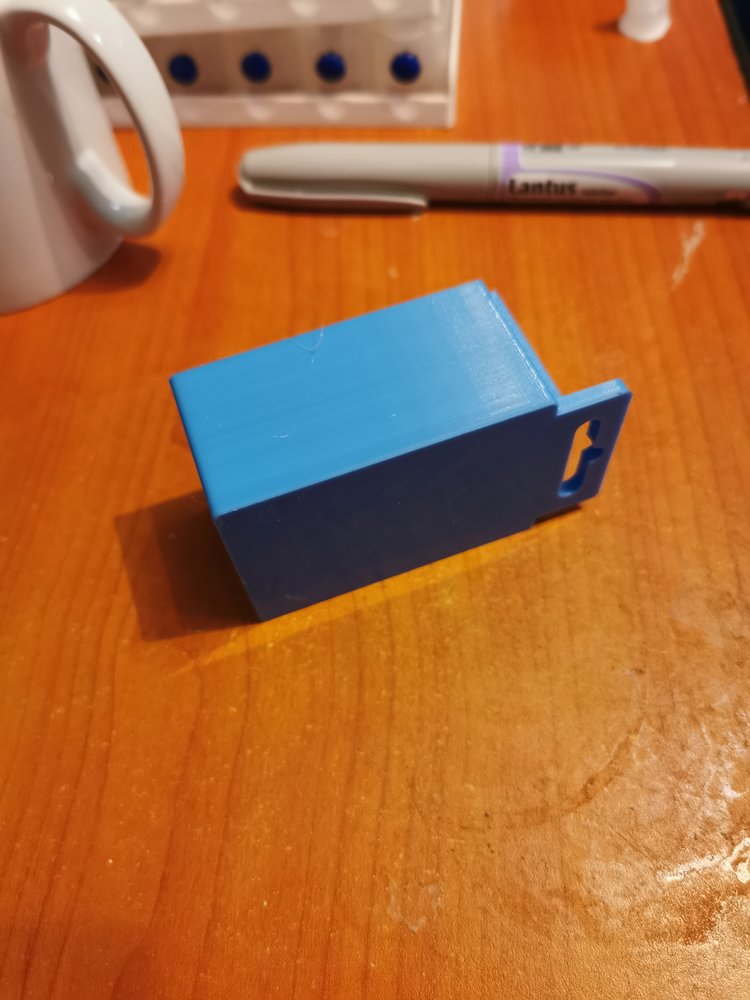

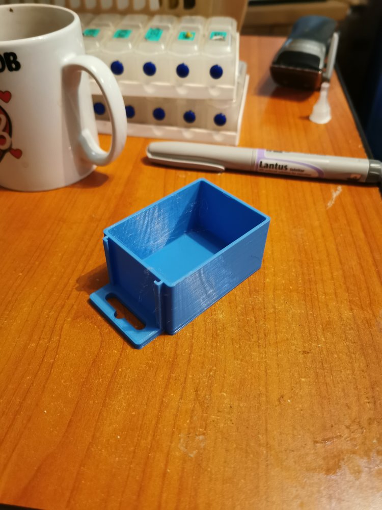

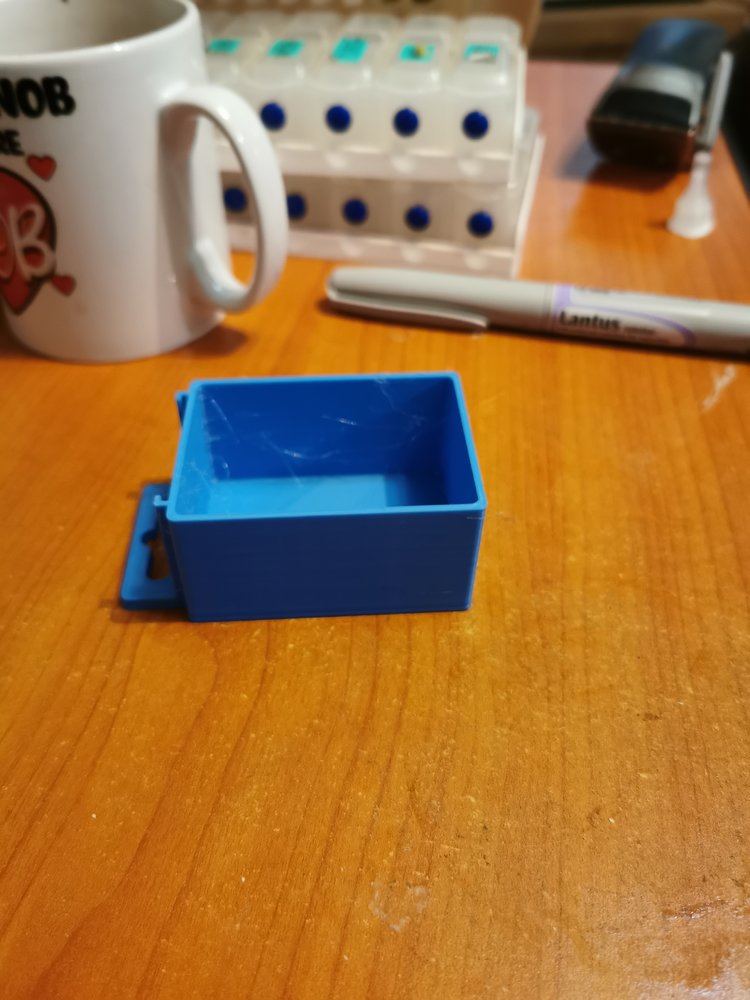

Thanks for that. Looks pretty good in the photo. Any gaps? All looks pretty tight. I'll pm the address thanks, be interesting to see someone else's attempt. Wall thickness here btw was 1.2mm so a multiple of the 0.4mm nozzle.
Lad did copy the original, originally, with the handle higher up.
I left him to draw it (done in Fusion) with no oversight by me. Looking at the one he's done he could have radiused the bottom and vertical rear edges.

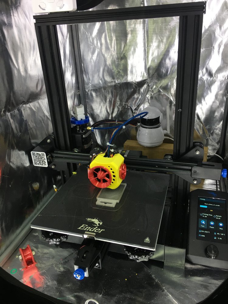

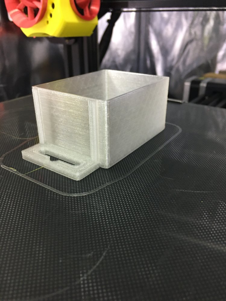

How long did it take, temperatures and what material?
Thanks again.
Three and a half hours in transparent PLA. Might have been eSun, not sure. 210 nozzle and 65C bed.
50mmS and whatever Cura defaults to which is 0.2mm. I can look it up tomorrow though. I also have Z seam set to random to get rid of an annoying seam down the rear of everything.Cheers. What speed and layer height was that?
