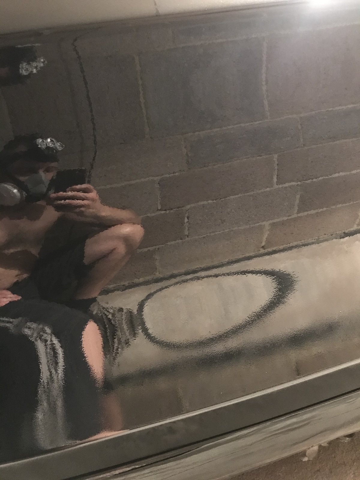

Base coat really needs 3 coats for full coverage. You don't need to worry about getting full coverage or a shine to that.
Clear coat also put on 3 or 4 coats to allow you to cut and polish, don't worry about getting a mirror finish as it's not going to happen with the kit you have and where you are spraying.
