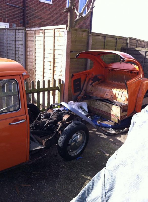

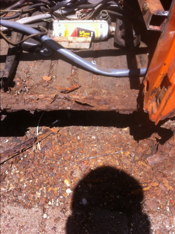

There has been some development on this project, although no actual welding.... yet. I wanted to get a fuller picture of potential rust that might be hiding behind the front wing, but because of the way they are attached to the chassis the nose cone had to come off. 26 years of rusted nuts and bolts proved to be quite a test in tight spaces but eventually it was stripped back to show another hole that needs plugging.
