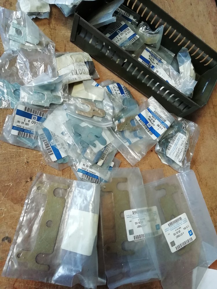

The car has only 50mm lift done by the previous owner. 50mm is considered low enough not to mess with the geometry too much.
For those who keep saying to get it done professionally. I spent no more than two hours yesterday learning how to measure the geometry and removing a shim as a trial. Another hour and it'll be done. Taking it to a pro isn't as easy as it sounds. Every alignment centre in Surrey is a tyre shop, I couldn't find any pros, and I really won't trust a tyre shop to mess with suspension. A digital inclinometer and a £50 Bosch laser level are as accurate as the shop's equipment, just take more time to set up, and sometimes more accurate because the shop measures off the rims, whereas home equipment measures off the hub. For anyone who's messed with suspension geometry, you can't get better than 0.1 degree anyway even if you're equipment can measure it.
