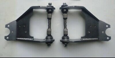

I found a way to line up the laser level and checked the castor, it's the exact same on both sides so I don't get the Kwik Fit readings. Just the camber is out, which is likely due to the suspension lift.
The car was pulling hard to the left which is why I started checking all this. I swapped the left and right wheels and now it pulls to the right, just enough to offset the crown of our left side roads, perfect.
Yes that's what I thought, the rear panhard will have moved the rear axle sideways, so I was surprised that Kwikfit told me that the thrust angle is perfect. I was thinking of making an adjustable panhard to compensate but looking at it today, the panhard is very long and near horizontal so I doubt the axle has moved more than half a centimetre.If you have lifted the rear (I'm assuming its on coils) then your axle will have also moved off centre
In what sense did you notice it? Just visually or did it alter the handling?@rcx132 It does depend you high you have gone, mine was 4.5" on the rear and it had moved, not a huge amount but enough to notice so I made a slightly longer panhard rod to bring it back in line
That was my thought until I found out it was a modified and raised 4x4 which has added complications, it will need the geometry set up correctly before going for a final alignment.Is it really worth the effort? Just take it to a proper tire depot not a Micky mouse outfit and get it done right without buggering around

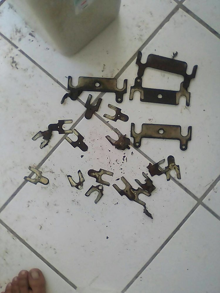

Sorry yes you're right, theres shim already there, I can remove some.I can see your diagrams on post 12 now.
Have you had a look to see if the top mount has camber shims installed, removing them or reducing them will give you more positive camber.
Oh well that’ll definitely help, 4 inch lift is a lot for a car which still goes on the road but removing the shims will reduce the camber for sure.Sorry yes you're right, theres shim already there, I can remove some.
BeJesus, that’s a lot of shims, I’m guessing that the big ones are for the camber and the small ones for the castor, you’re basically going to have to get the correct geometry through trial and error.

@8ob thank you. My laser level seems to be doing the trick now. Just need to older some shims.
