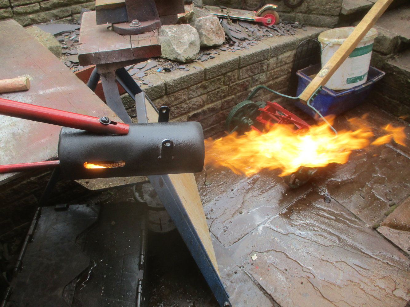

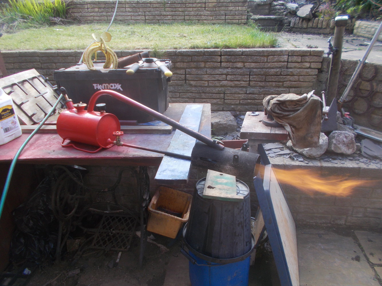

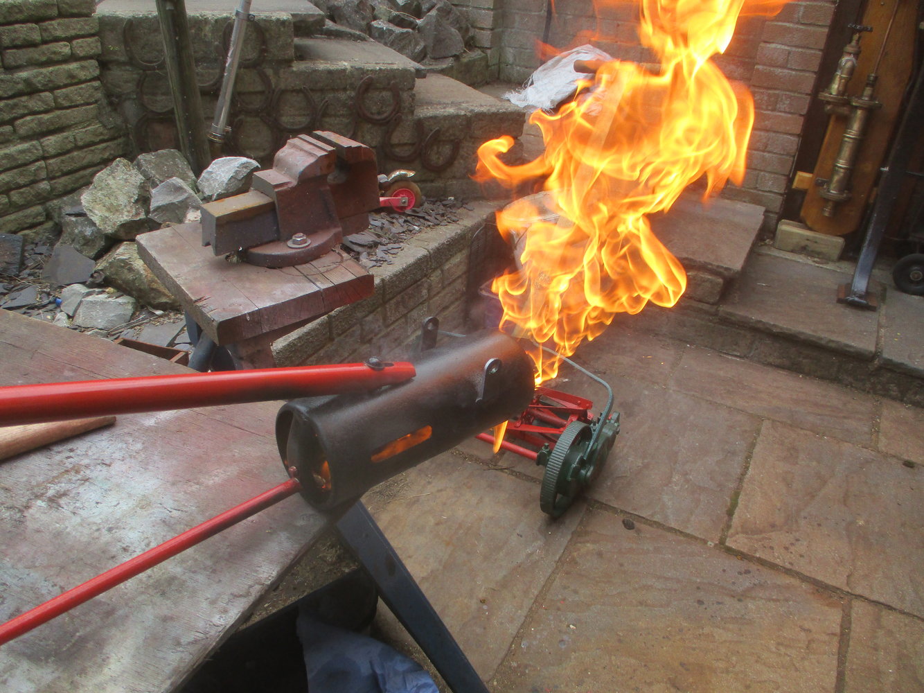

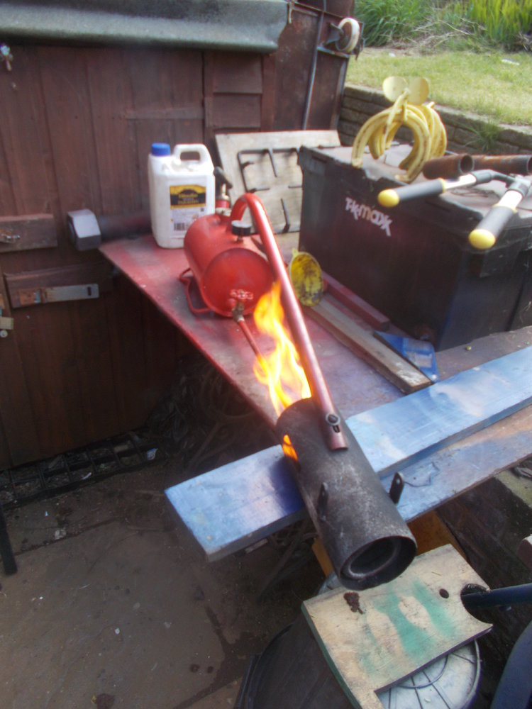

Thank you for posting the photos. Also the description of what is happening in each situation.@mart
Weed burner fun?
Is it a pressurized one?
A few good tips.
Make sure the pre heat is good.
Never fill over 2/3.
Keep the pressure up to the range the manufacture say.
Get it right you get a flame like this.
Hot flame, but over filled.
Bad pre heat.
Wrong pressure.
Uncontrolled flame.
Cold flame.
Switch off and start again.
This is when you get everything wrong.
