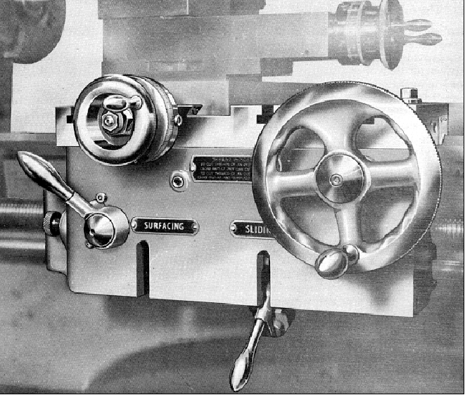

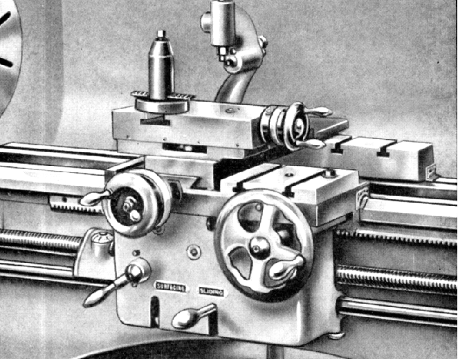

Thank you I am sure @bR39Da had a play with them when he had a visitIn its centre position it allows you to use the half nuts for threading. If you move it up or down you engage the surfacing or facing feeds. I can't remember which is which. Bu its easy enough to work out.
