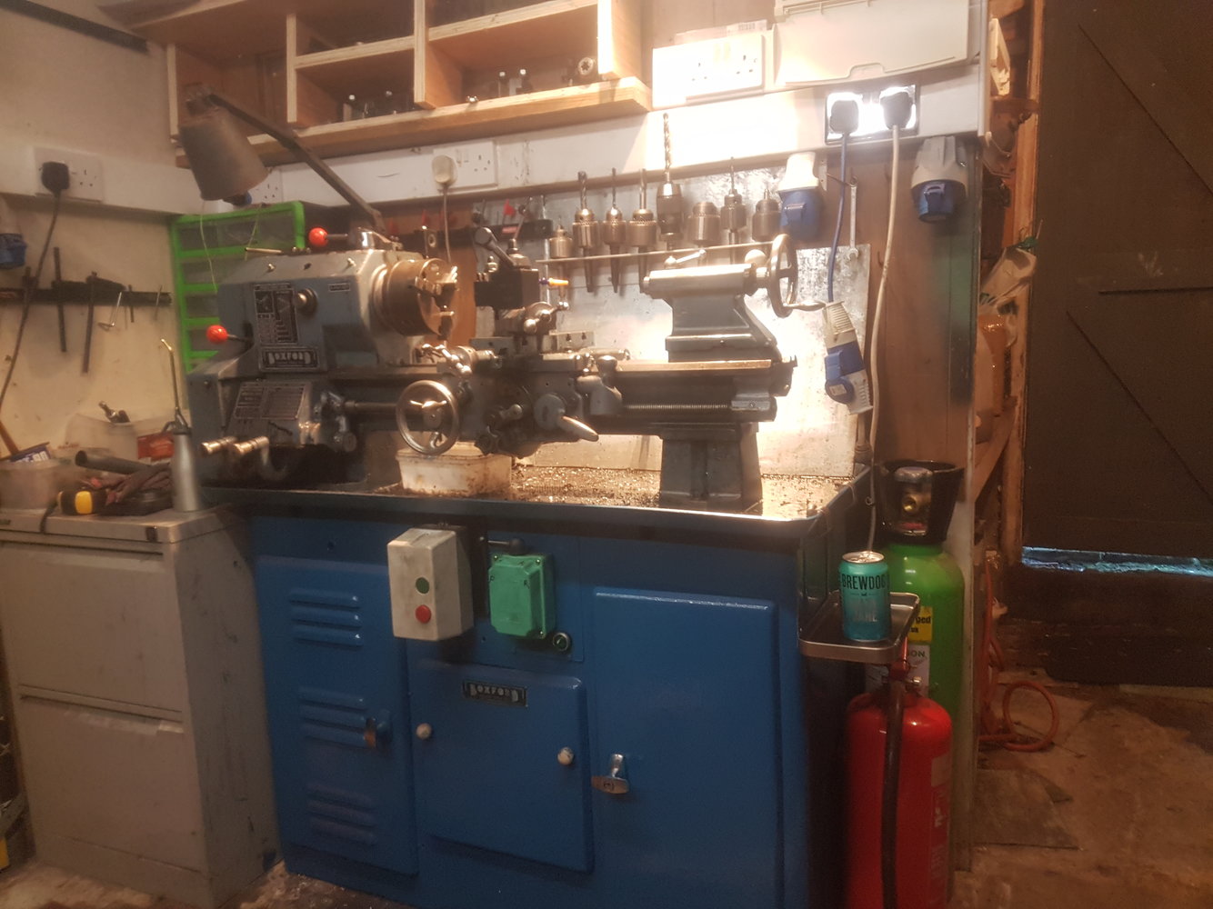

I only have a leadscrew on my S&B model M. It says in the manual to engage them for a power feedUsing the half nuts to power feed will wear your leadscrew

This is my second lathe - my first didn't have any leadscrews so all this new fangled halfnut trickery is new to me
I will investigate whether there's any kind of stop/clutch/disengage as I must admit to being more than a little concerned about what happens if the carriage or toolpost collides with the chuck!

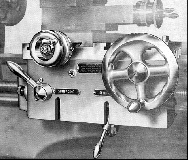

It's a Colchester Student 6", circa 1930sWhat's the lathe? Colchesters (at least some of them) have a twist-grip knob on the engagement lever that can be adjusted to set the trip point... I used to check mine by setting the power-sliding away and then hanging onto the toolpost from the right-hand end of the bedAt the higher end of the range I couldn't stop it, so god knows what sort of cut you'd have to be taking to make that drop out! I never needed more than the minimum setting to trip out against a bed stop.
back it out, rewind, push in and repeat

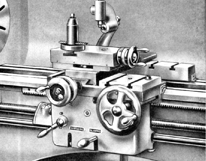

Hang on chaps, what model Boxford are we talking about? On the C or CUD the apron only has one lever, which engages the halfnuts and which is the only way to get power sliding (no surfacing or 'cross-feed') on that model.
The higher-spec models have two levers: the far right one enagages the halfnuts as above (for screwcutting, in collabration with a dial thread indicator) while the one to the left of it has three positions: disengaged in the centre, up for sliding and down for surfacing. The friction clutch is then brought into play, simply by a twist of the wrist as it were, and this when set correctly WILL slip at a preset travel limit. Using the halfnuts for power sliding will quite happily break things if you don't disengage in time.
