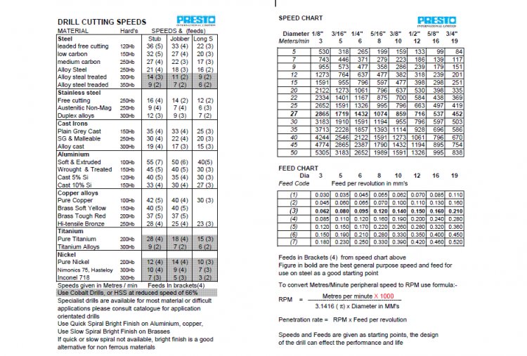

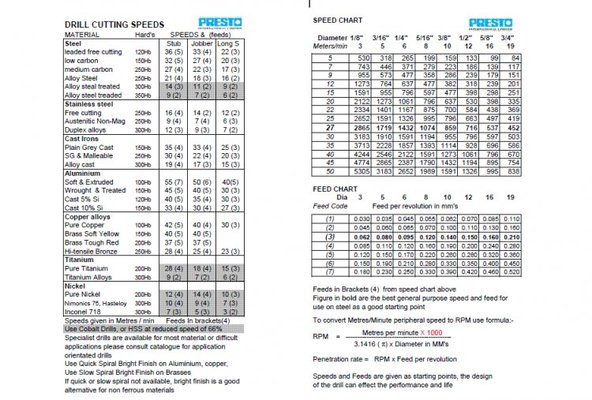

MG David at the bottom of this post is the feed and speed chart for drilling, that I have on the wall next to my drill press. It sounds like you are using far too much speed with your drills and if you are drilling thin material that will also heat up fast transferring heat to the bit. Slow your speed right down as per the chart.

Drill speed chart.

Drill speed chart.
