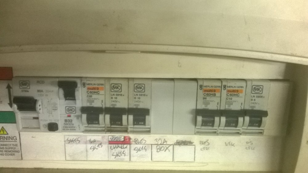

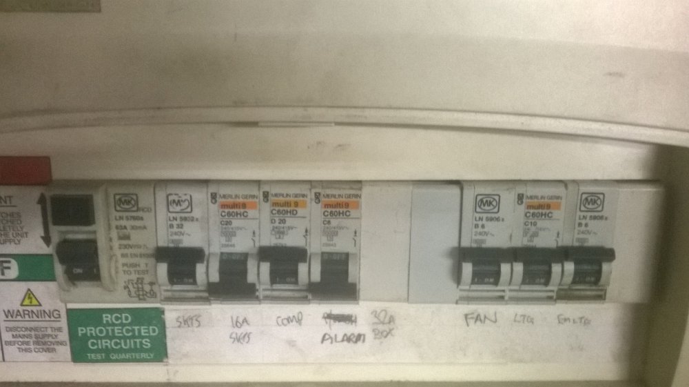

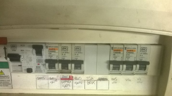

Don't know what I'm looking at here, what's wrong with it?I'd personally ignore 99% of this.

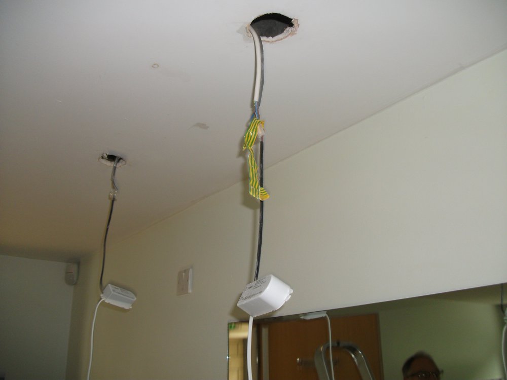

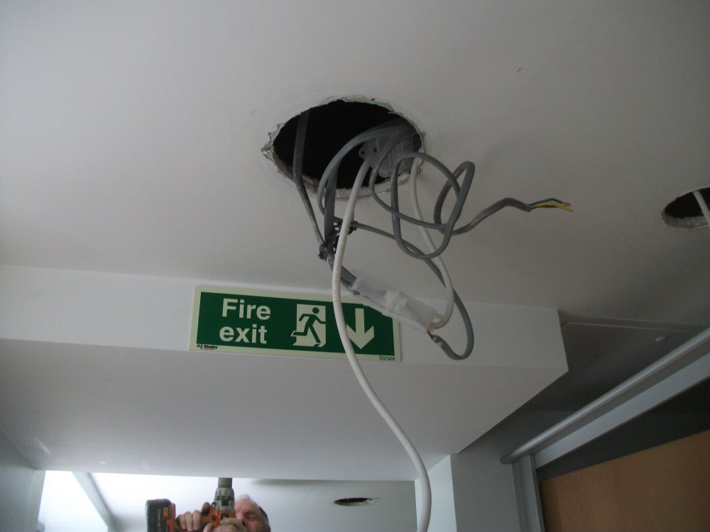

How not to do it..
