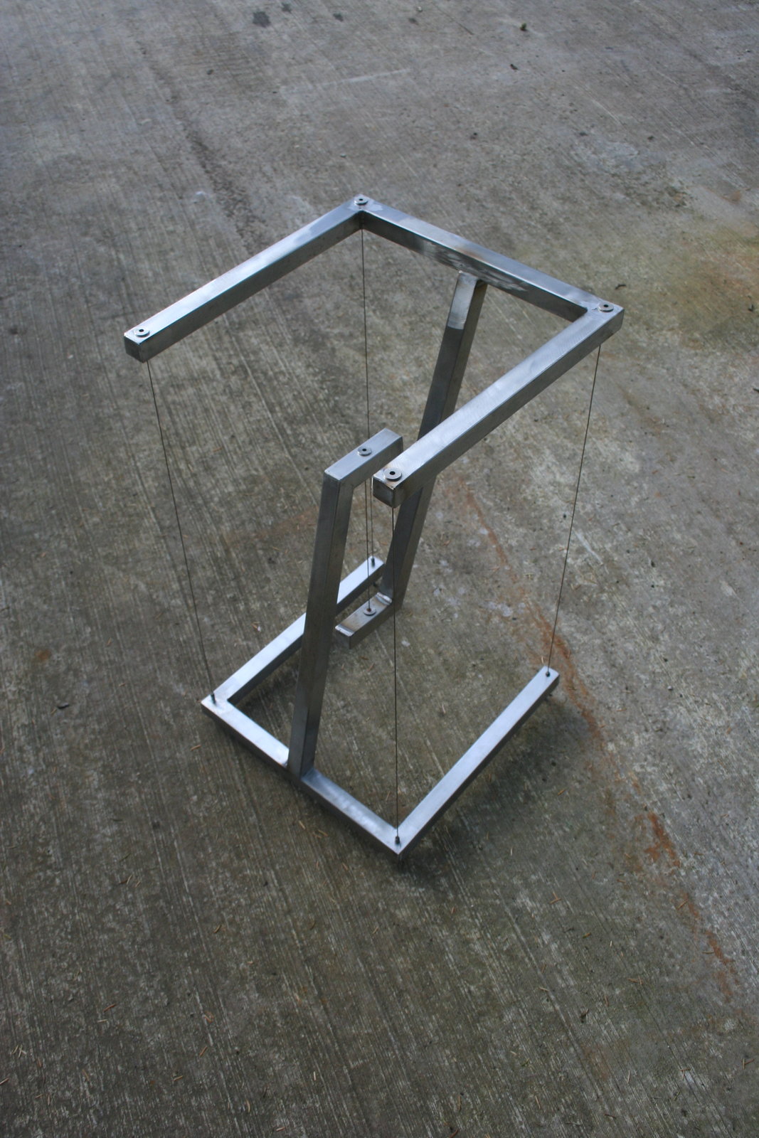

if you want to make it up buy 3mm box section say 50mm
you need some 5mm steel plate
slit the 3mm box section in middle fit the 5mm in the slit and weld up
then drill through both 3mm and 5mm steel for the bolt to go through both
the 5mm is the strength whilst the 3mm is for show and support of the bolt
then tighten the nut so the chains tighten up fit caps and job done
