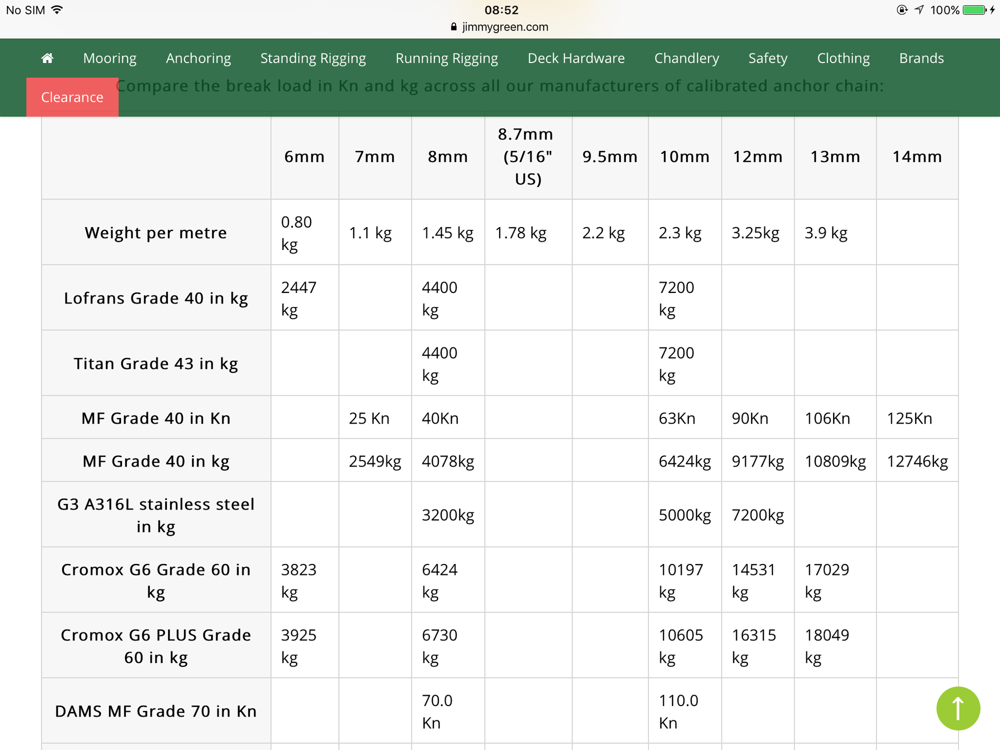

8 mm galvanised chain ( chinese anchor chain, nothing special) will break at 3+ tons.middle chain id suspect not strong enough and i bet it wobles like a git too

Yes totally, and for that reason, the frames need to be much stronger than a normal table. For this reason, I accept it's a dismal engineering design, because it needs far more steel to work properly.. more of a novelty conversation starter..if you intend to make one take note
that all the bolts need to be tightened up so they pull those chains stiff so they dont move
