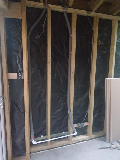

Times 2, do it right do it once.well if I was doing it:- (bear in mind i do this for a living)
paint on bitumen membrane on the inside face, 3 coats, thick
50x25 (38x19 will do)treated battens screwed to the wall at 400/600 centers and around openings
at least 25mm celotex/kingspan/quintherm etc over battens, 50 is better
ideally foil backed or moisture resistant plasterboard ( a little ott but....) screwed to battens
skim... its worth it, if you have a plasterer there is should be less than £200...depending on exactly what he has to do....
