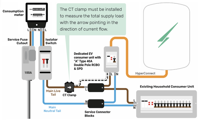

other than that... you could get a 32amp socket in the corner for the garden behind the fence... then a 7kw plug in charger? 7kw is the same as the 'proper' fitted chargers anyway
I know people who just use the 3kw granny charger all the time (type with a 3 pin plug on) depends how many miles you do / how quick you need to charge
