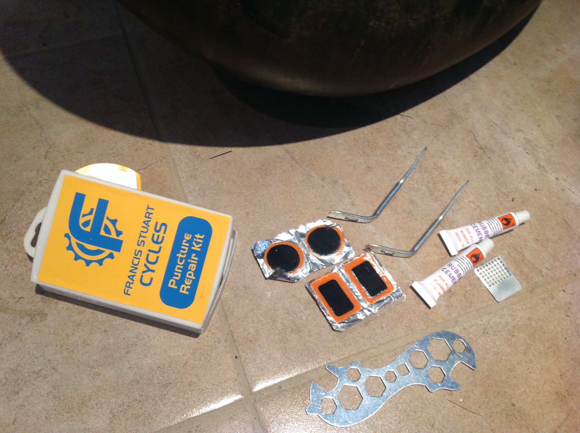

I used to get cure c cure patches from the local bike shop, reliable and assorted sizes with nice feathered edges for a good seal.

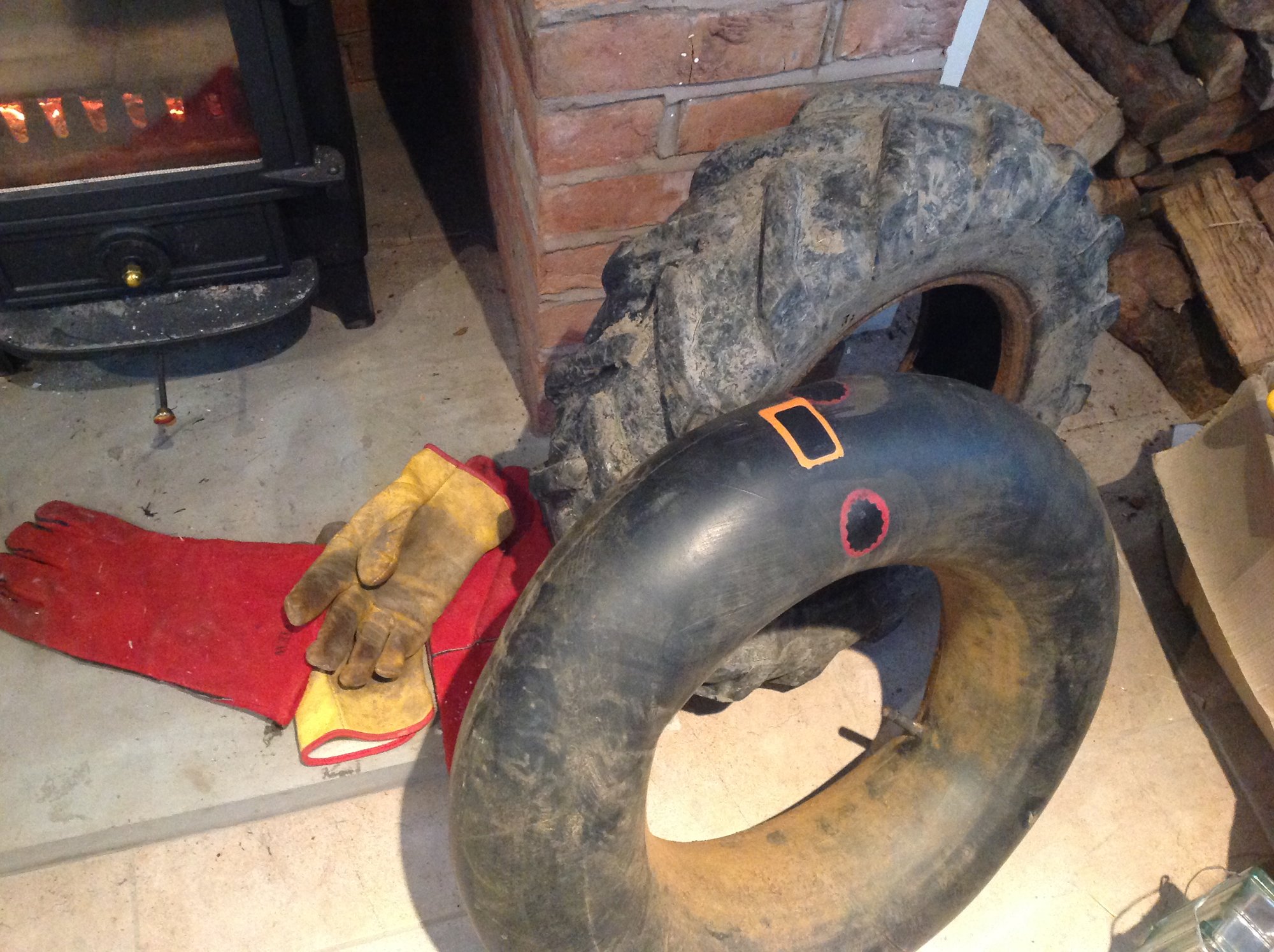

View attachment 263925View attachment 263925 View attachment 263926 View attachment 263927 B Here we go , picked a kit up from home baragains , £1.50 ish , not quite sure the tyre levers are up too it tho
The patch I put on was the rectangular one ....

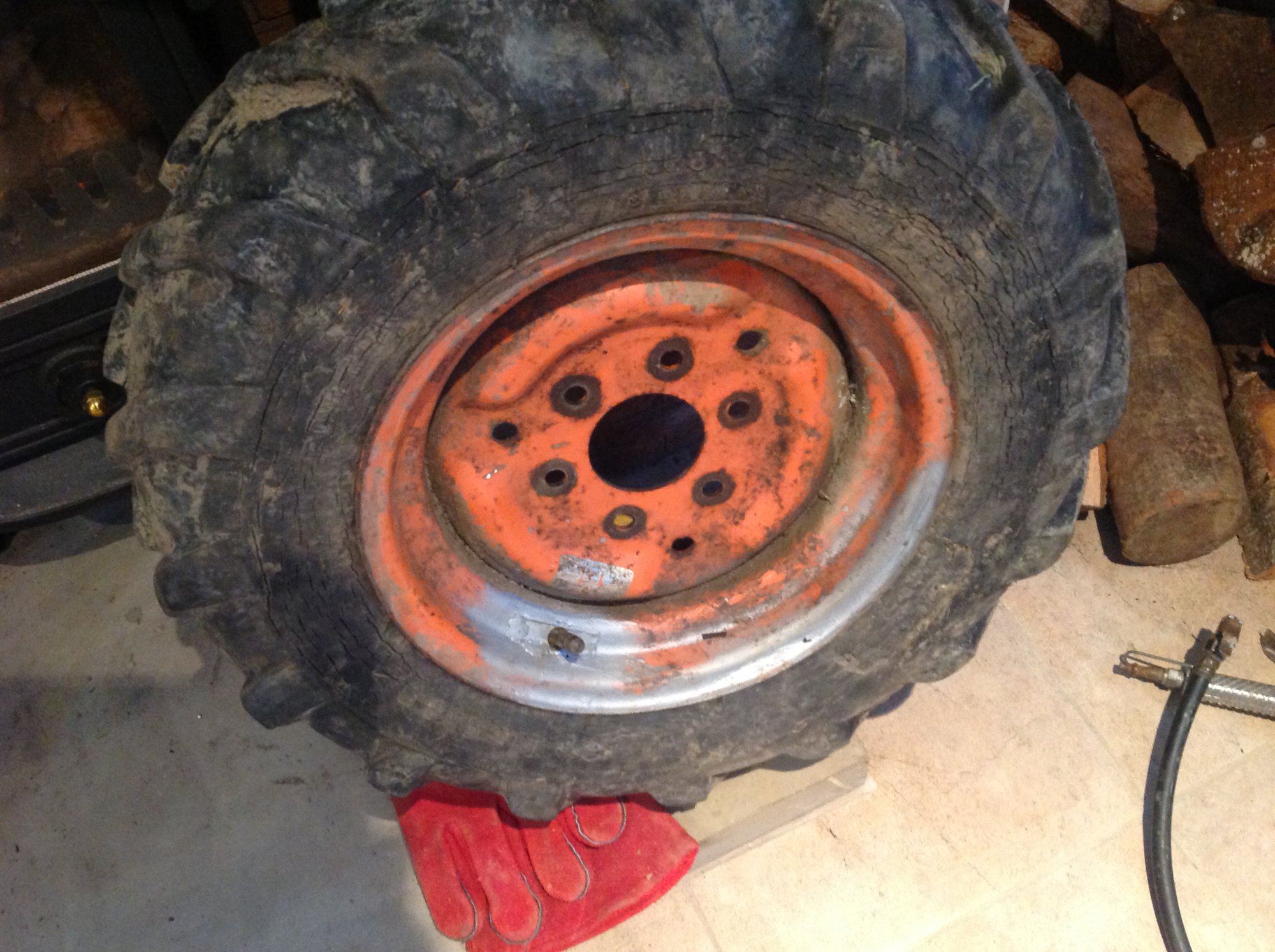

Had to weld up a patch on the wheel where the valve pokes thru as it it was a ragged rusty Orrifice![]()
So who hasn’t used an old bit of inner tube as a patch before
Bob
Top tip when repairing tubes in snotty old ag tyres, always index/chalk the tyre where the valve is so you can reference the tube patch to the tyre, it helps the search for whatever stabbed it in the first place.
Bob
