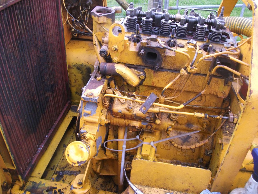

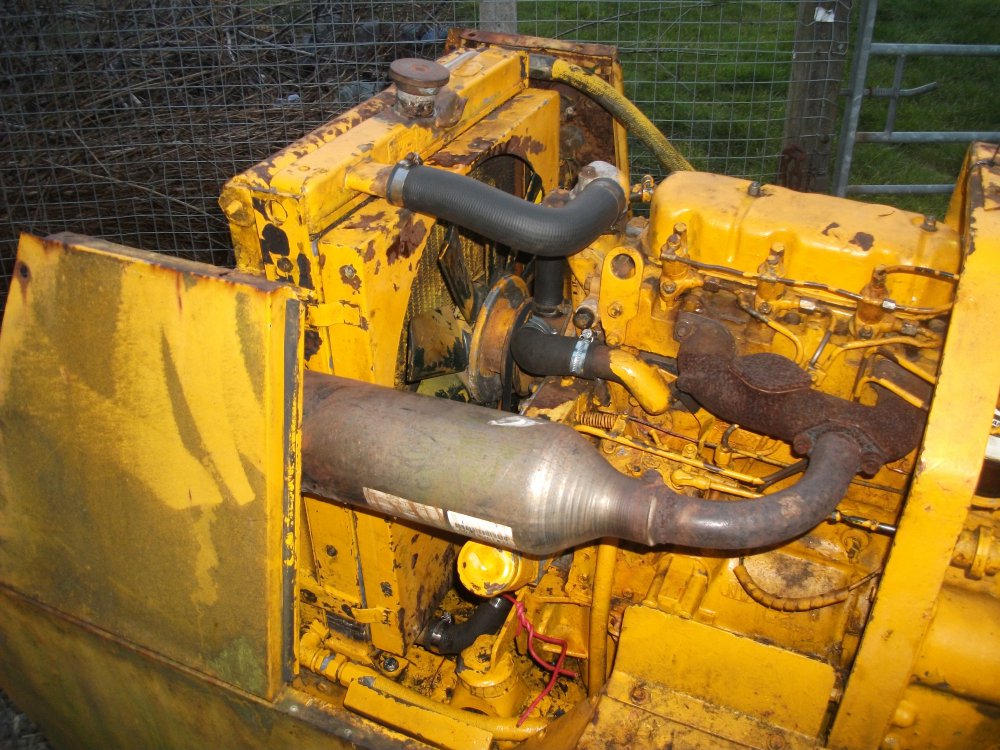

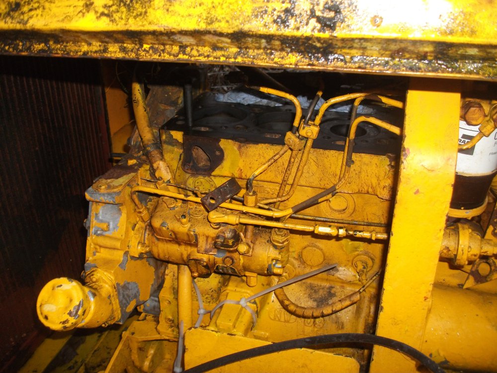

Ask your nearest Massey Ferguson dealer. The engine will be a 3.152, there were thousands of them fitted to small massey tractors like the 135. Twenty years ago I could have told you the tappet clearance myself, but sadly I've forgotten.can anyone help I have an oldish perkins 3 cylinder engine on my -compressor. need a head gasket for it but would like to know the head torque setting for it or where I could get info for it and also the tappet clearances for the valves . any help appreciated
thanks for the help -so far a genuine head gasket is 20 quid- plus vat a 2 week wait and 12 quid deliverydunno wether a pattern one will be ok from ebay
he did say it was a D3.152 earlier.Ask your nearest Massey Ferguson dealer. The engine will be a 3.152, there were thousands of them fitted to small massey tractors like the 135. Twenty years ago I could have told you the tappet clearance myself, but sadly I've forgotten.
thanks for links toIt wouldn't be a .2 0r a .4 though. Back to perkins nomenclature: 3= cylinders, 152= cubic inches, .2, .4 =improvements. Having said that I realised after I'd posted that other people had already replied!he did say it was a D3.152 earlier.
which is part of the same family to include the 3.152, D3.152, 3.1522, 3.1524, T3.1524 and D3.152M engines, the latter there being a marine engine.
they are all the same block, its what they did to them after that which gives them the independent models.
i had a 1004.4 engine here a few months ago and even tho it was a phaser engine there was 4 different gasket sets to fit it.
the tappet clearance is .30mm cold on the D3.152 but there is 2 or 3 links to manuals here now so he couldnt go far wrong at this stage.

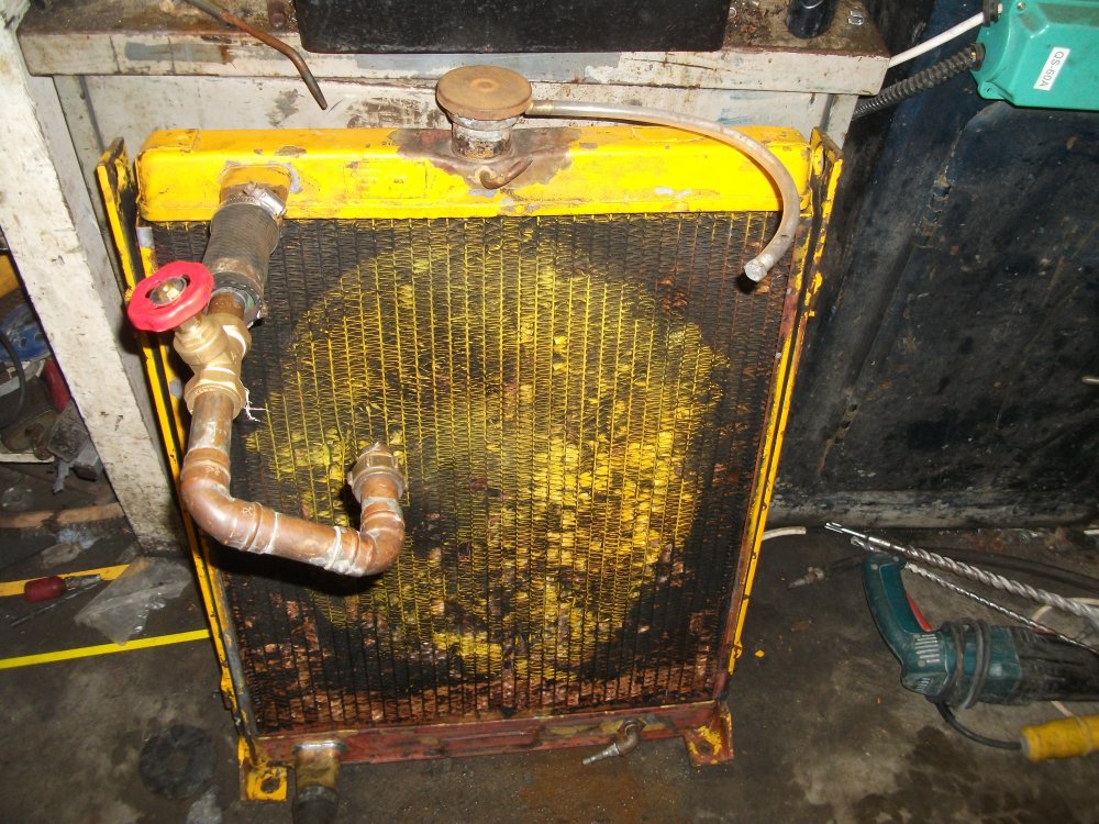

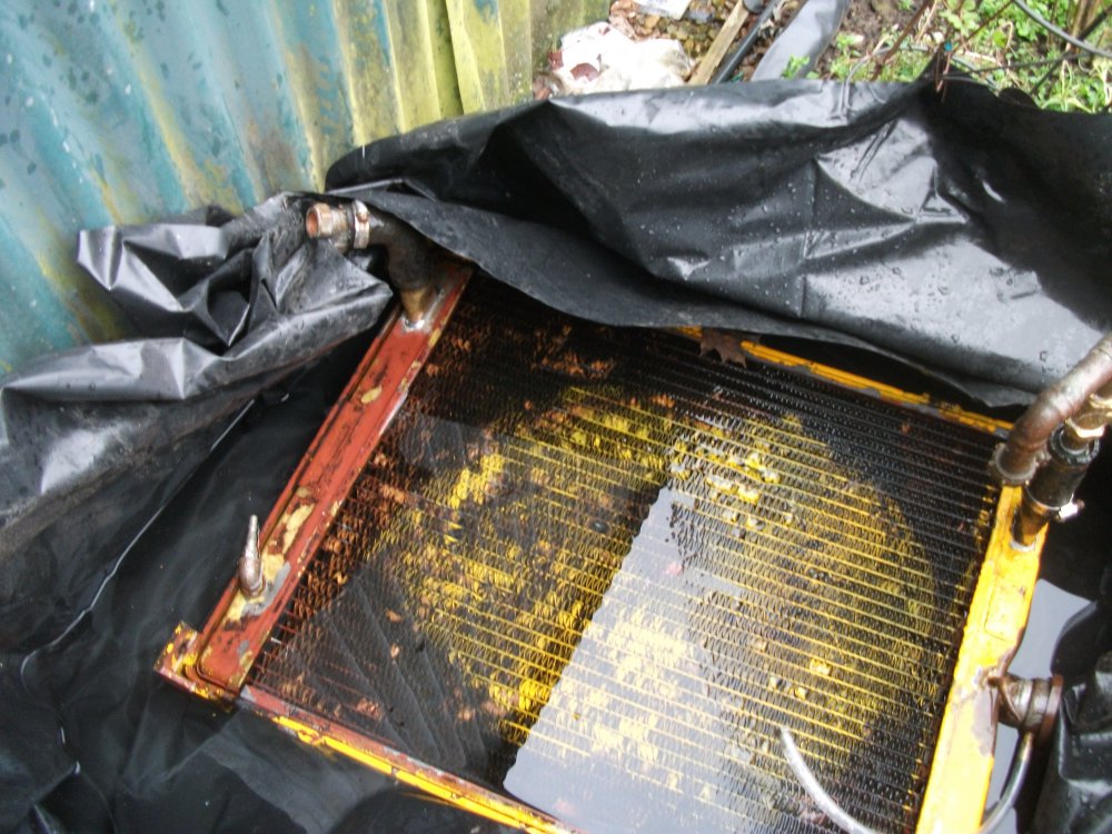

ive soldered the leaks up and pressure tested it and its fine . a recon would cost 250 quid . its quite large and fitting something of another machine would be difficultAnd how long have you had this machine and only just got round to fixing itwell found the problem it wasn't the head or pump the radiator was totally clogged with mud and oil on the outside . it was also leaking round the lower outlet and a pinhole in the middle. it couldn't be seen without removing it as its behind a cowl one side and a rather large oil cooler on the other .ive soldered the leaks up and pressure tested it and its fine . a recon would cost 250 quid . its quite large and fitting something of another machine would be difficult
uummmm mmmmm about 3 yearsAnd how long have you had this machine and only just got round to fixing it![]()
no one complained . need toflush the rad out power wash it all down fit the casings and a coat of spray paint and that's it. thanks to the members that have given information on it . a big help
