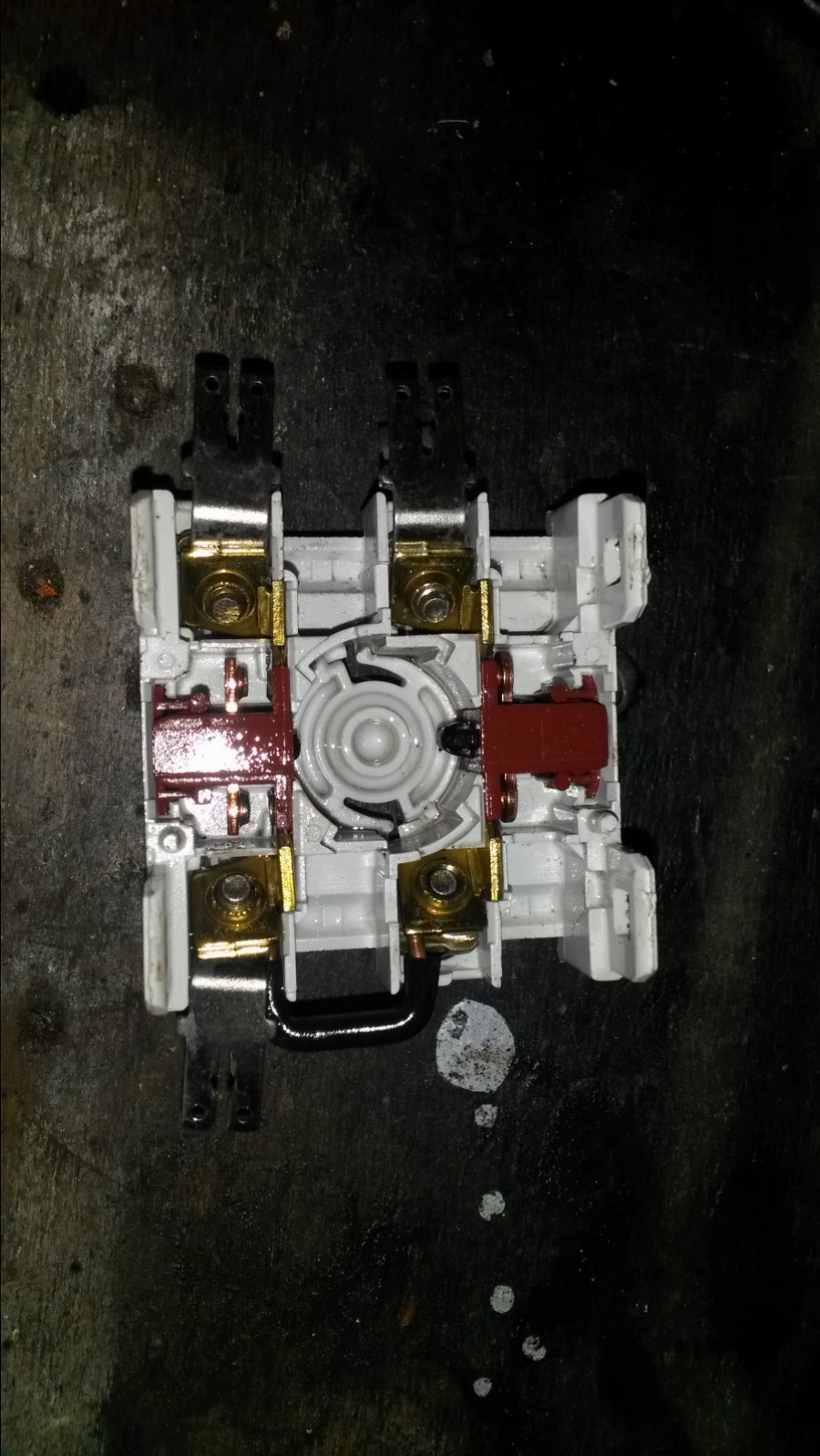

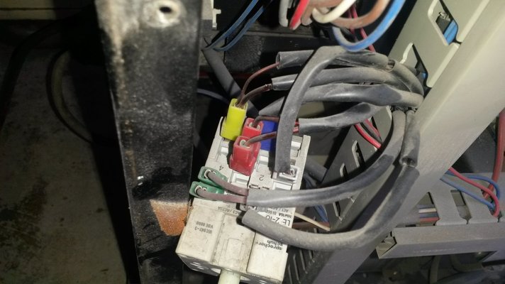

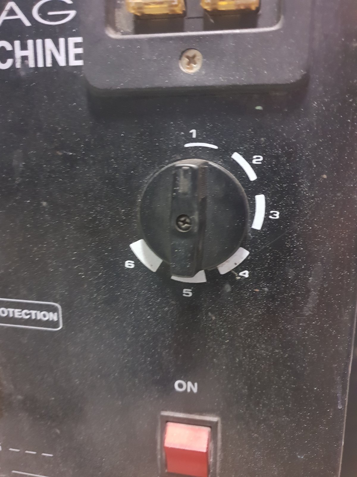

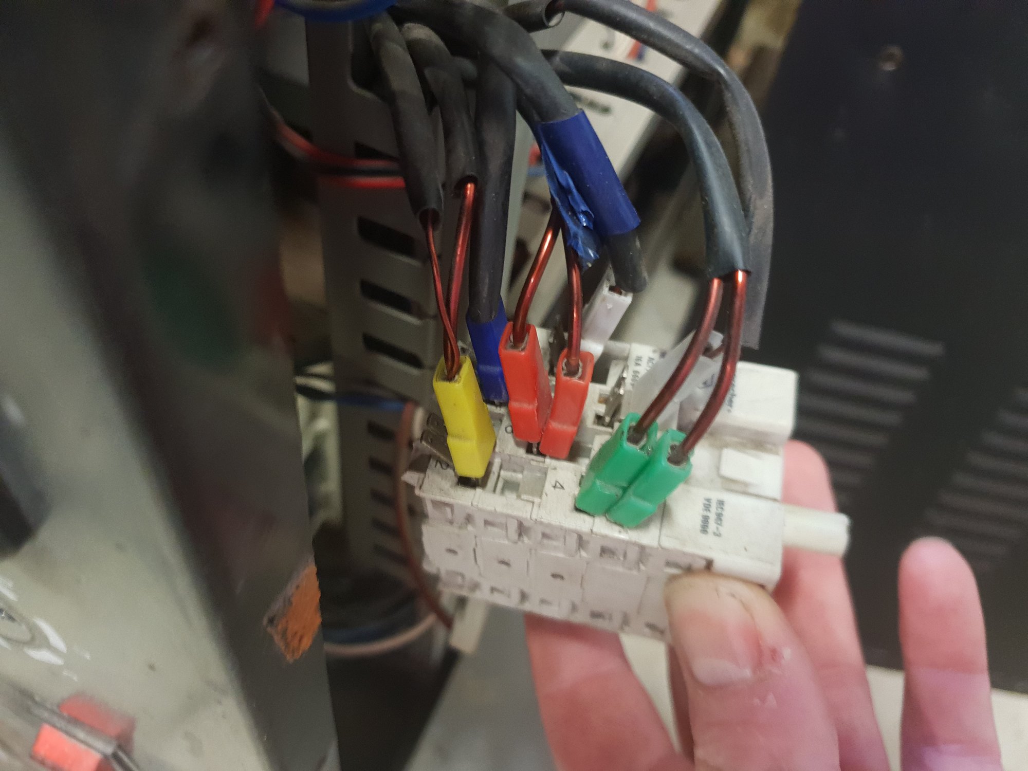

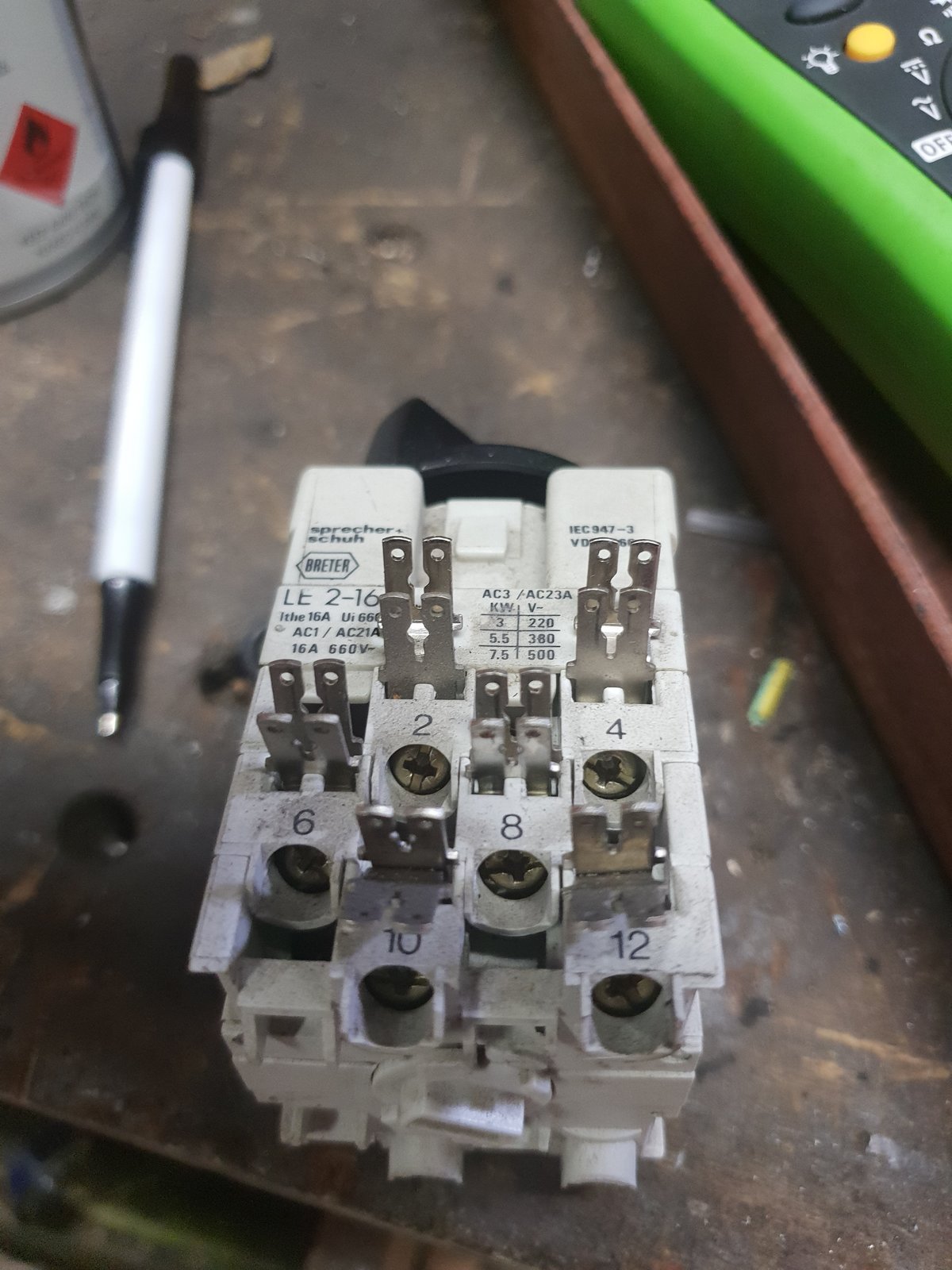

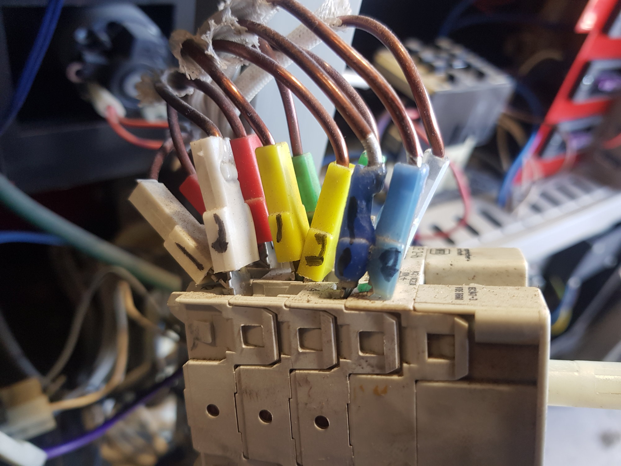

Right mate, took the switch out of mine and metered it, as you can see it has even numbered outputs 2,4,6,8,10,12 with all the odd numbered inputs linked together on thr other side, so here is how the outputs correspond to the power selector number.

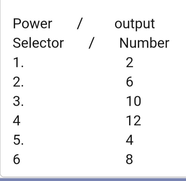

Power / output
Selector / Number
1. 2
2. 6
3. 10
4 12
5. 4
6 8
