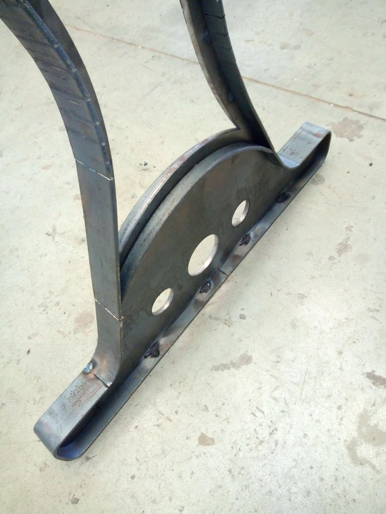

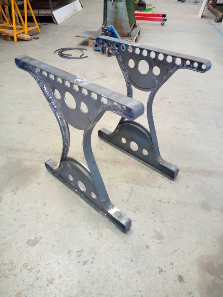

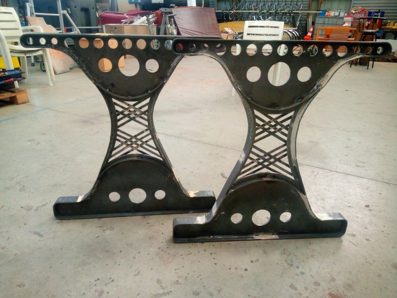

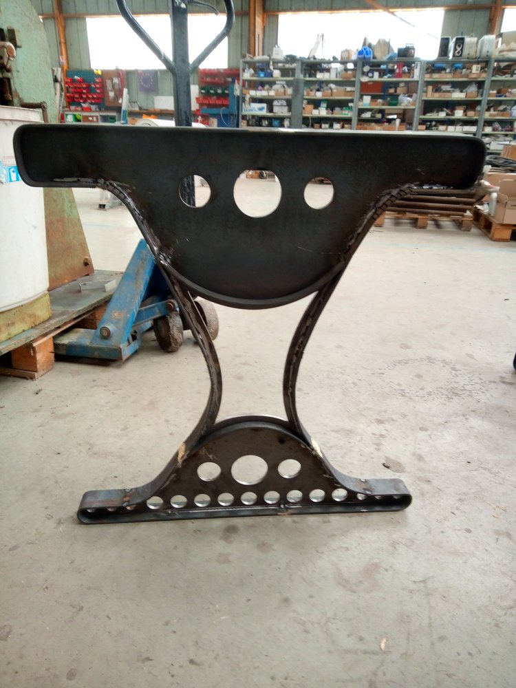

Thanks KF.Looking good, your prob is going to be making the welds look even, if it matters?
I like the way that the bottom curve leaves the exposed edge proud, going along with the curved vertical bits above.
No mig available here, and I don't have a gas bottle for mine.Obviously this is a learning curve and the balance between 'Industrial' and what can be done for a one off is limited. I would try and keep away from Isopon ;o) and just tidy up the welds a bit with the grinder (flap disc) Even stitching with the mig looks good, but equally well with stick. In some ways, stick might be better.

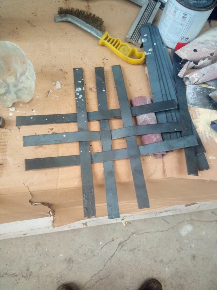

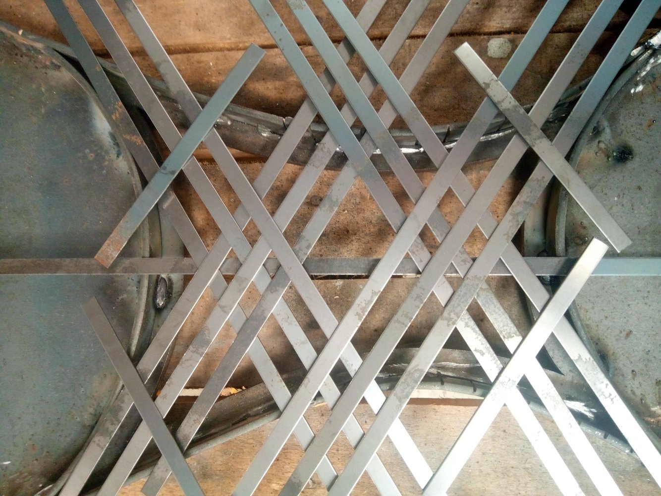

Well I followed your advice, quite challenging to weave, photos later.Under and over 20 x 3 flat bar plugged welded.
.... photos later.
It didn't work, was not aesthetically pleasing. Going for finer and thinner next week.Is it later yet?

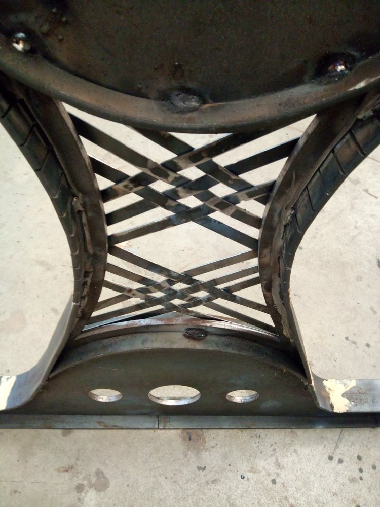

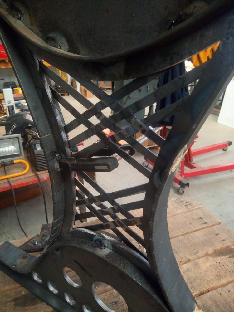

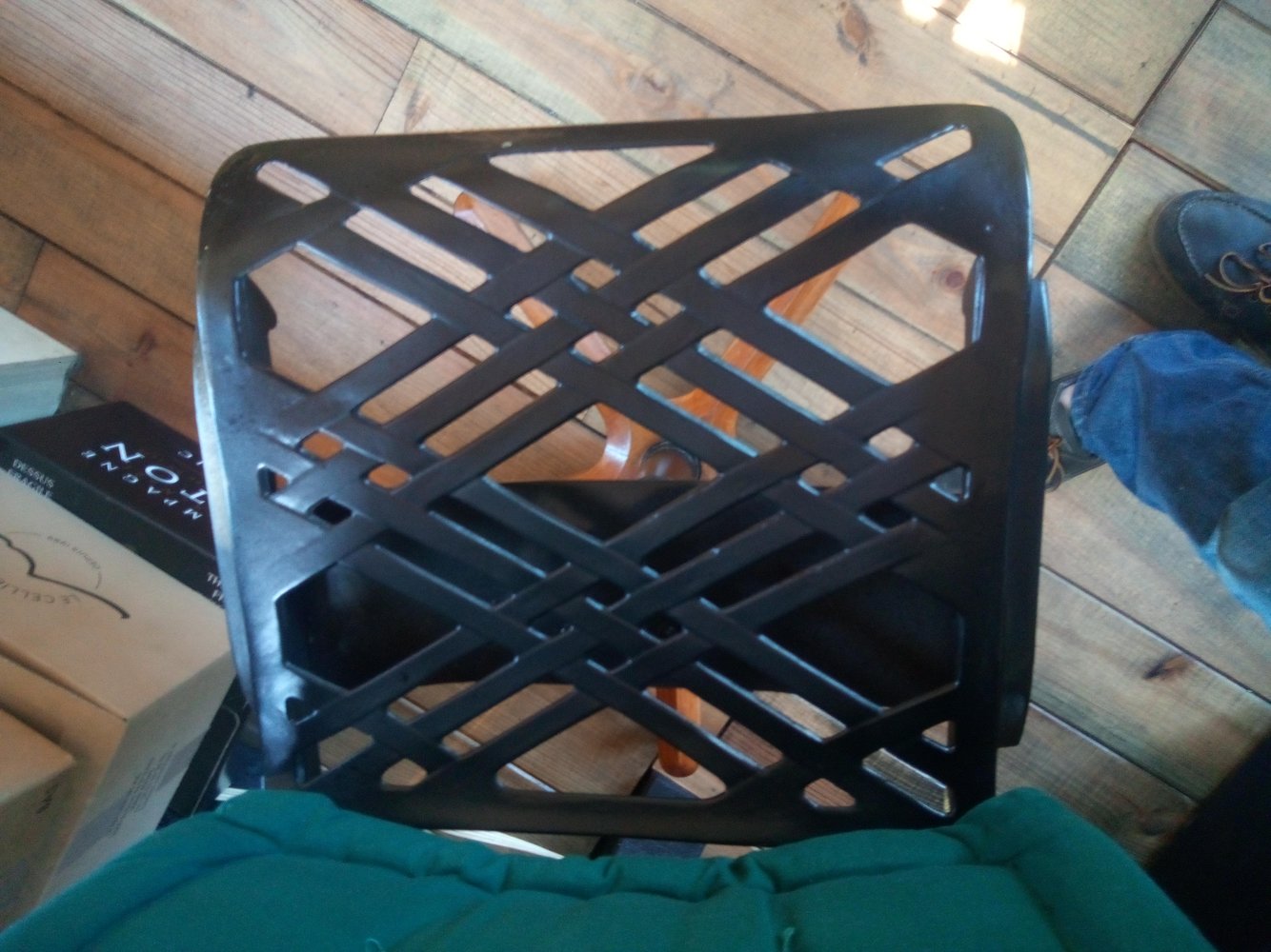

(This was quite tight knit 20 x 3 mm, I persevered, but after half an hour, I was like, not only is this not going to work, but doesn't represent the wanted look, so I stopped, and returned to the client for a chat.I did some radom latice with 16x 4mm. Unfortunatley my stockist doesn have it any more(

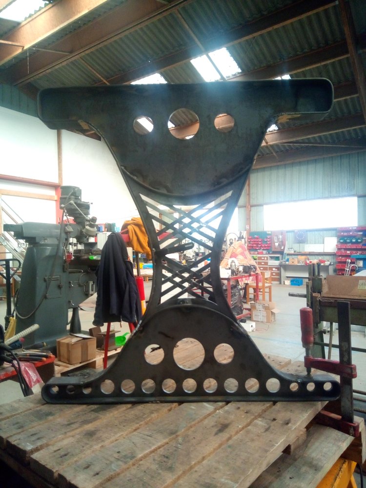

Tubes and nuts should be coming this week, hoping to get this finished by Friday, and deliver Saturday.Looking good!
But be careful one of those doesn't fall on you! Flat Matt = no good...
