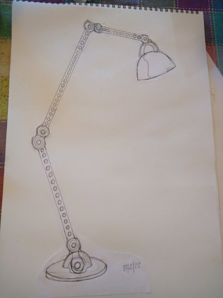

Todays Idea.
Floor standing lamp.

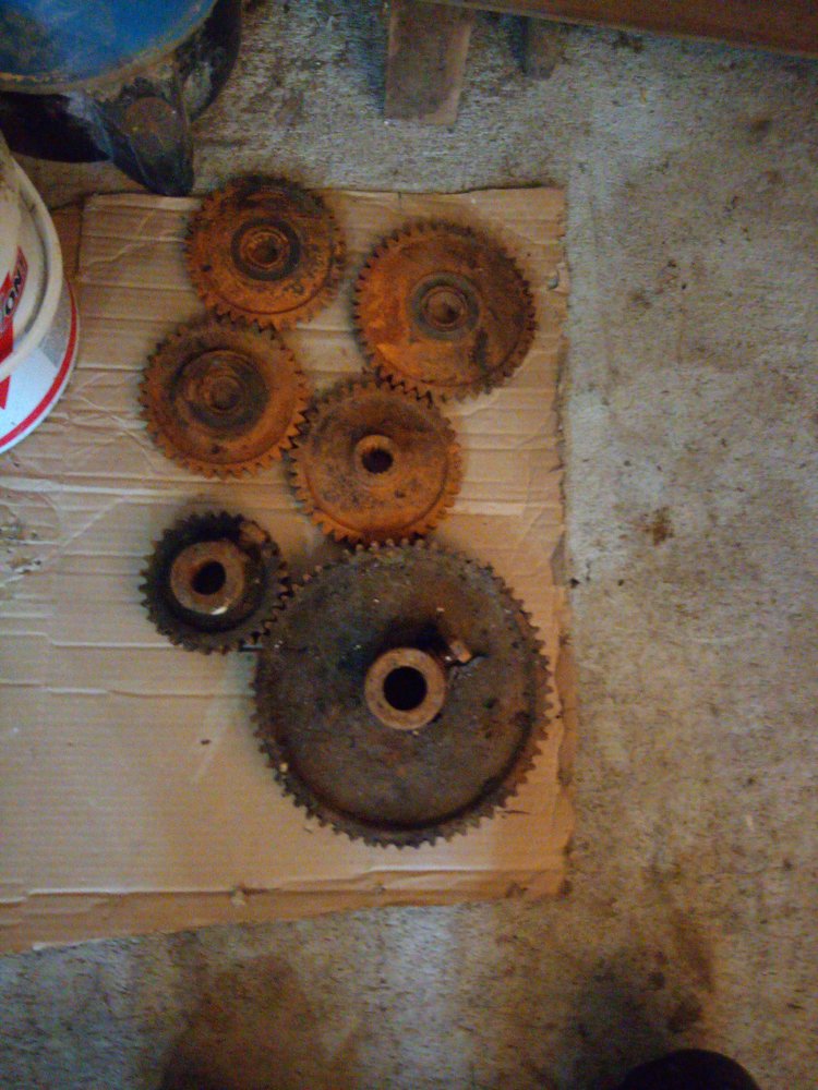

Hmm, thinking trampoline springs, or maybe gas struts, just playing with ideas, got these cogs, for the articulations.I like that. A heavy anglepoise with good position locking is a rare beast.

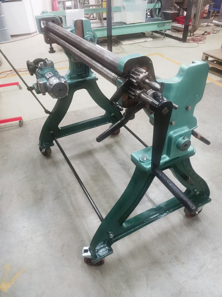

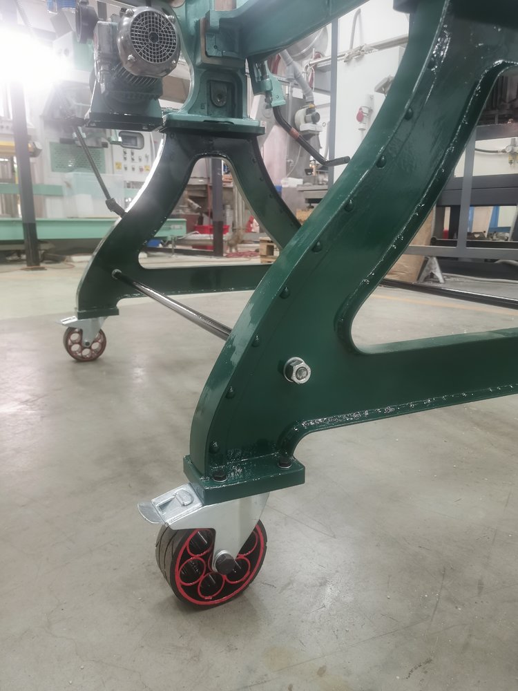

Well, I like your legs.Recently I solved a similar problem - new legs for the plate rolling machine
I looked at a lot of photos of old Victorian machines made of cast iron. I wanted to repeat the spirit of the style from the available materials available for processing. My capabilities are plate rolling machine, plasma cutting, angle grinders, MIG / TIG welding and other little things.
I rejected the method of repeatedly cutting a strip of steel, to give curvilinearity. Previously, I tried this method, it is not accurate and labor-intensive.
PS - I'm not going to clap your hands to your design, sorry. It is devoid of any functionality or reminder of functionality.
View attachment 332749 View attachment 332750

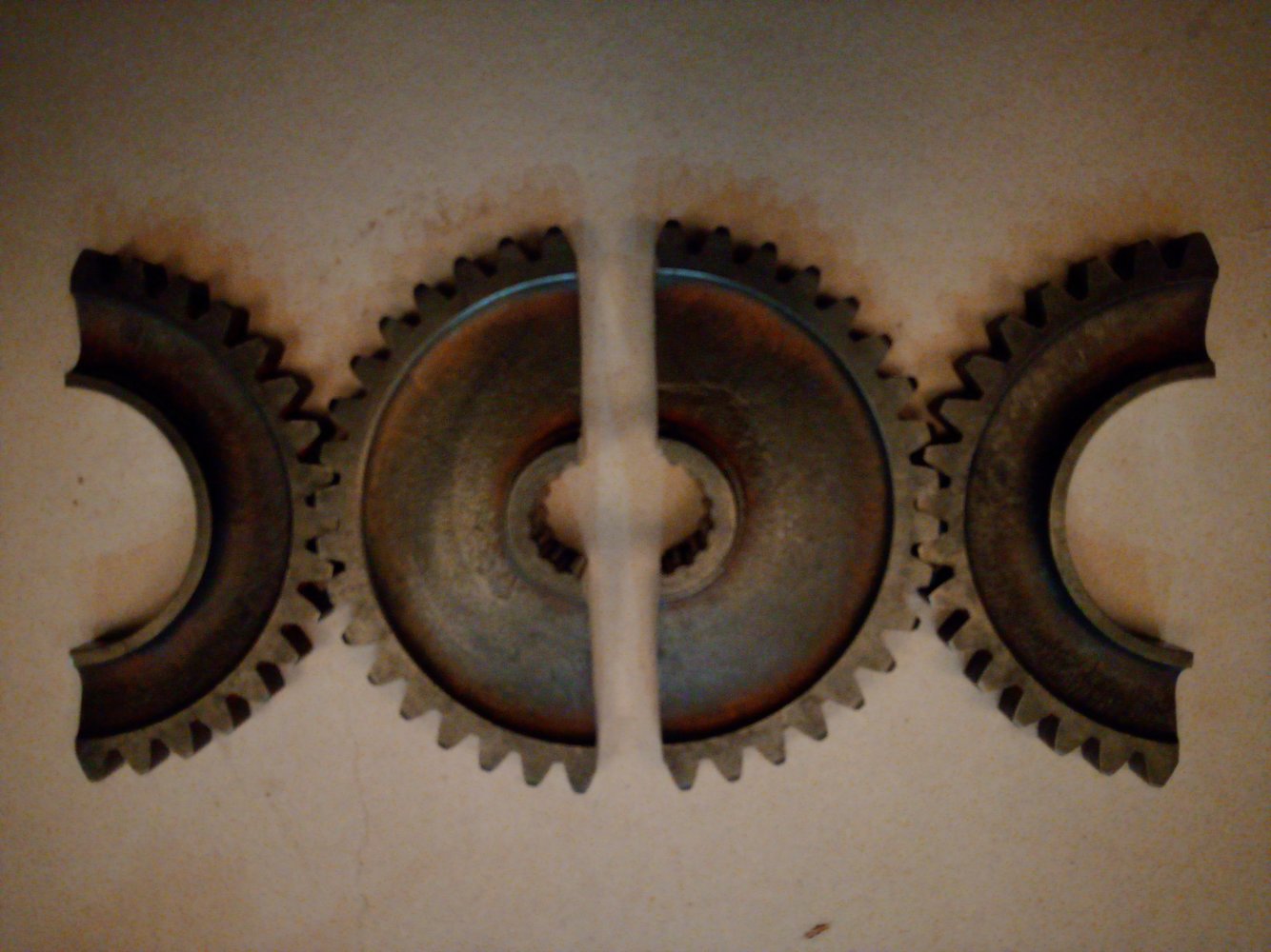

Gave those wheels of steel a little brush up, angry grinder split them in two.

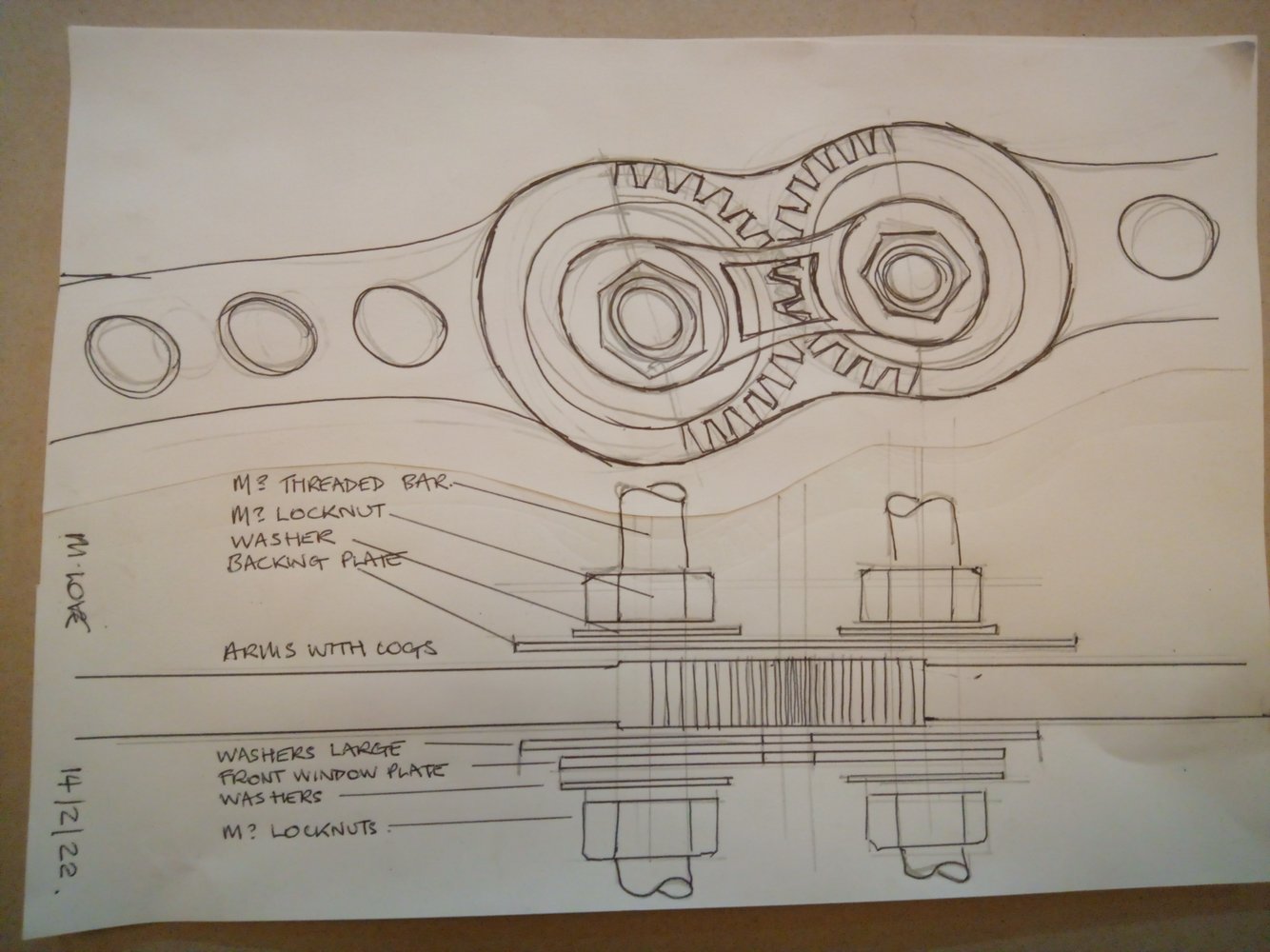

I've been thinking about the articulation, so drew this up on CAD, as @selectedgrub would say.
Just throwing ideas around.
