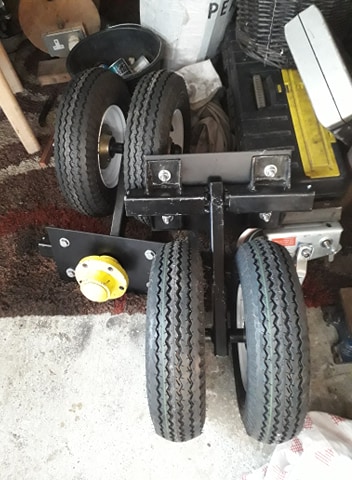

Trailer is one of these sort of things -
...but,
a) not ifor williams, but probably an ex-council plant trailer
b) much more rusty (chasis is fine, sides have a few small holes, no base at all)
c) needs a new jocky wheel
Im thinking that -
£260 for the suspension units
£50 for a decent ply base
£25 for a jocky wheel
£15 for some paint
...what's that - £350?
Do i really want to spend £350, or should i scrap it and buy another - either another disposable, or double my money and get a decent unit. As i say, it cost me £80 a few years back.
I could chop the units about, as per this thread, but i want decent loading, an im loath to put in a load of effort, and fit a new base, just to find theyre as bad as they were before.
