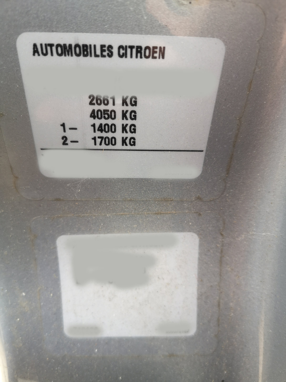

GVW is 2661kg
Train weight 4050kg
Difference of 1389kg, bit of an odd number, but the way i interperate that your van has a max towing capacity of 1389kg regardless of license type

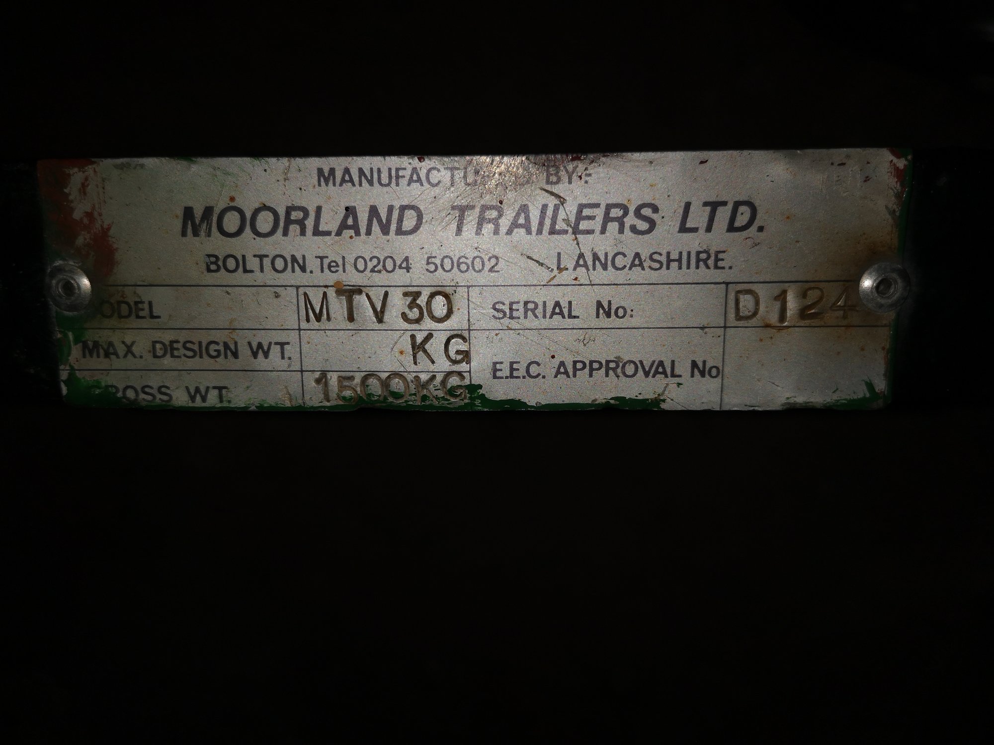

So if you loaded your 1500kg trailer to max it would be illegal, I await correction..
