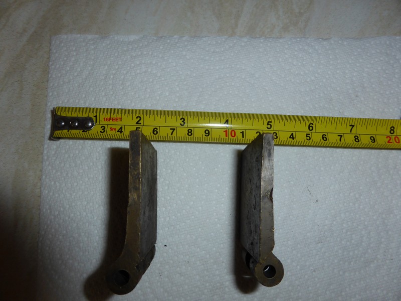

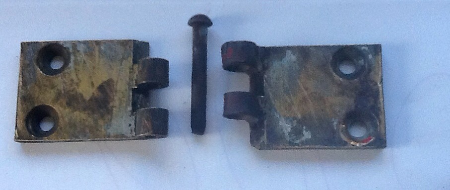

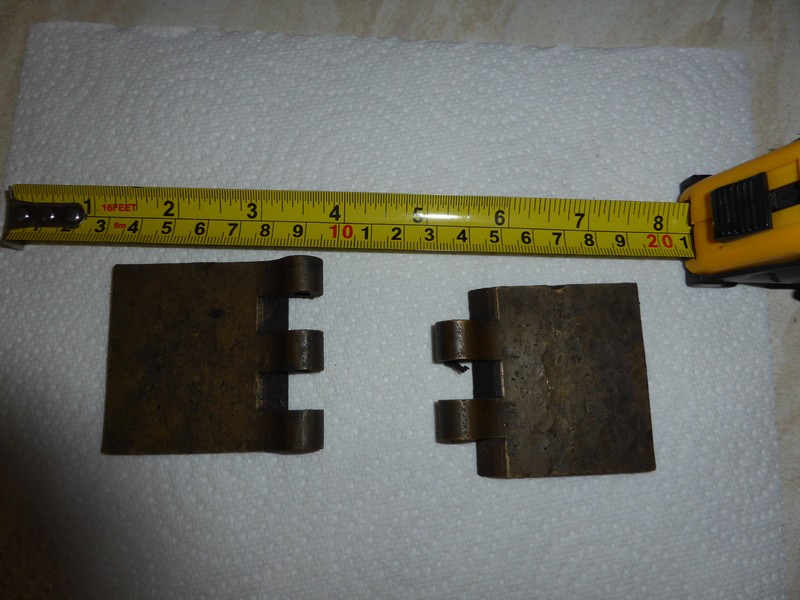

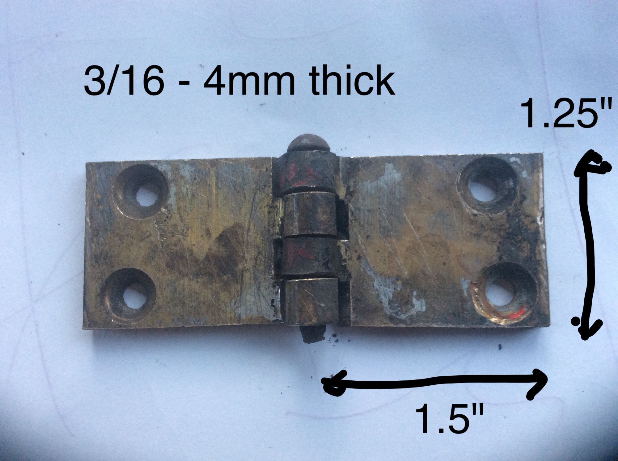

Did some A7 ones recently as said silver soldered & re drilled hole with new pin shimmed the knuckles to remove the drop not a biggy, the A7 hinges have a large No. of variations & as mate had all the same wanted to keep originals.
He had a rummage in Bristol A7 spares shed
