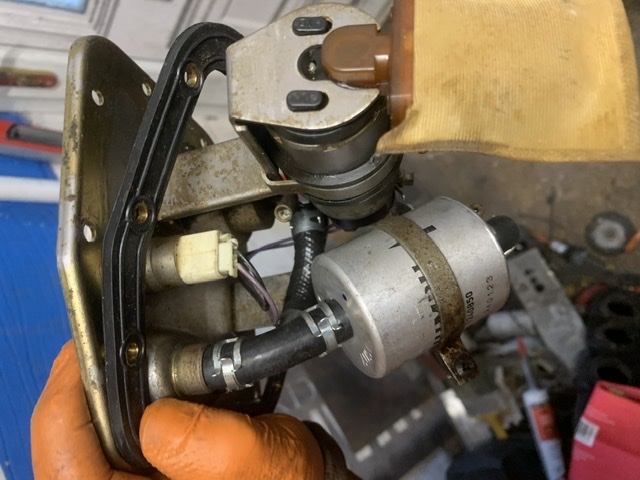

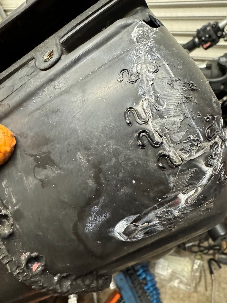

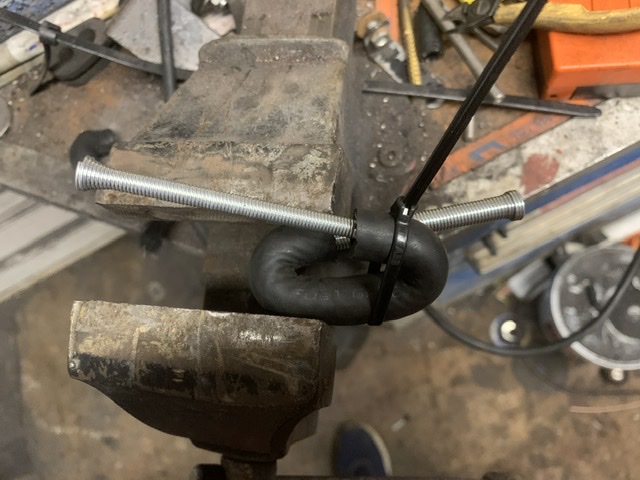

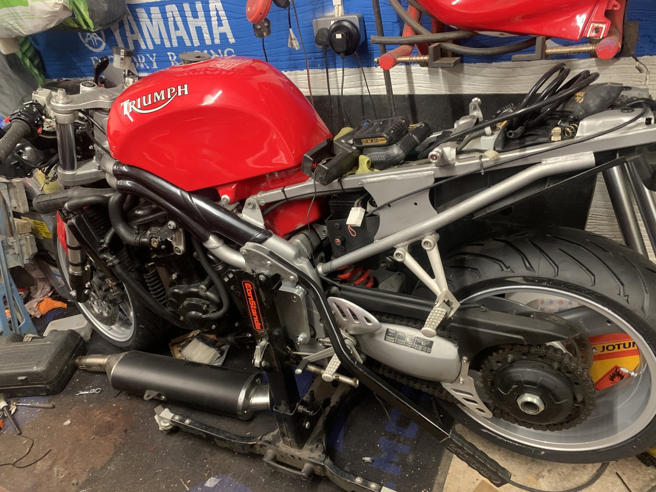

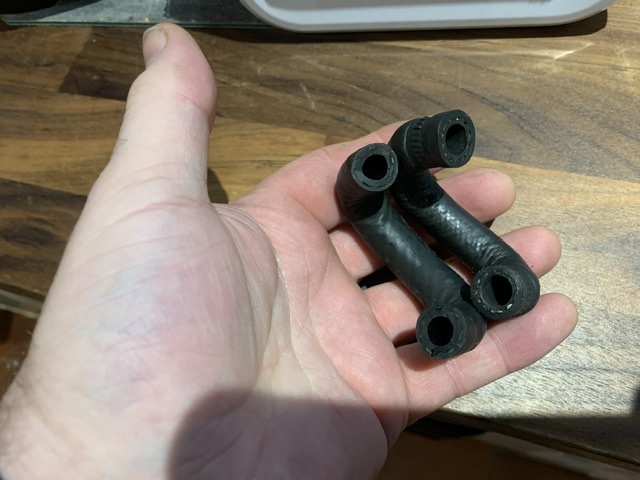

Cleaned up the base plate a little then refitted. Interestingly Triumph supplied a modified feed pipe for the in line fuel filter as you can no longer get the shaped pipe…..more on that later. They also modified the flow direction for the filter and gave it a new updated part number so you don’t need to tweak anything to get it out due to the crimped edge, it just now slides in from the other side.
