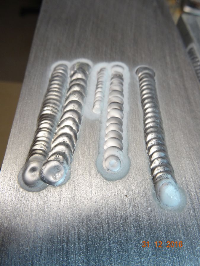

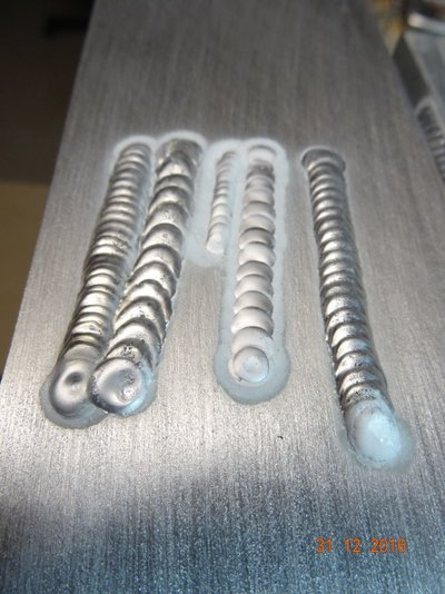

Then it should work and I will build a nice little welder cooling cart hopefully from it.
Maybe out of alu to make the first useful aluwelds in my life.
