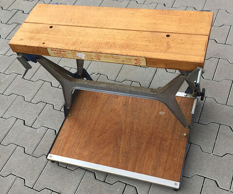

WM 325 TYPE 1 M8 thread on the feetThat’s like mine, also was my fathers. Must get some new feet for it sometime, been saying that for 30 years![]()
Last time I had a look, some years ago, the old ones were well seized. Must remember to give them a soaking.WM 325 TYPE 1 M8 thread on the feet

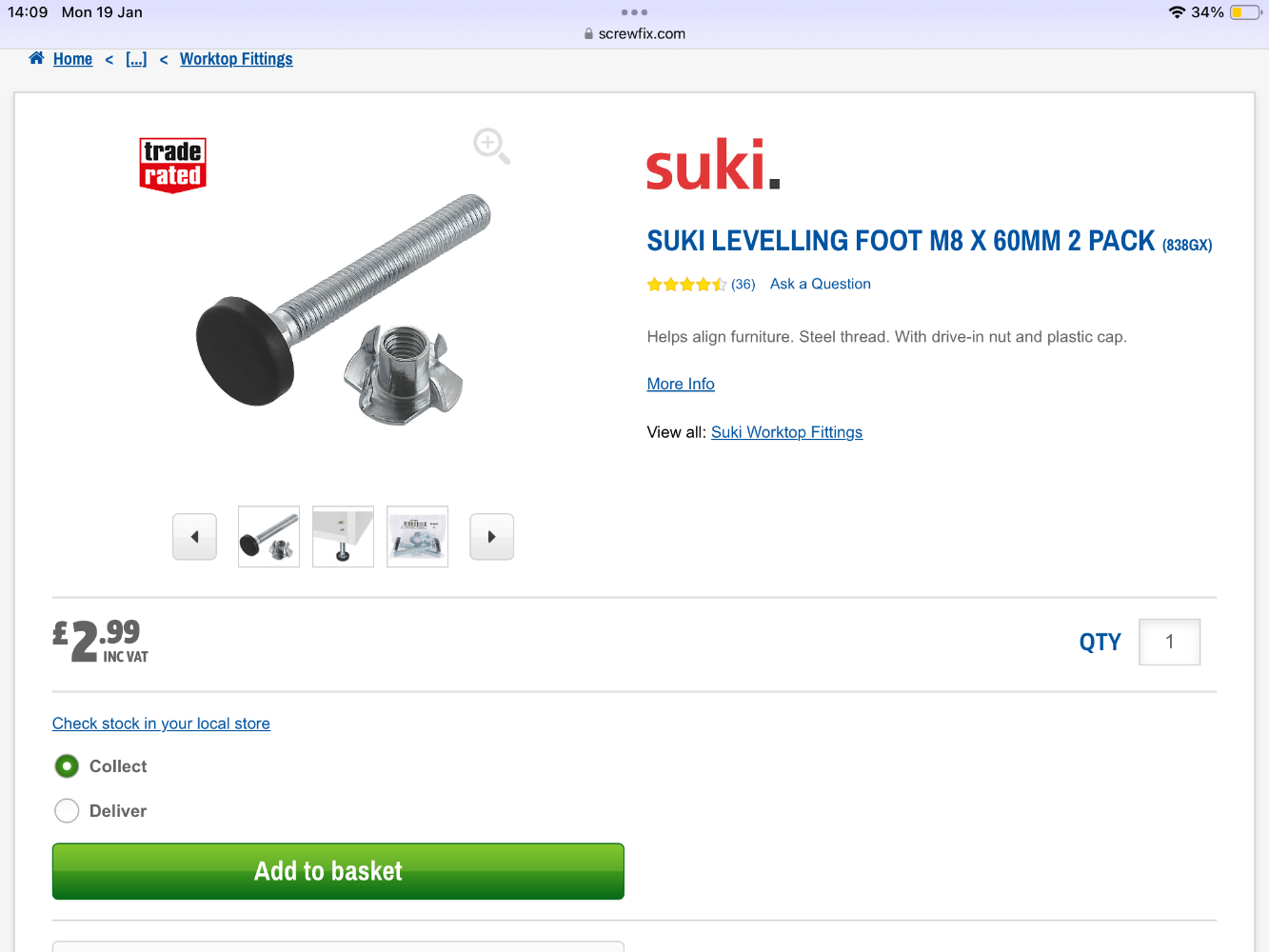

) a cut in half RH orange vice handle knob.Well, I tried to remove the old foot, heated it up came for a bit, then the lug broke off the workmate, so it’s permanently unajustable now, unless someone local can tig it for me.I’ve just checked & yes they are M8 thread. Googled workmate feet & these came up, can’t see why they won’t do, local Screwfix has 5 sets in so I’ll use them if I can get the old ones out.View attachment 527216
Bummer I am soaking mine they are locked solid thats the trouble with steel long term in ally. it won't weld I don't think, the frame is actually crap ally. Mazak castingWell, I tried to remove the old foot, heated it up came for a bit, then the lug broke off the workmate, so it’s permanently unajustable now, unless someone local can tig it for me.
Can you use a bit of bent over a tad angle iron pop riveted to the leg to make a foot if you can't get things welded ?Well, I tried to remove the old foot, heated it up came for a bit, then the lug broke off the workmate, so it’s permanently unajustable now, unless someone local can tig it for me.
