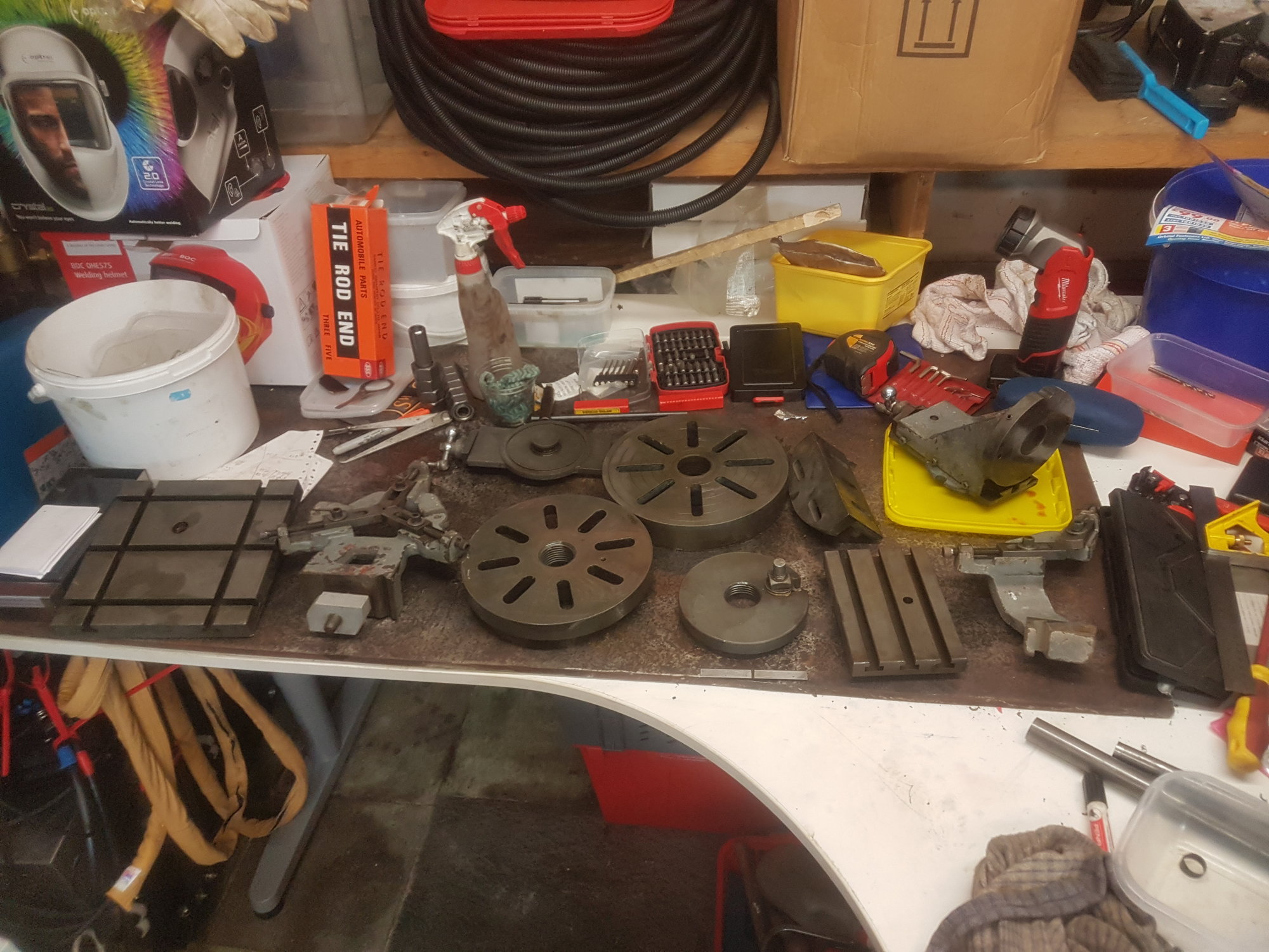

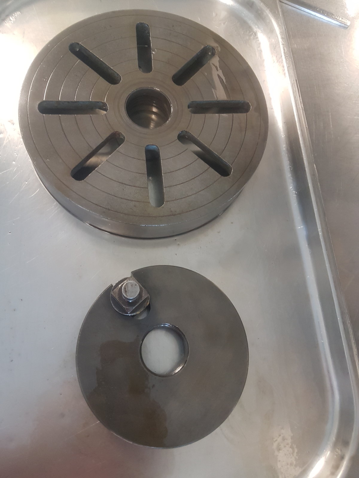

It's a catch plate. Used for driving the workpiece when turning between centres.
Using a lathe dog.
