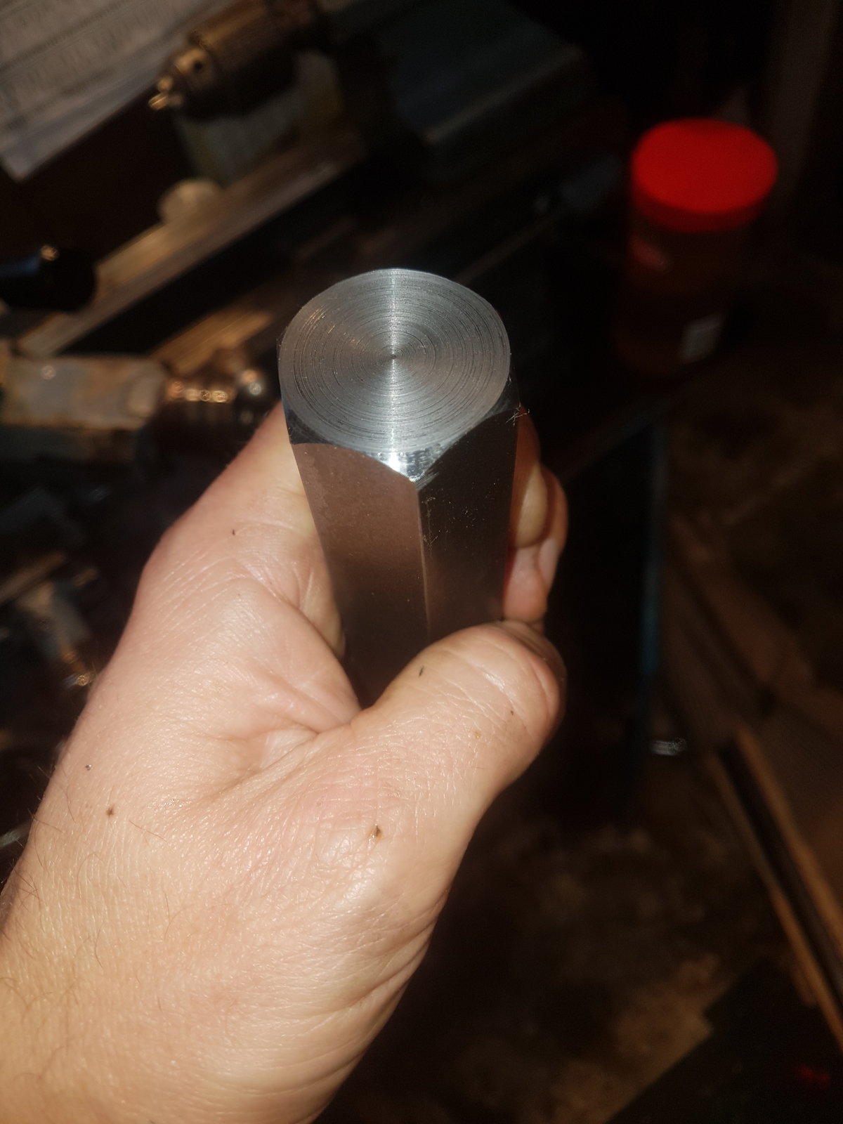

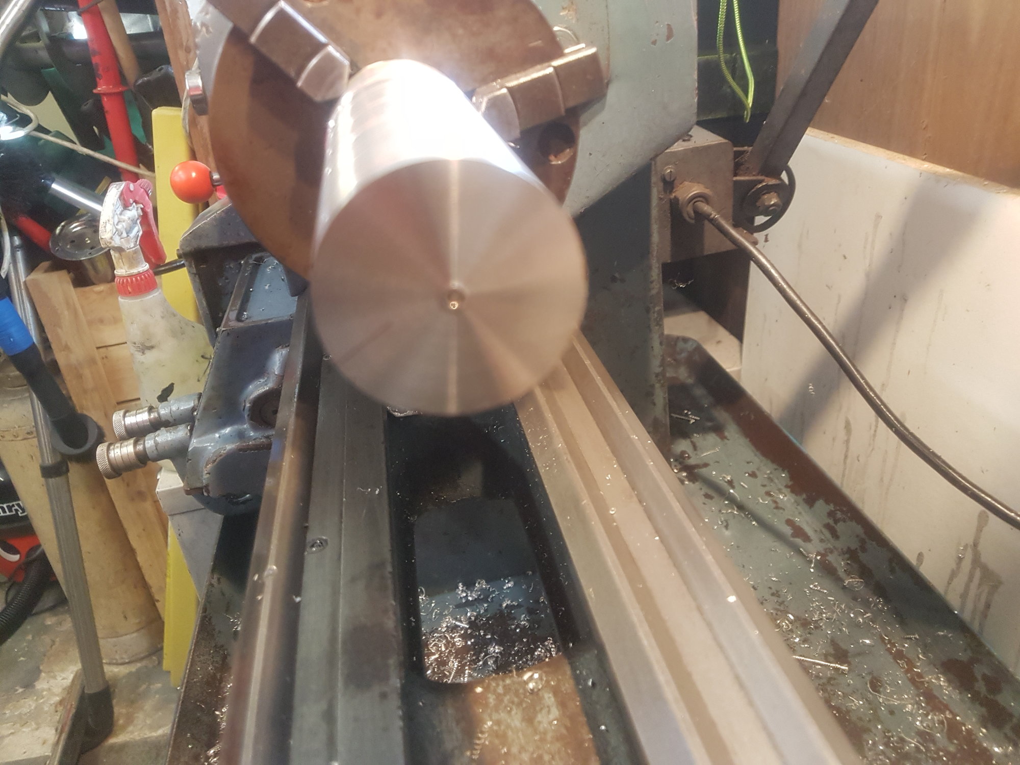

See the little pip in the middle.
That shows how far off center height your tool is
because when i get to the center it leaves a nipple,
Because the tool is off centre.
I would wait until Brad gets down as I can see an accident about to happen here and you are going to hurt yourself.
That stock is only a moment away from flying free from the chuck without a centre holding it at the end!

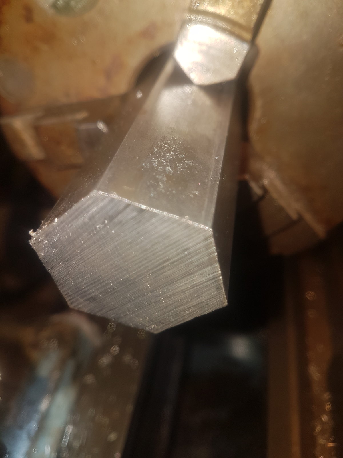

So I need a bigger chuck for bigger stockIn the picture where you are holding the bar in your left hand, do you notice the two (well 1 3/4) rectangular marks in the bar end from your chuck jaws?
That is how much is being held securely. If your tool digs in the rest of the bar will try to move around the tool.
Depends what you mean by bigger stock. As long as enough of the jaw threads are engaging the scroll it shouldn't be an issue.So I need a bigger chuck for bigger stock
