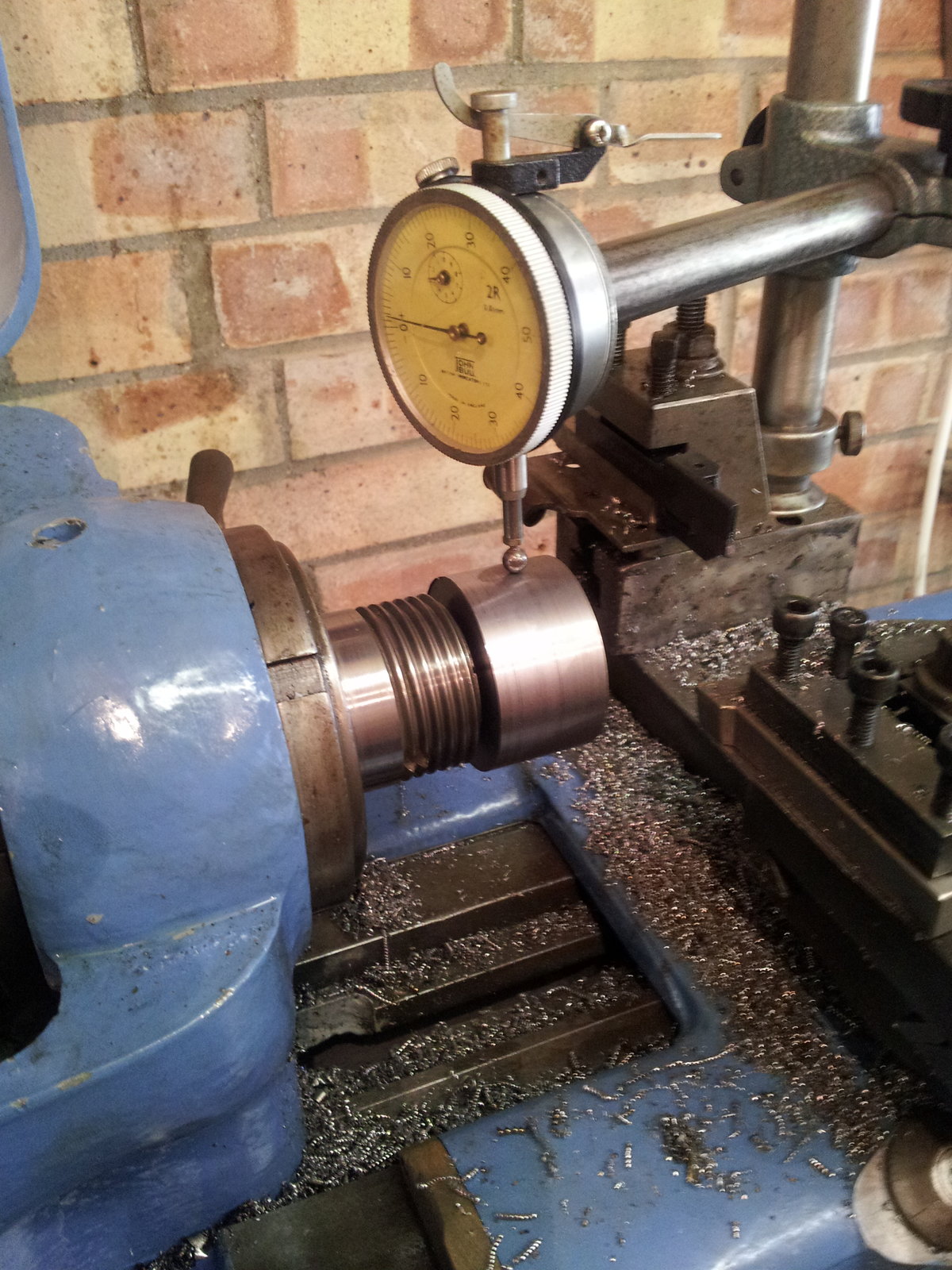

I am ready for a lesson now Pete
It may well be the chuck I did chuck it up 3 times. I shall try something elseIt may not have chucked up true in your chuck.
Use that dial gauge on a piece of precision bar like a drill blank etc.
Unlikely there will be too much wrong with the chuck mate.It may well be the chuck I did chuck it up 3 times. I shall try something else
I shall try that tomorrowStart off just facing your bar mate.
Adjust your tool to meet up with the centre of the bar.
Get your tools all set up centre height properly.
That’s going to improve your cut quality loads.
Just because it's turning true at the Chuck doesn't mean it is at the unsupported end.had a go on some ali bar Saturday too, is it possible for the 150mm of bar to be bent as when turning it was 1.5mm out of round
Setting my motor rotor in the fixed steady the other day did too.
Ended up sticking my dti base to the spindle and extending it as far as possible.
A three jaw never holds something absolutely true.
There may be a piece of junk in the scroll on the chuck. Easy to strip and sort.
Get it close.
Take cuts until you have fresh metal the entire length and diam then mic it.
Abom makes clocking parts in look easy.
Takes practice.
Had a mare clocking parts in for eccentric turning. Made me scratch my head a few times.
I would have thought 50mm ali bar would not bend with a 120 mm stick out
Put a DTI against the back end of the bar when it's mounted, then just push the end towards it. You'll be staggered at just how much deflection you'll get.
Wasn't ideal I clamped the mag block on and made sure everything was as tight as possible.Be very careful when swinging a DTI around on a spindle/chuck/faceplate to centre stuff. One of the demonstrations at the scraping class is to put a mag base on a small surface plate with a dial gauge reading off the face it's stuck to, then turn it over. The reading can move 10 thou just from gravity bending stuff. This is why you should not swing a DTI around a tailstock ram to centre it.
