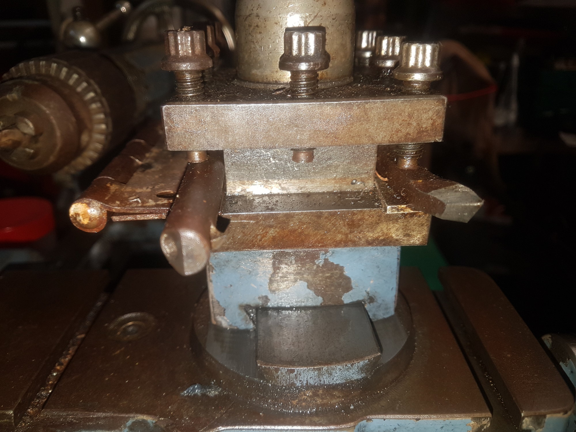

ok so do I bother purchasing a few springs, ball bearings and wrench for my current tool post holder or do I pay out for the QCTP

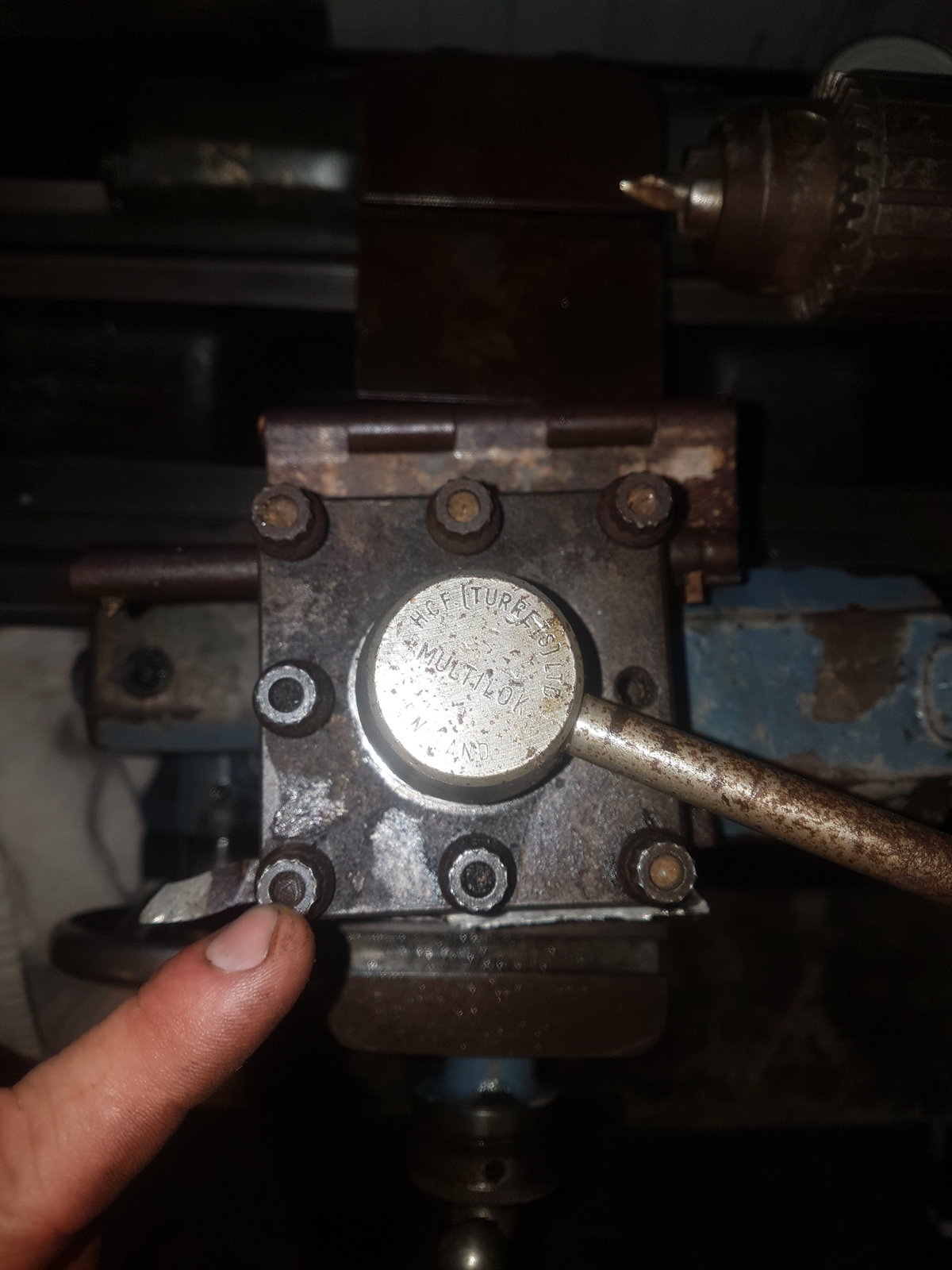

they are under the 4 way tool post makes moving it around between tools smooth, It does work with the missing ones it could just be smootherWhere are the springs / balls located? My Mk3 didn't have any. If they are to position the tool post are they needed?
Yes that is exactly what they are I will have to get the calipers on them and have a measureSo they are basically lift springs and balls. What diameter / length of hole in the toolpost? How many?

Does a ring spanner not fit, or change for cap screws.I also need a spanner for these bolts
i shall try later I do not have many imperial spanners, And I defiantly have no imperial cap screwsDoes a ring spanner not fit, or change for cap screws.
