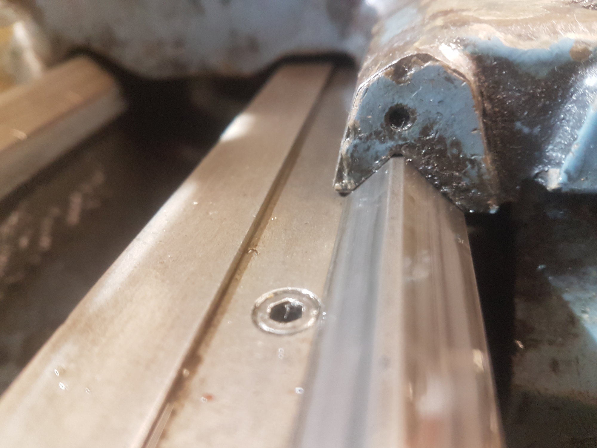

The tang snaps off, so it's not a problem. In fact, you always snap the tang off to stop the stud or bolt jamming on it. It is 2BA I believe (may be 3/16 Whit. though)
just googled dog point, well the one in there was a normal bolt that explains why it was hard to remove from the stud, I cleaned the stud up with a file now it slides on and off lovely. I guess I need to turn the end of a normal screw down to make it a dog point that can be my first job on the lathe I guess!Make sure it's a dog point screw or you'll burr tthe stud and make removal difficult.

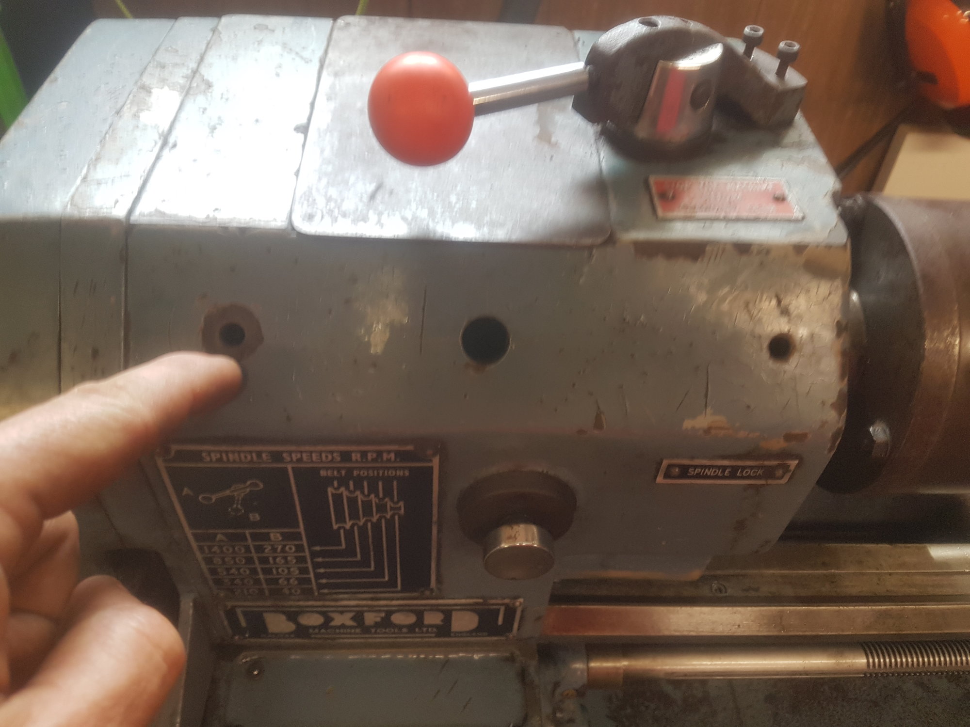

Thanks I will try a 4mm tomorrow. Any idea on the grease cupsfor the scraper hole most probably 4BA, but try a 4mm screw in it
Grease cups - no, but you could give Boxford spares a call / email if you don't have a selection of old bolts to try.
i will try a m8 later it looks m8 size but i am sure it will be imperial. I know nothing about imperial bolt sizes.
I inherited a large cantilever tool box full of old bolts and machine screws. Been invaluable.
Even just finding on that fits o hole to put a thread gauge on is helpful.
Added to it over the years as I've stripped things down.
There are no metric threads on the machine. Not at home to check at present but I think the graders may be BSF.
4mm will fit in But it will knacked the threads if I tighten it upfor the scraper hole most probably 4BA, but try a 4mm screw in it
