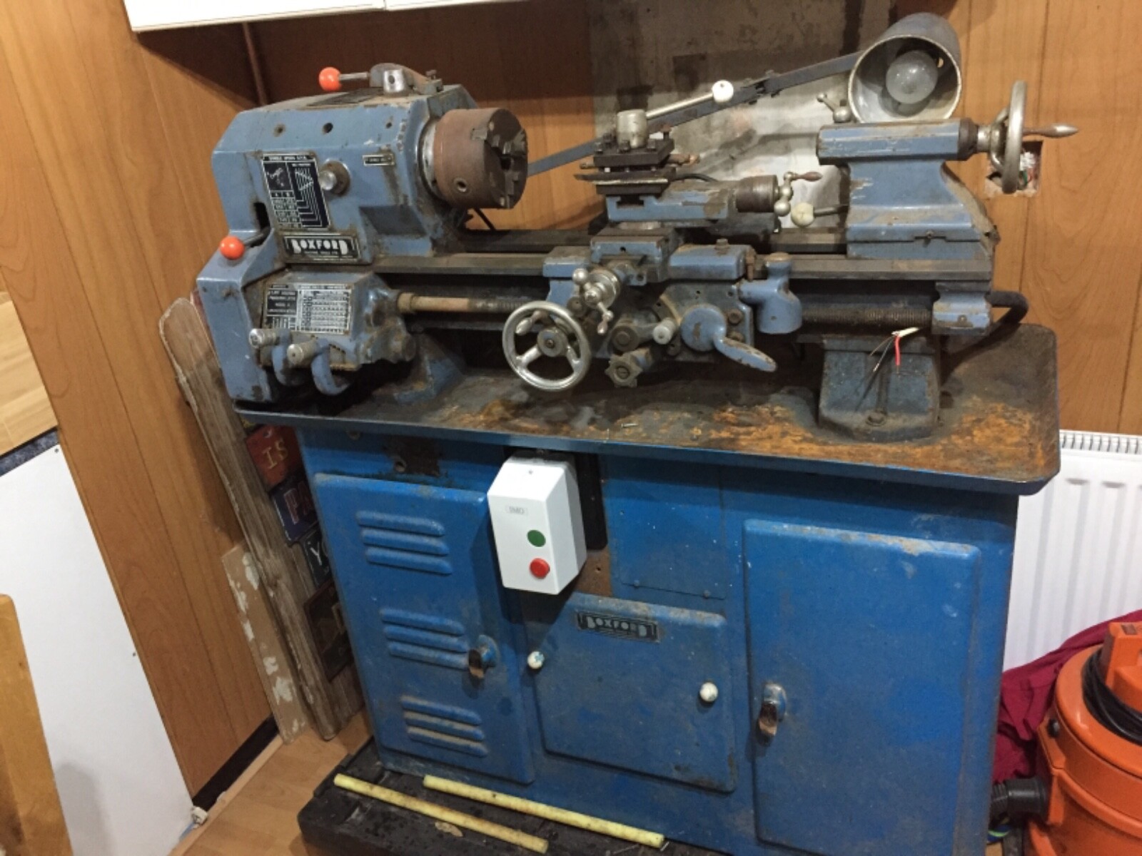

I use enamel paint. It's easy to hand paint. It's tough. And available in most basic colours.it could do with a lick of paint too what do you guys use enamal or just machine paint
are you sure it is not a model A?Nice lathe
It's an AUD

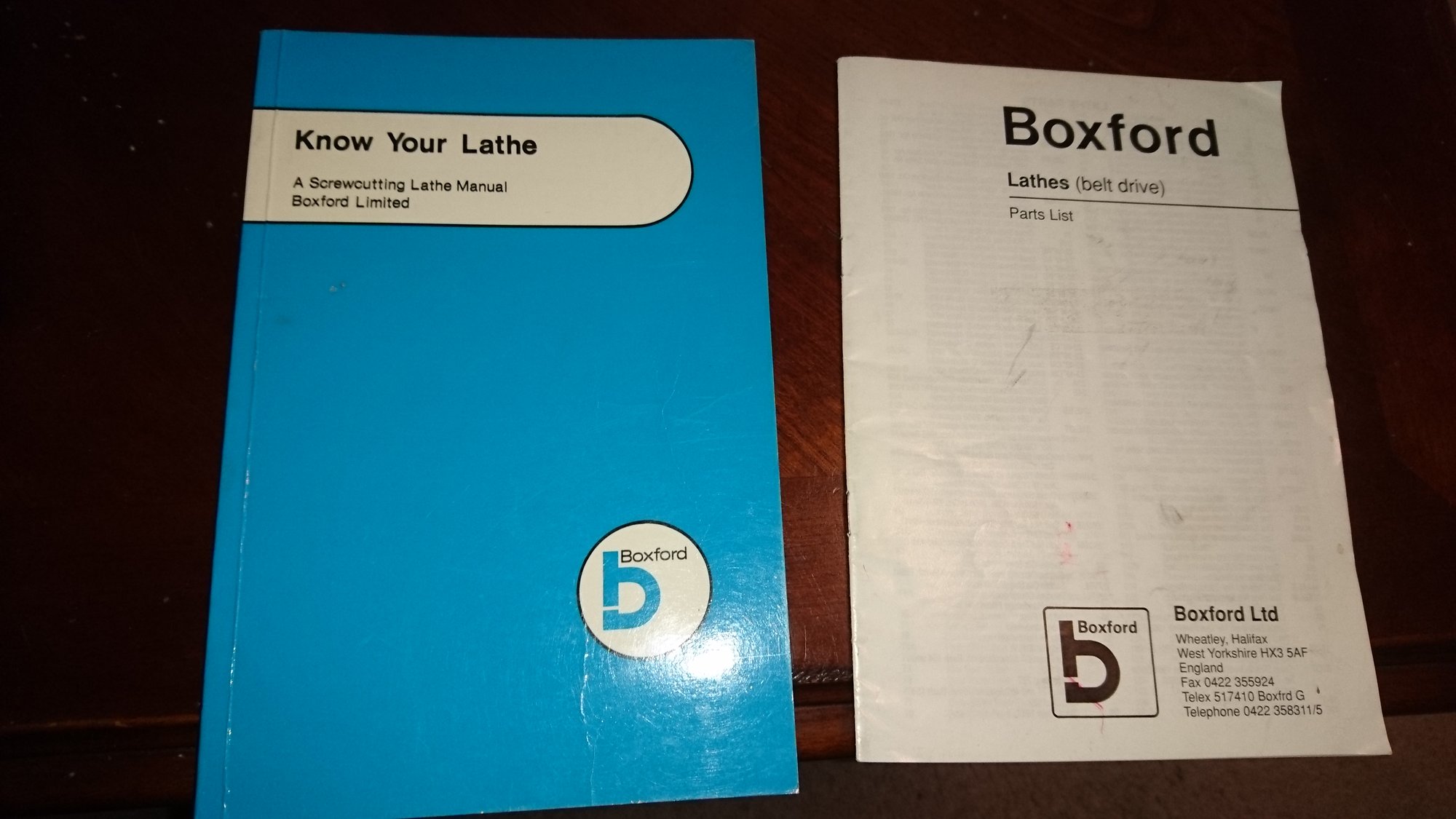

There is a book available - know your lathe by Boxford, - our copy is from 1988 - see photo.
It describes how to turn from the basics right through to screwcutting and milling all on the Boxford lathes and includes maintenance instructions etc.
Get the book, practice and then once you are up to speed refurbish the lathe (after you have made all the silly mistakes!)

cool i am off to look for those books on ebay right now so its a AUD i cant find a reverse switch on it though, is there a replacment gearbox for metric thread cutting

It's a mechanical reverse not electrical (lever just above the Norton gearbox and to the left)
If it's imperial (ours was) then for metric threads you need to switch the gear train.
You would need the 56t gear, the 127/100t compound gear and then whatever stud gear for the thread

Yes. Rust free. Nice and clean. Primer. Paint. Leave for six days.Thats what I was thinking I like tough, does it need to be completely rust free before painting
Should be ok.what is the prefered primer? I have some nice 2K acid etch here waiting to be used
Yes
Model A is bench mounted, model AUD is a model A on a cabinet (under drive - UD)
It should be shown on page 3 of the know your lathe as from the download link above
is there a table or list ect for this info?
Know your lathe page 75 in the above download
thats great to know thanks so I just purchase these gears and swap them out do I.
the red lever next to the boxford lable is it for reverse?
wicked it even tells you the gear posistion to select on the box! does the lathe have these gears already or do they need to be purchased seperatly
