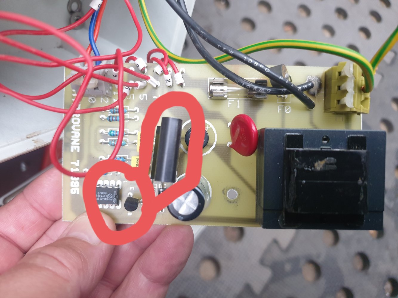

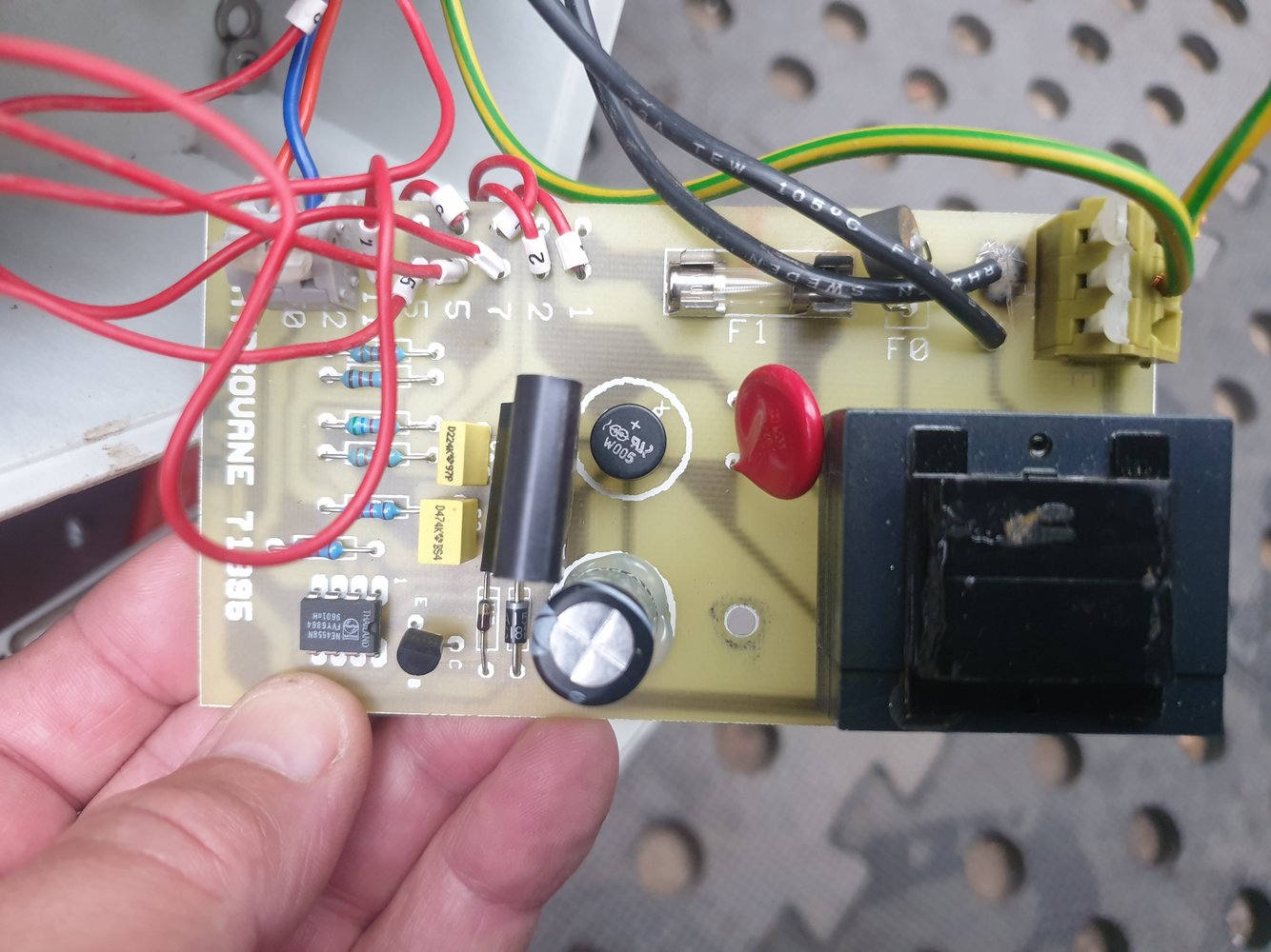

From where it is wired, just after the bridge rectifier, I would guess that the component with the heatsink is a voltage regulator.did you have any luck regarding the component with the heatsink?
Looks like a voltage regulator to me as well; input on pin 1, ground on pin 2 and output on pin 3. Possibly something like a 7824 or similar? I also think that BC377 is switching the contactor and it does seem a bit weedy!From where it is wired, just after the bridge rectifier, I would guess that the component with the heatsink is a voltage regulator.
That leaves the tiny 1-Amp BC377 as the output switching device, responsible for enabling or dropping-out the contactor in the event of overtemperature. It seems a bit wimpy for that job...?
OK mate thats great. I may look at swapping out the bc377 for something stronger.Looks like a voltage regulator to me as well; input on pin 1, ground on pin 2 and output on pin 3. Possibly something like a 7824 or similar? I also think that BC377 is switching the contactor and it does seem a bit weedy!

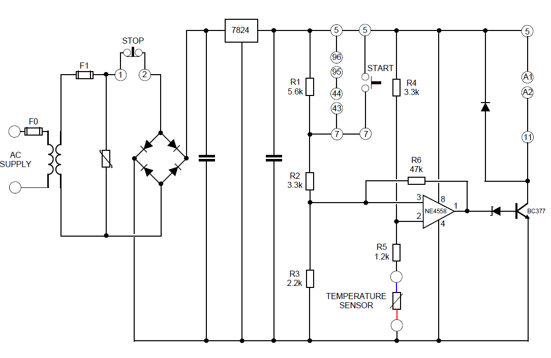

Should hopefully have the circuit sketched out later tonight or tomorrow
It might be worth repeating these if you used 23 for your negative multimeter lead, try using either the point where the red temperature sensor wire is terminated or pin 4 on the NE4558 as your negative point and set your meter to DC volts. The readings you got seem fine though , pin 7 rising to 24v when you press the start button suggests the power supply on the board is all fine and that 24v from the start button is going straight into an input on the NE4558. The output of that should switch the BC377, which in turn will ground A2 and energise the contactor. As that's not happening, I'm wondering if it's a temperature sensor problem, although it seems to measure ok. I reckon it could be a thermistor and from what I can see of the circuit, it's resistance will increase with temperature. So a quick test to discount that would be to remove the red & blue wires from the connector on the board and insert a wire link across the terminals. That will simulate a really low temperature, so try that and see if it runs?Afternoon so I'm sat testing the box volts are as follows.

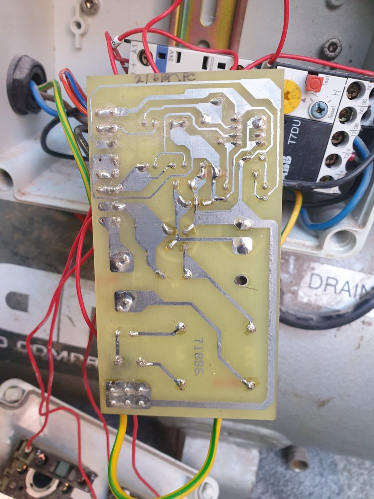

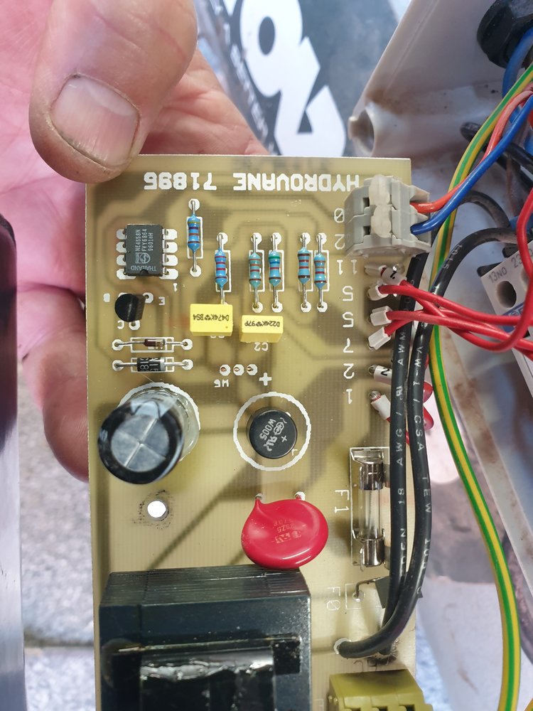

OK so pics of both sides. I know both black wires are live and neutral. Helpful you'd think brown and blue would have been better.
