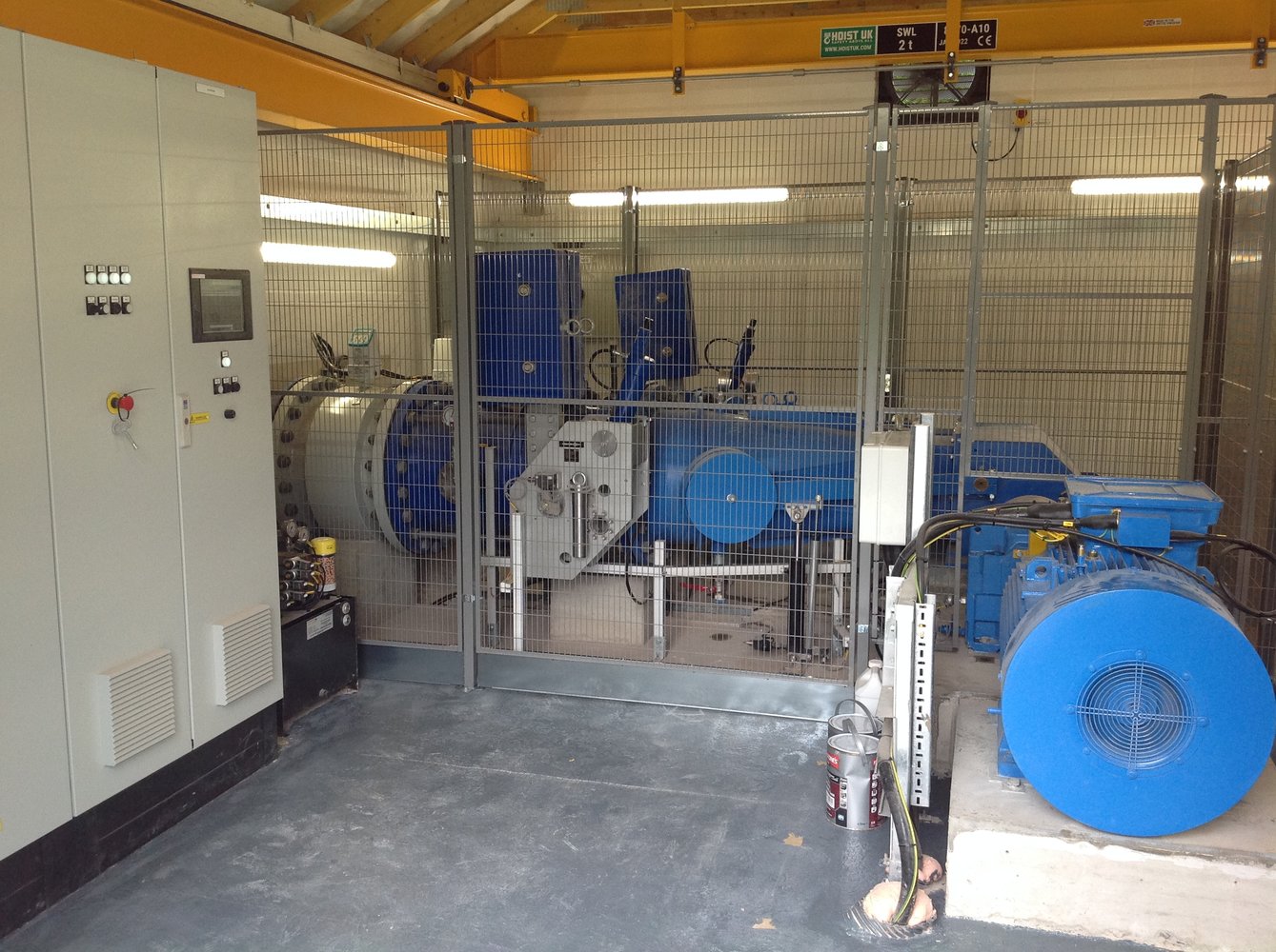

I like the control cubicle. What HMI system are you using or is that confidential? I design control systems for a living so interestedYour sums are wrong. Energy given, gather than just stored needs flow. You’ve double counted height.

I’m not making this up, I do it every day, and have done for some years noView attachment 386745
A couple I built earlier...
