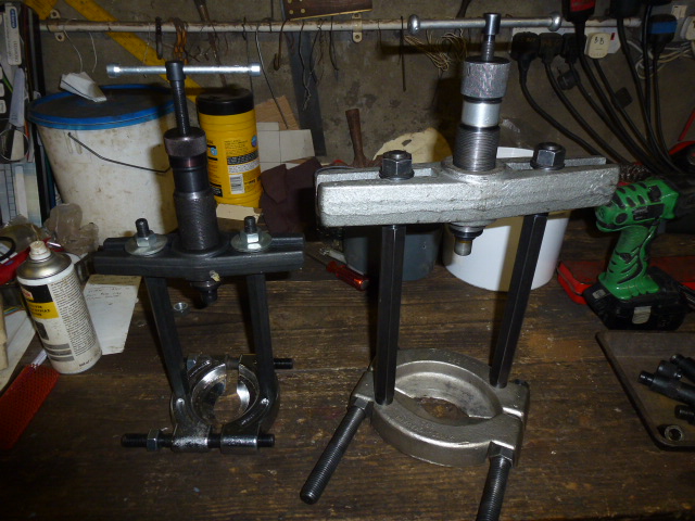

I can't see why rubber grease would be suitable for a puller, a good quality general purpose grease seems appropriate in my mind. Longlife complex, high temperature stuff from Morris never seems to let me down.
Choosing the grease by colour was tongue in cheek, I'm well aware that the colour in grease is just whatever dye the maker has chosen to add.
