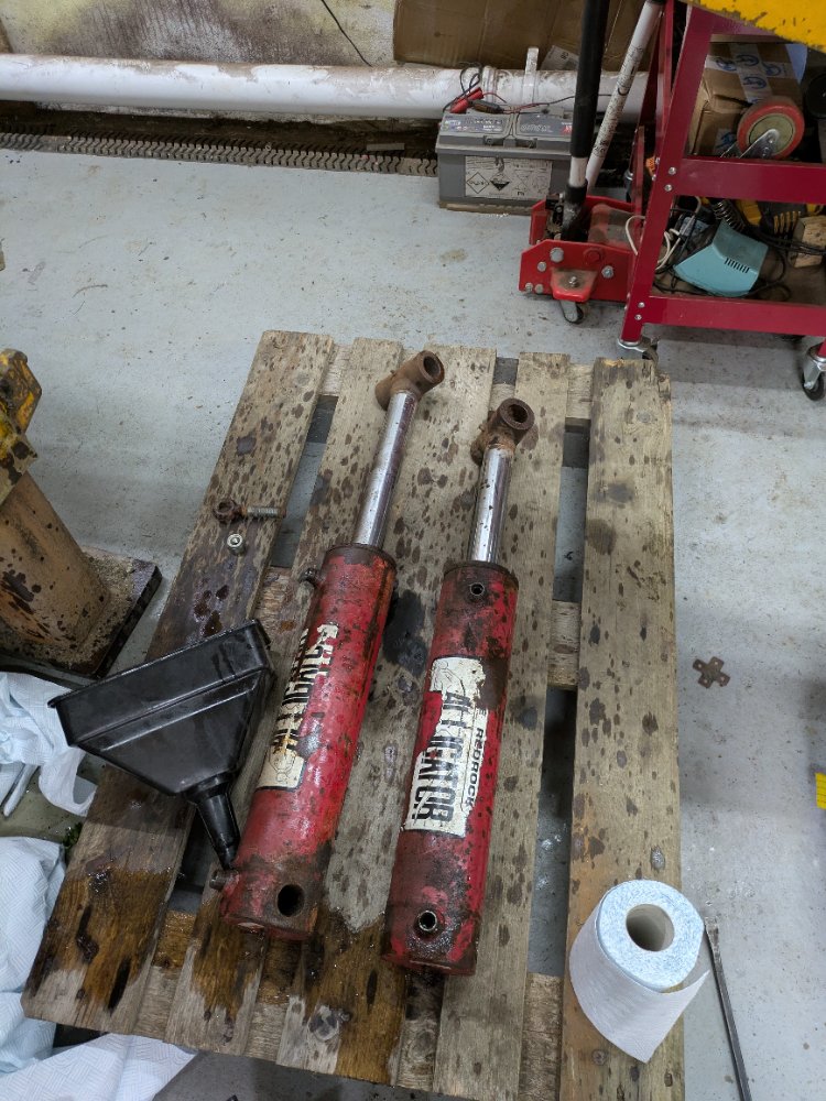

So im bored and have nothing i can do except think about what tools I want.
I want a press, but now having the forge (and also having designed a coke forge for welding heat) i want a press like a blacksmith would use...the type that is quick to operate both up and down, likely operated by a foot pedal.
Am I right in thinking this is just a double acting hydraulic pump with a decent sized reservoir, and a cylinder ported for both directions?
Am I also right in thinking the speed of the ram is determined by the flow rate of the pump, and the force applied by the press is related to the surface area of the piston in the cylinder and the pressure available from the pump?
I'm never going to have a power hammer, but good quick press will come in handy
