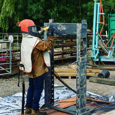

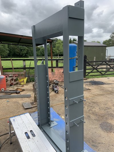

That's what I'm going for. Hopefully then when I find a 50 ton press this will be easy to move onPicked the right day for wearing all of that spaceman outfit. Going to be better than new - top job.

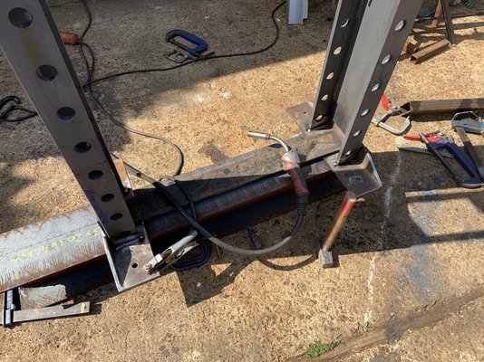

That's a right old lump that one. See you can straighten bars in yours because the sides are open, on mine only a small gap at the very top is open. I should of plasma cut some holes in the 3mm sheet at the sides that corresponded with the table heights plus a set of v blocks or something:Looks very familiar - mine was badly fire damaged when I got it

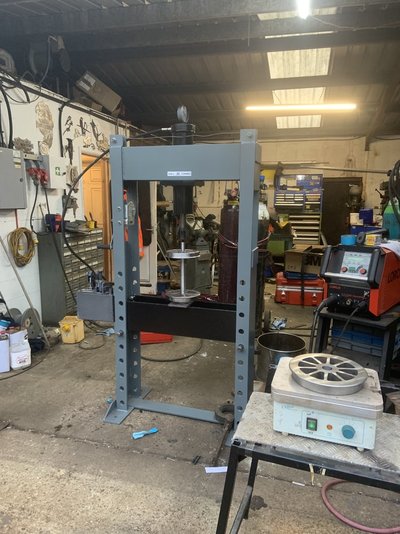

EPCO, nice stuff. I bet like their jacks and cranes, that is probably well over-engineered.It's a 60 ton EPCO Brad. The fire was so intense it melted the platen raising motor and hydraulic pump and motor. The cylinder as you can imagine was really badly cooked and took me ages to dismantle and re-build. The platen raises and lowers on four lead screws with sprockets and chain above, the whole lot resting on massive springs arranged so when the press squashes they compress and take the load off the lead screw thrust bearings, but the fire de-tempered the springs. I had to have some custom made from 6mm spring wire (rod!)
Re-build thread here: https://www.madmodder.net/index.php/topic,11437.msg133941.html#msg133941
Thoroughly enjoyed reading through that. I;m also on the lookout for a hydraulic pump of the right type.It's a 60 ton EPCO Brad. The fire was so intense it melted the platen raising motor and hydraulic pump and motor. The cylinder as you can imagine was really badly cooked and took me ages to dismantle and re-build. The platen raises and lowers on four lead screws with sprockets and chain above, the whole lot resting on massive springs arranged so when the press squashes they compress and take the load off the lead screw thrust bearings, but the fire de-tempered the springs. I had to have some custom made from 6mm spring wire (rod!)

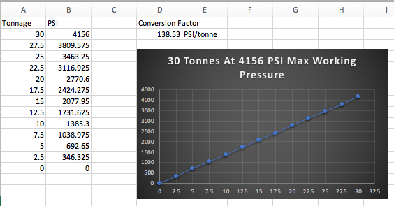

There is no rush, I was going to get a sticker printed, but whatever way i envisioned it, it would just look rubbish. I was tempted to have a brass plate done.I'm sure I can sort something out for you Brad. Let me have a few details such as over all size and the chart itself as a DXF file. It wont happen immediately as being school holidays we've grandchildren staying an my time isn't my own![]()

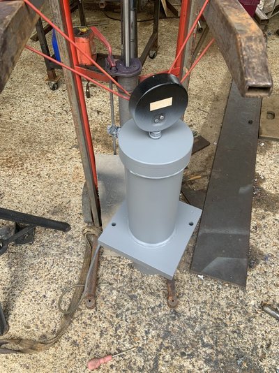

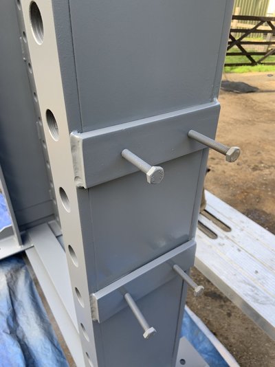

Well something odd is occurring with the press.
I pumped the ram all the way down yesterday to see how square it is to the table. When it reached the bottom (I assume) if it's travel, a big old squirt of hydraulic oil came out of the fitting on the side of the ram. This fitting had a tube that returned to the tank, but I need to put some new hose on it.
Now every time you pump the ram down you get a slight dribble from this fitting in the side of the ram. It wasn't doing it the other day when we was pressing @Milkybars wheels, so I've obviously damaged a seal taking it to the end of its stroke,
any ideas?
