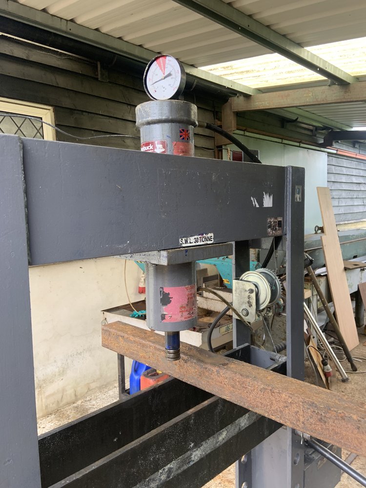

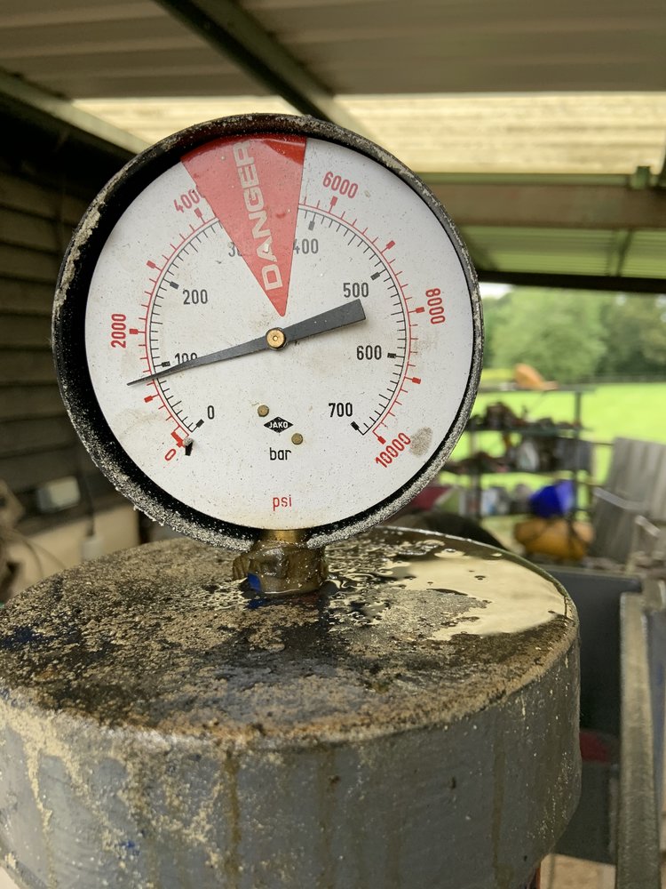

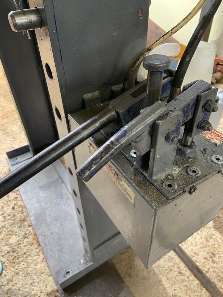

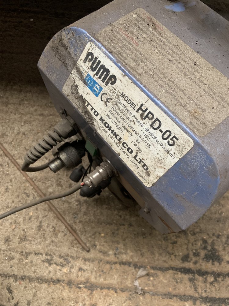

Actually just looking at it the pump is probably for a double acting cylinder and the ram on your press looks to be single acting spring return? In which case you would need a valve to change between extending and retracting. Most likely it is just an O-Ring in the manual pump.Reservoir on pump is 4l, a quick measure of the manual pump tank would give a rough idea of capacity. A pressure relief valve on the outlet of the pump could be set to 4000psi and the blow off to the return line. Would only need a couple hydraulic t's and a relief valve.

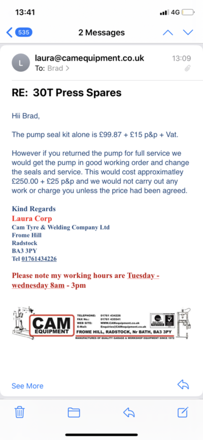

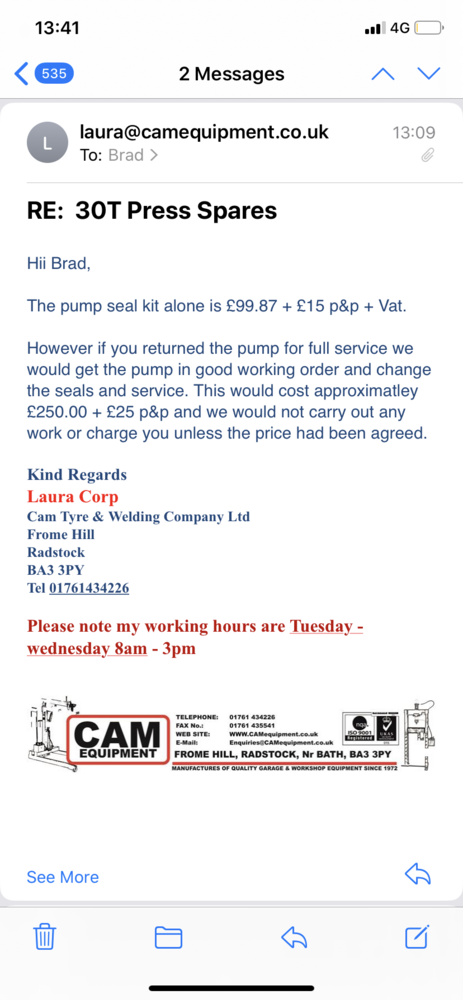

Think i would just pay them to do it at that price, bargain.
I would be tempted to strip the faulty hand pump, chances are it uses standard seals available for a few quid, not much to lose in trying as can send it to manufacturer to refurb or buy their seals as a backup. Though I am Scot....deep pockets and short arms
How much are you worth per hour? I couldn't justify the time.No way I'm paying £250 to have a pump serviced.
About £2.50 most daysHow much are you worth per hour? I couldn't justify the time.
