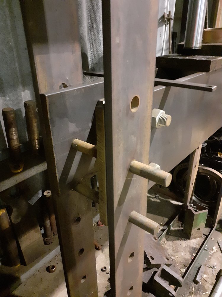

So I make that about 14 tons per pin for 3/4". So 56 tons for 4....plenty of margin there for a 20 ton press.As a guide,black mild steel bar is 28 imperial tons/square inch.

Maybe you're right.Understood but if you are going to MODIFY a channel section, that looks like the worst case scenario. Look at where the forces you’re trying to resist are going to end up. Pivoting along a weld join….
I picked up a fairly big air over hydraulic cylinder a couple of weeks ago for only €10 with the plan to see if I can plumb that into the jack.Mine will be a bit beefier around the top, maybe narrower. I have an air over hydraulic 20t jack that I'm going to modify to work upside down, so I can eliminate the moving parts of the guide you have. That's if I can find a 75mm spanner to get the nut off. I may have to mill one out of some plate or maybe weld one together.
Maybe you're right.
I just copied something I saw on some presses on the Internet. When I build it I didn't put that bracing in the horizontal channel.
Later I decided it might be a good idea to strengthen them a bit because it's only 80mm channel and 1m long.
My thought by this form of bracing was that it transferred some of the forces on the thinnest outer edge of the top flange to the thick part of the bottom flange. Don't know if that's true. Anyway the channel is definitely stiffer with this bracing in.If you give it some thought, it will be fine whichever way you decide. My take on that style of bracing is that you just need to be sure you know why you're doing it. I don't think it necessarily automatically makes things better. Plus of course, people often want to stick a pin right through the web of the channel, so even a few uprights "boxing" it in in a just few places might be preferable.
I think the angled bracing is the right way to do it, transferring any loads on the outer edge at the top to the inside 90 on the bottom
with two pieces back to back and welded together at the ends it'll take a hell of a lot of bend/twist them - it should resist bending/twisting better than if it was braced in as box section?
also you're keeping the load in towards the center of the press, which is better at the pin end, more shear force vs bending
If you imagine putting box section in a vice corner to corner and then the same but with a triangle piece.... The box section is much easier to distort/squash than the triangle
I think it's all a bit if a mute point because whatever people do will be many times stronger than needed... But it's good to think about it and not just copy existing designs
