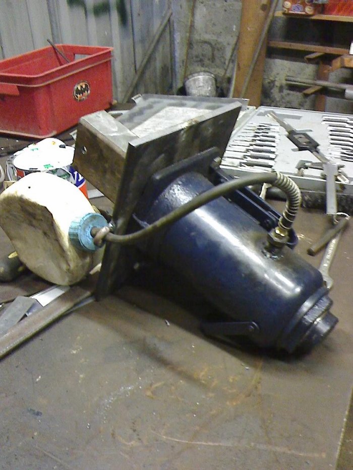

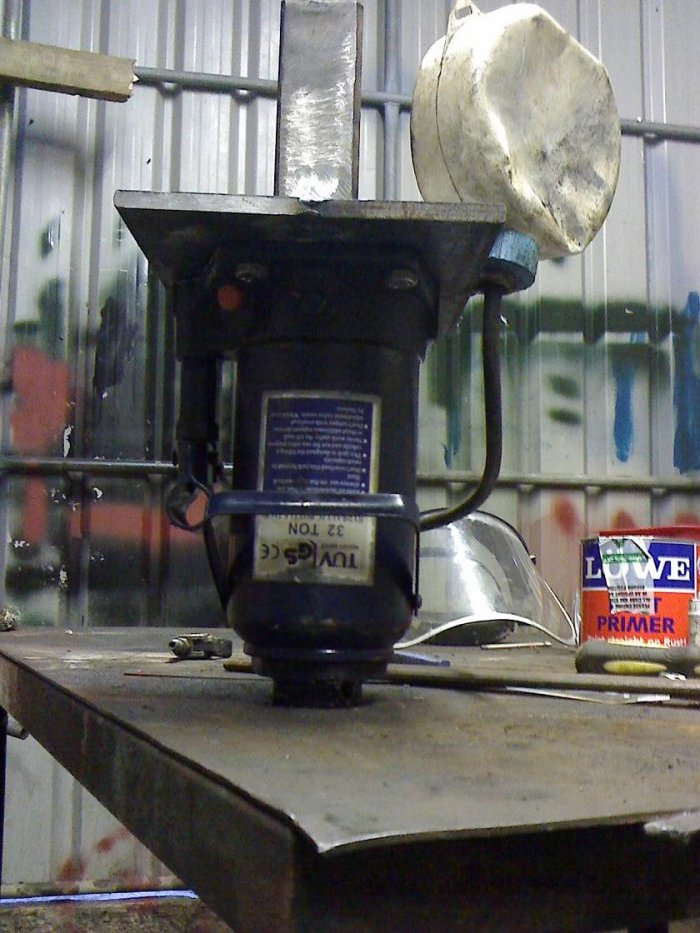

I get it at last if you could find a 30t Jack that wasn't working it's usually the pump that goes just drill through the base tap it and connect your pump to it could be the cheapest way to get a 30t ram if you managed to get one of the plant machine not sure but I think you can cut them to whatever lent you want
