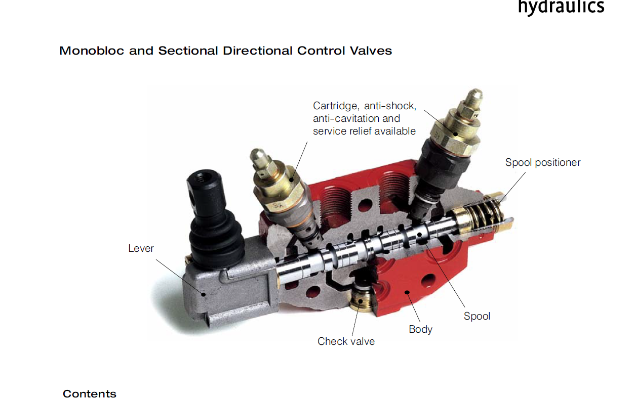

I see there are a few knowledgeable people on here by Chismac's recent post, so what is the most likely place to be looking for the fault ? There are NO external leaks, so should I be looking at the ram itself, or the hydraulic block ?
The hydraulic block has two spare services, only four of the six are used, so could I swap the pipes over to one of these, or is it likely that the characteristics would be vastly different ? The block is one piece, and not a sandwich of slices
