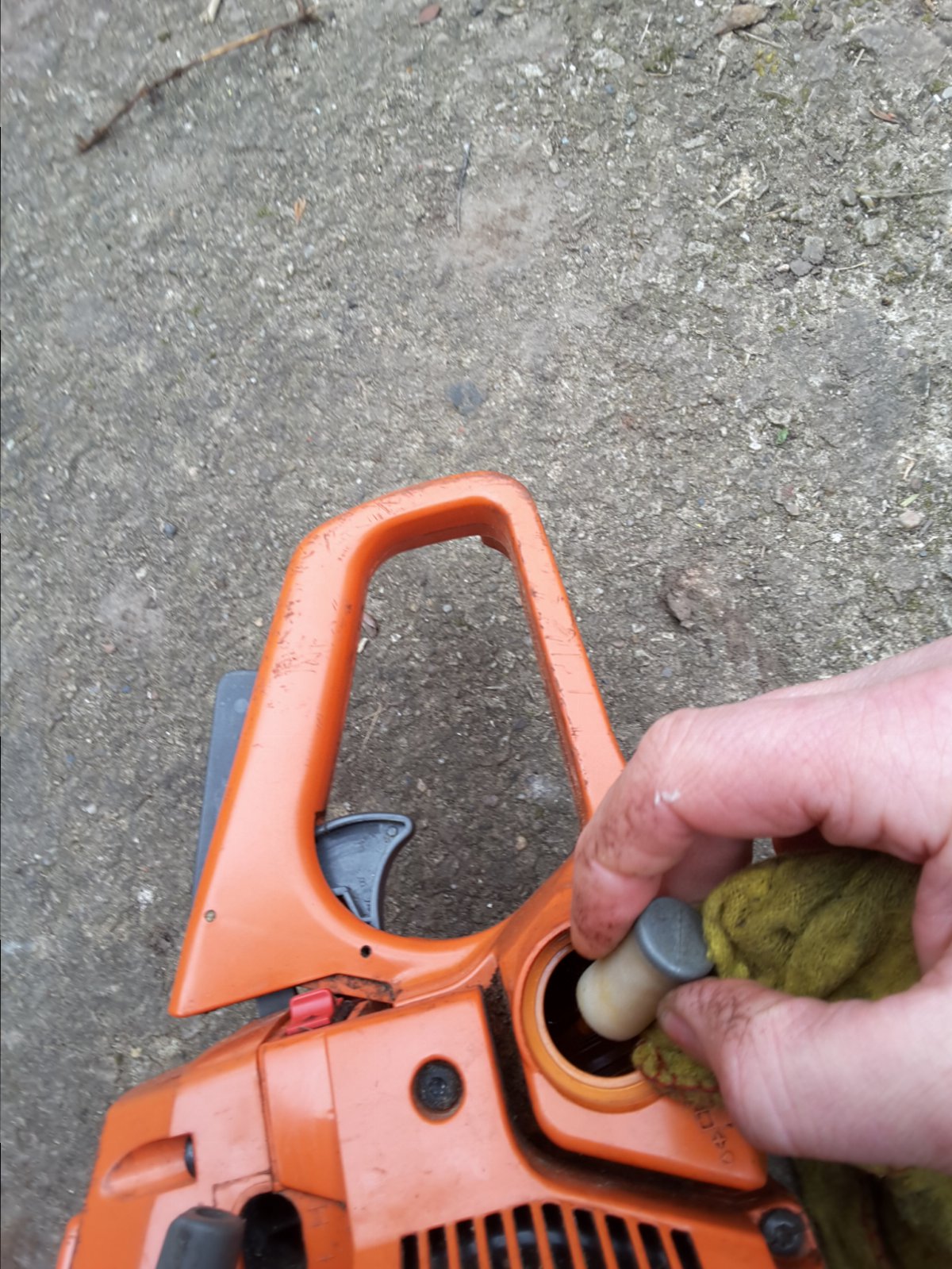

thats the filter remove it and blow through it
