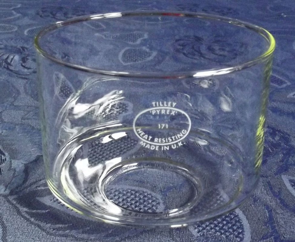

Technically, that's not a gas lens, it's a cup or nozzleCall that a Pyrex gas lens ?
THIS is a Pyrex gas lens.
And only a tenner on eBay

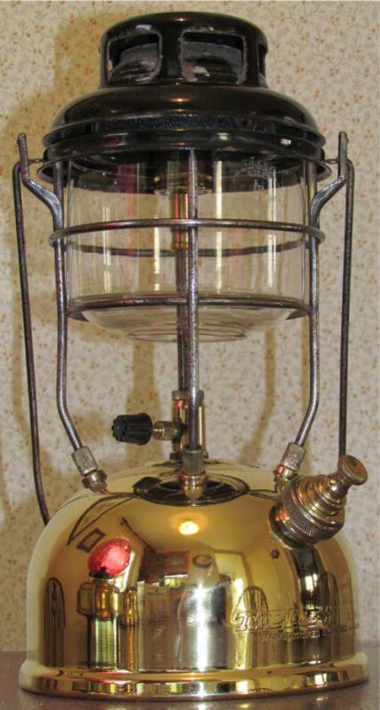

Years ago when I had a proper job I used to use these, admittedly the ones made by Camping Gaz,
for welding titanium tafts on the ends of tubes. The TIG torch was fitted with a large rubber grommet
that also fitted the hole in the lantern shade, sorry, I mean gas lens.
About a 100mm tungsten extension and weld away in your own little argon chamber.
I bet you don't learn that now in your C & G.

)Well, I've never heard of a Tilley lamp but we've got a couple of gas lamps for the power cuts this village has an abundance ofJust looked up your profile and I conclude you are too young to recognise a Tilley Lamp (you swine)

Yeah i have a #15 knocking about somewhere ,but it finshes a couple of mm from the end of a gas lense.if you're walking the cup and your arc length gets longer than this couple of mm the current bypasses the tungsten and arcs from the lense instead.the shade of oxide is the last thing on your mind thenThere is a also a #15 cup (53n89) for the large gas lens but it's shorter and i've got a vague recollection that it's not recommended for use with HF as it doesn't 'shield' the end of the collet body
Can't see how that's expensive rapid want £63 + vat for the CK Pyrex gas lens kit and that's only one Pyrex cup not two.
