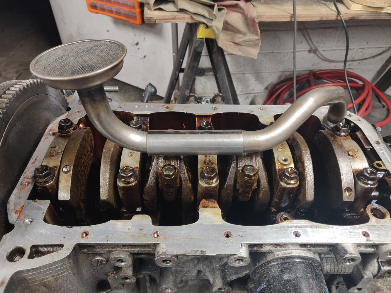

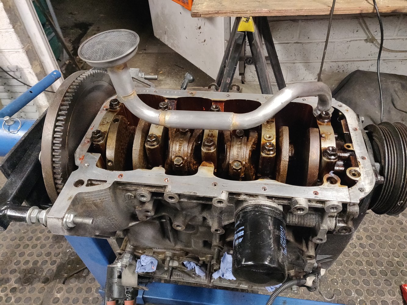

Suction will take the least resistance This means air will be introduced loosing suction GET THIS DONE PROPERLY !
sleeve and braze it even silver solder. thats all i did altering my ford oil pickup
as long as its properly cleaned and fluxed you will get a nice capillary run jointREALLY ? I WILL CALL A FOOL A FOOL TO HIS FACE.Well known for it. Not an internet thing.…evidently more years than we care to think about too, given your current internet etiquette![]()

Good point. There is a support bracket which I cut off before extending, I need to weld it back on.One point - as you have extended the pipe (by a fair amount), does it require extra support?
