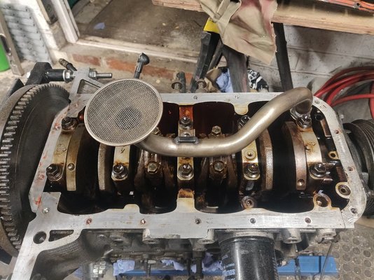

Hi everyone.
I've had to fit a different sump to my engine to make the engine fit my buggy. Now the oil pickup is in the wrong place. It just needs extending by a couple of inches.
I only have a mig welder and I'm not skilled enough to make a liquid proof weld. I can braze though, so I was thinking to swage some tube and braze it on. I don't have a swaging tool but I have a mini lath to make a mandrel and a press to push it into the tube.
Unless there's an easier way anyone would suggest?
The oil pickup tube is 22.1mm outer diameter.
