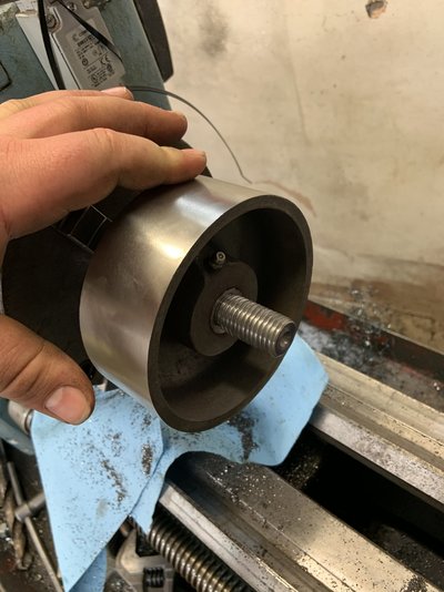

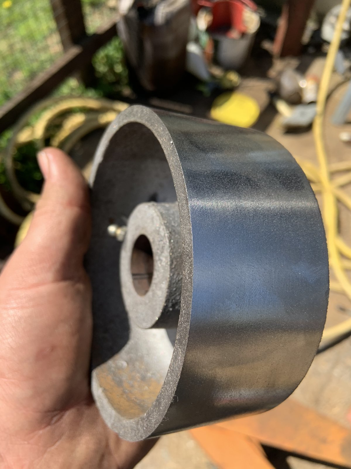

It’s well welll out of true on the inside edge unfortanatt.Probably rough casting there so not true to the hole.

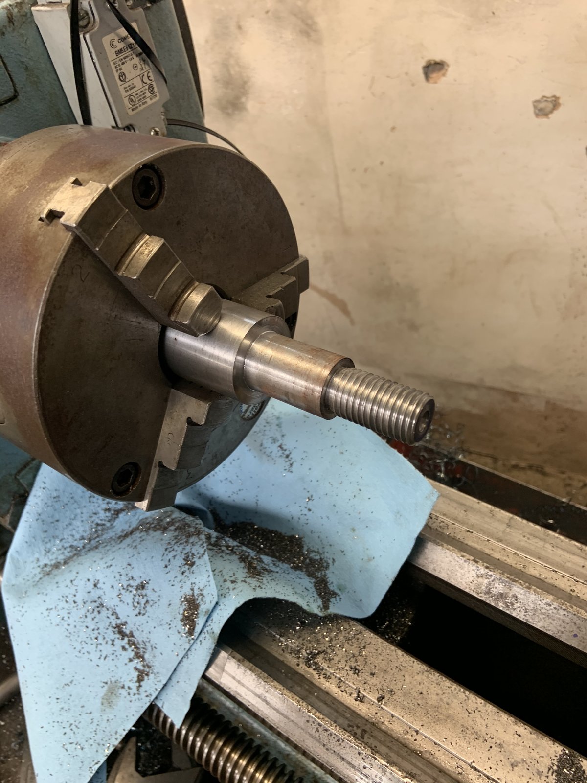

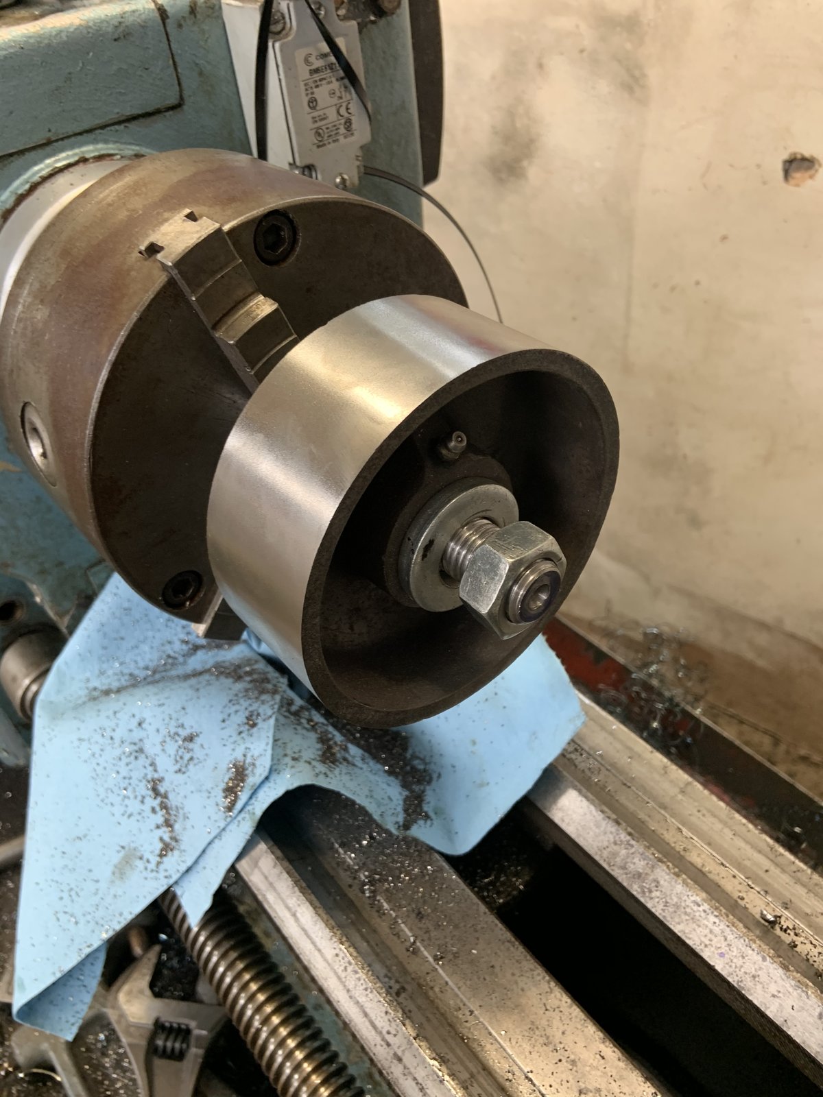

Your reply took longer to type than it would take to do the jobAs has been mentioned just turn a plug with a shoulder and chap it in and hold with the centre, much quicker than having to throw on a 4 jaw or even reversing the jaws in the 3 jaw to grip the OD.
I always have bits of delrin lying around for stuff like that but anything will do.
I know, and I can type faster than I can swap chucksYour reply took longer to type than it would take to do the job![]()
its only a jack wheel stick it in a 3 jaw or as above nut and bolt and a couple of washers a 12 mm one will hold that in a chuckI don’t have a working 4 jaw or I would have done in in two hits.
It’s from a lovely EPCO jack that you can’t get the likes of nowadays.its only a jack wheel stick it in a 3 jaw or as above nut and bolt and a couple of washers a 12 mm one will hold that in a chuck
Would of been a tonne of moneyGood practice with the threading etc and it ended up well but thank goodness I was not paying for that job![]()
