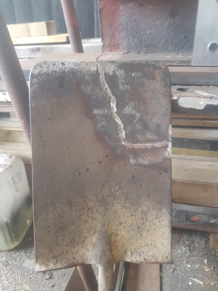

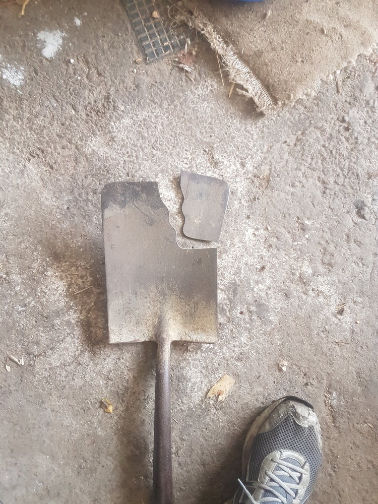

what were you doing to break it like that!

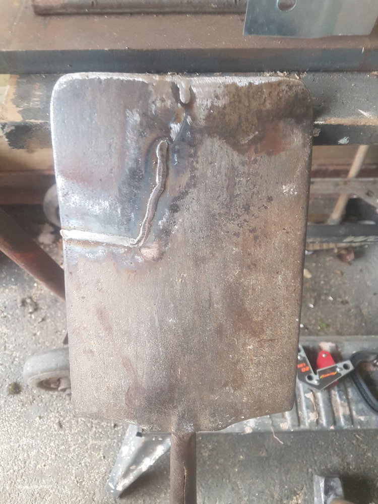

its surface rust where i have not used it in a year!i keep my old spades real clean. it stops the soil and clay sticking to them causing drag![]()
a good flexidisk over in in angle grinder will polish it up nicelyits surface rust where i have not used it in a year!

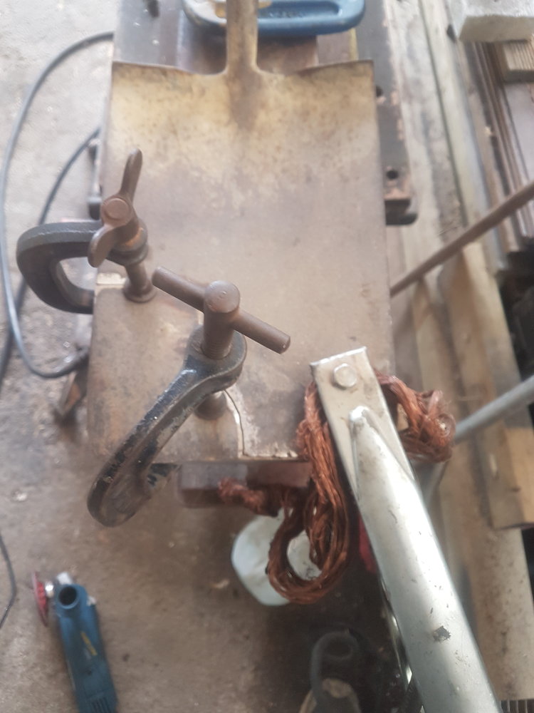

I will give it some stick at the weekend when I dig up the lawn.Hope it holds, I've repaired a few of them over the years and they always fail again if used for any serious digging, I believe they are forged, the one that lasted the longest was a spear and jackson neverbend, I stick welded it and peened the welds while it was still hot, eventually finished it off digging the footings for my garage
there a round grinding disk that goes on to a flexible backing pad on angle grinder. takes more off than a flap diskI will give it some stick at the weekend when I dig up the lawn.
whats a flexidisc, wont a flap disc do
never seen thosethere a round grinding disk that goes on to a flexible backing pad on angle grinder. takes more off than a flap disk
